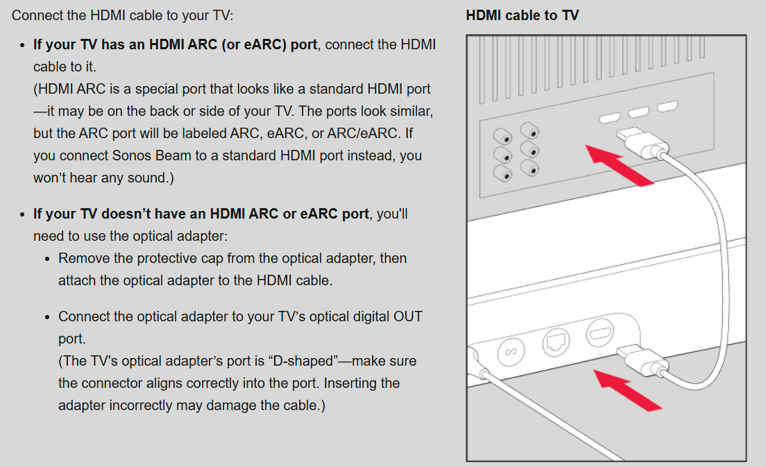

Guest Posted December 25, 2024 Posted December 25, 2024 Here's a discussion about this. https://answers.microsoft.com/en-us/windows/forum/all/soundbar-connected-to-pc-via-optical-cable-only/19b86b20-aa81-44af-b62b-44f4a70ae49b Yes, he's trying to use optical, which I believe is the issue here. The 'splitter' has an optical port that must be sending a signal back down the HDMI, notifying the OS. Once Widows gets that, it behaves as though you've connected an optical cable to the output sound device. Windows knowing that it only supports 2 channel uncompressed audio, limits the options to two channels. With regard to the SONOS soundbar, it appears that it also supports ARC. So if you forget about object based audio (Atmos etc), and reconfigure, you my have better luck. https://www.sonos.com/en-us/guides/beam Additional information on spdif/optical https://learn.microsoft.com/en-us/windows-hardware/drivers/audio/s-pdif-pass-through-transmission-of-non-pcm-streams I would follow Softworx' suggestion, and try connecting to other devices. I would try the ARC connection first, and not use the 'splitter'.
