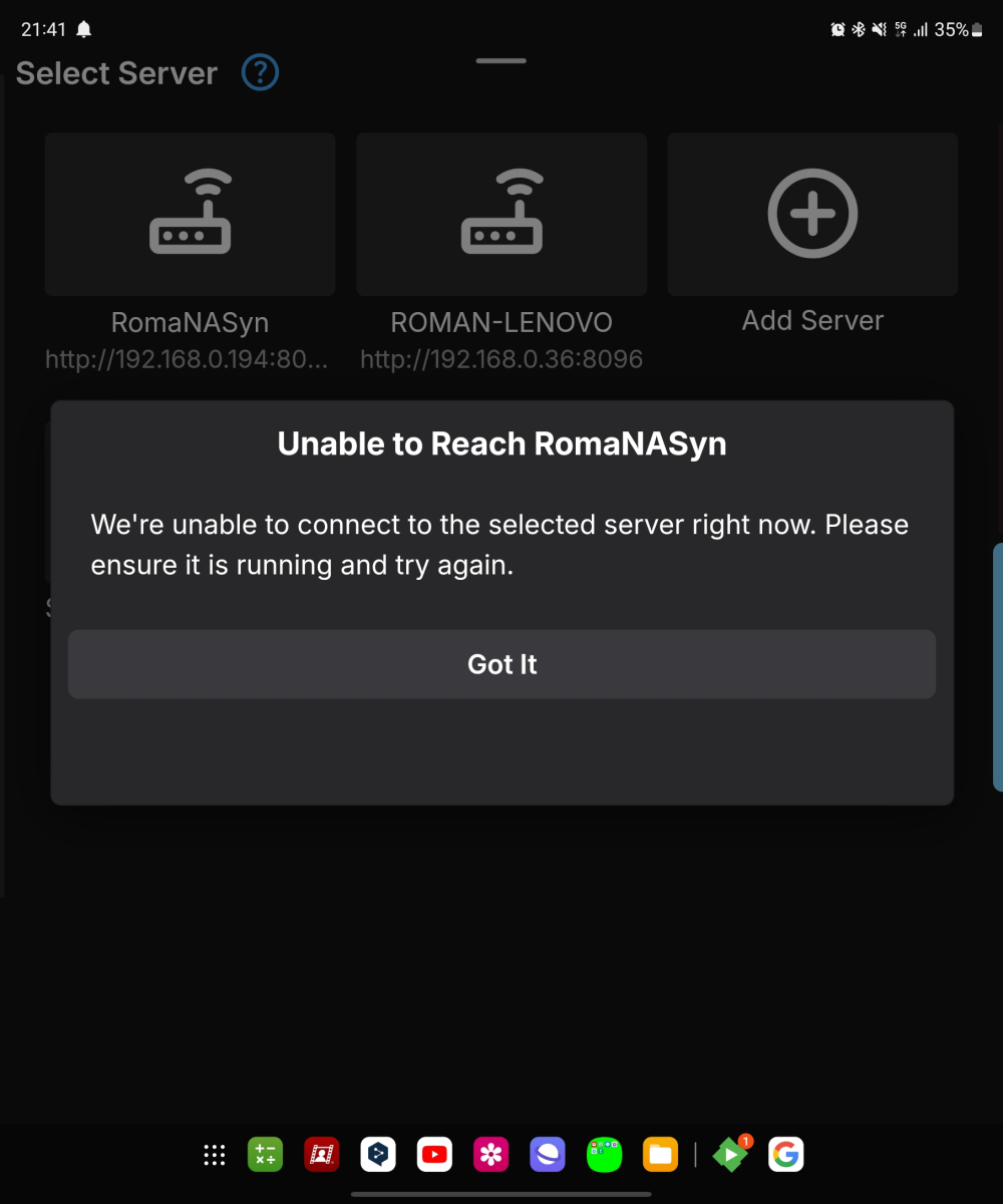

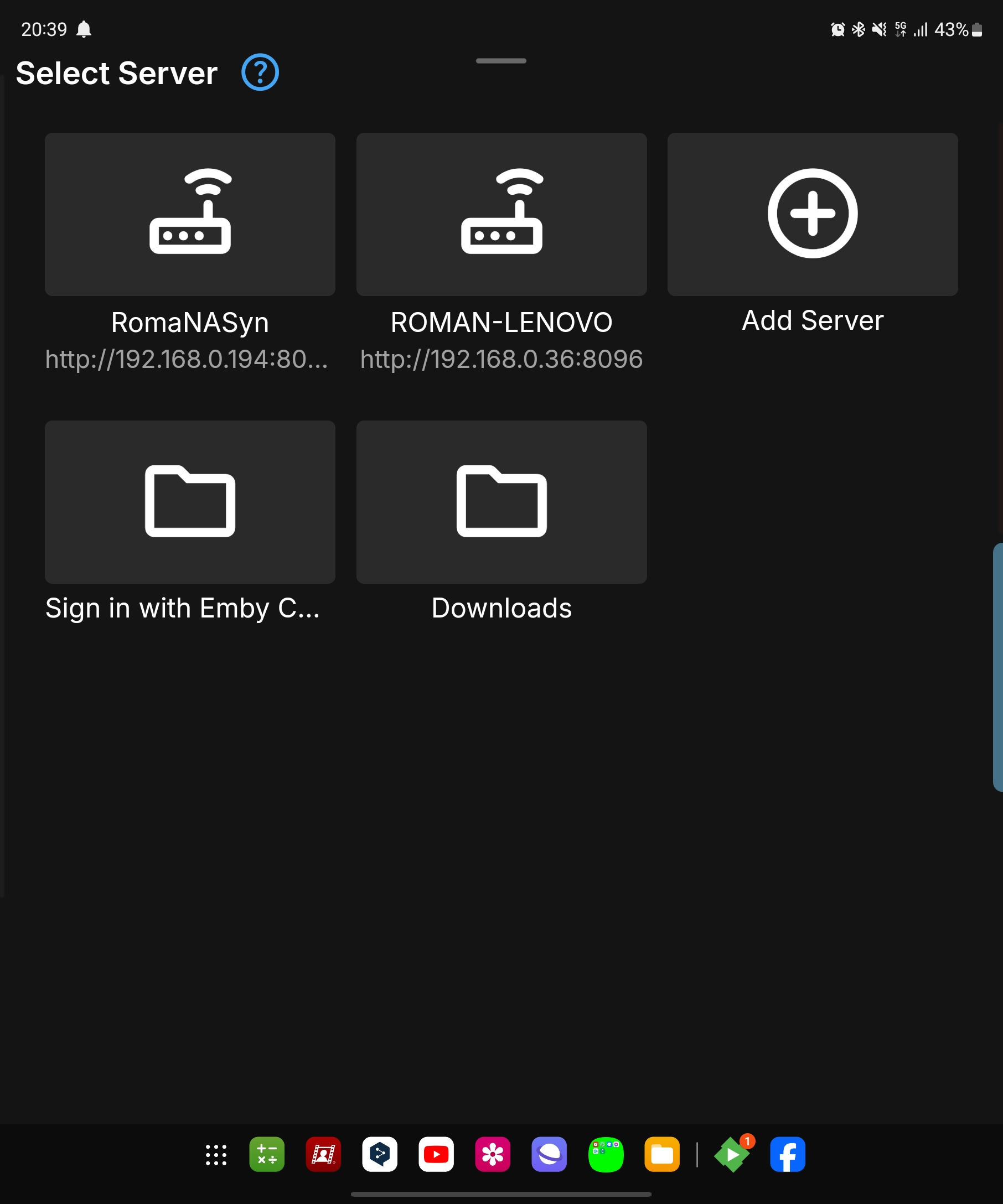

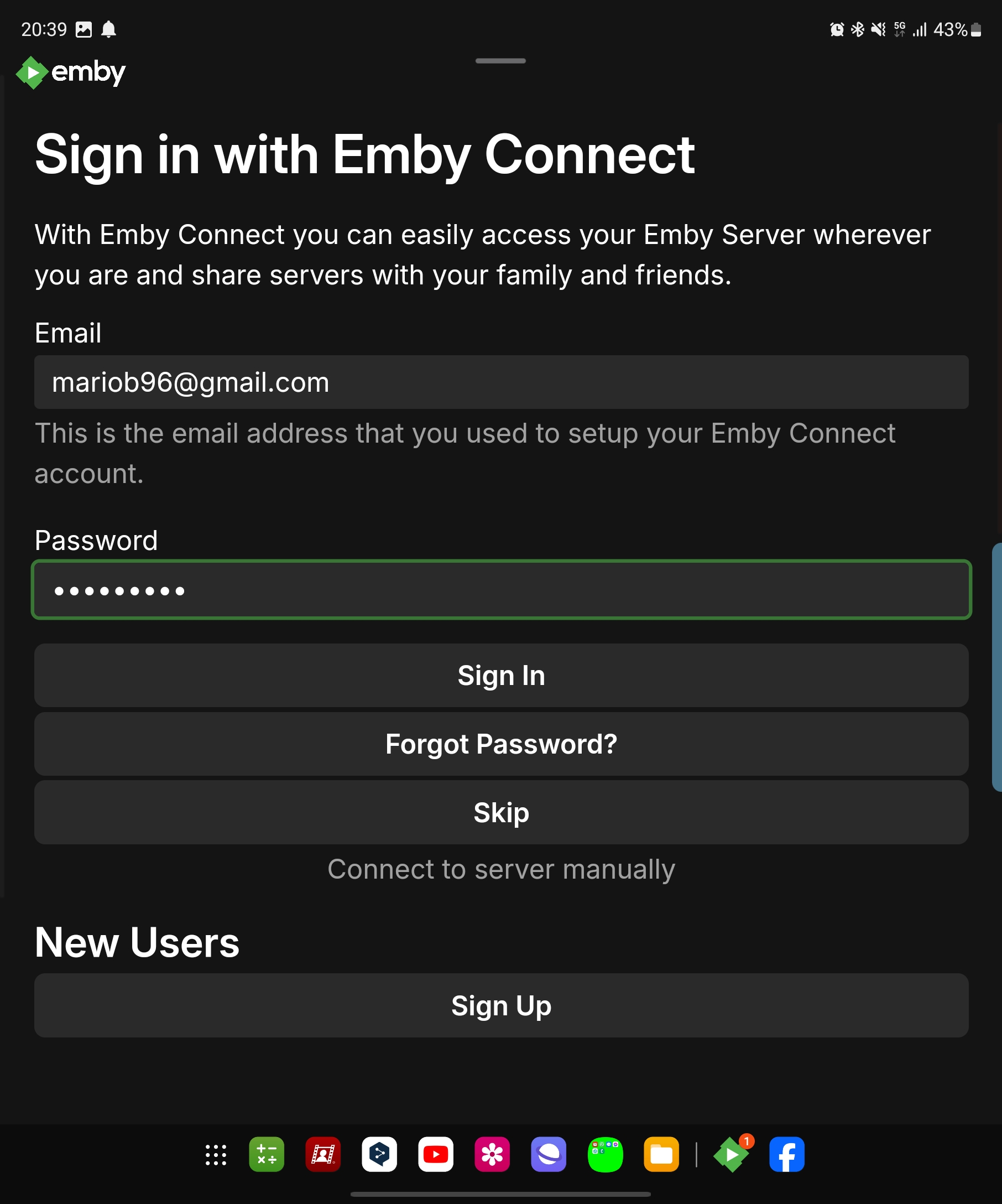

Mariob96 6 Posted December 4, 2024 Author Posted December 4, 2024 Hi. The home page appears, I enter my email and password via emby connection, log in and it takes me back to the home screen.
Mariob96 6 Posted December 4, 2024 Author Posted December 4, 2024 Yes, the Synology server is working fine, I can only access it via my home network.

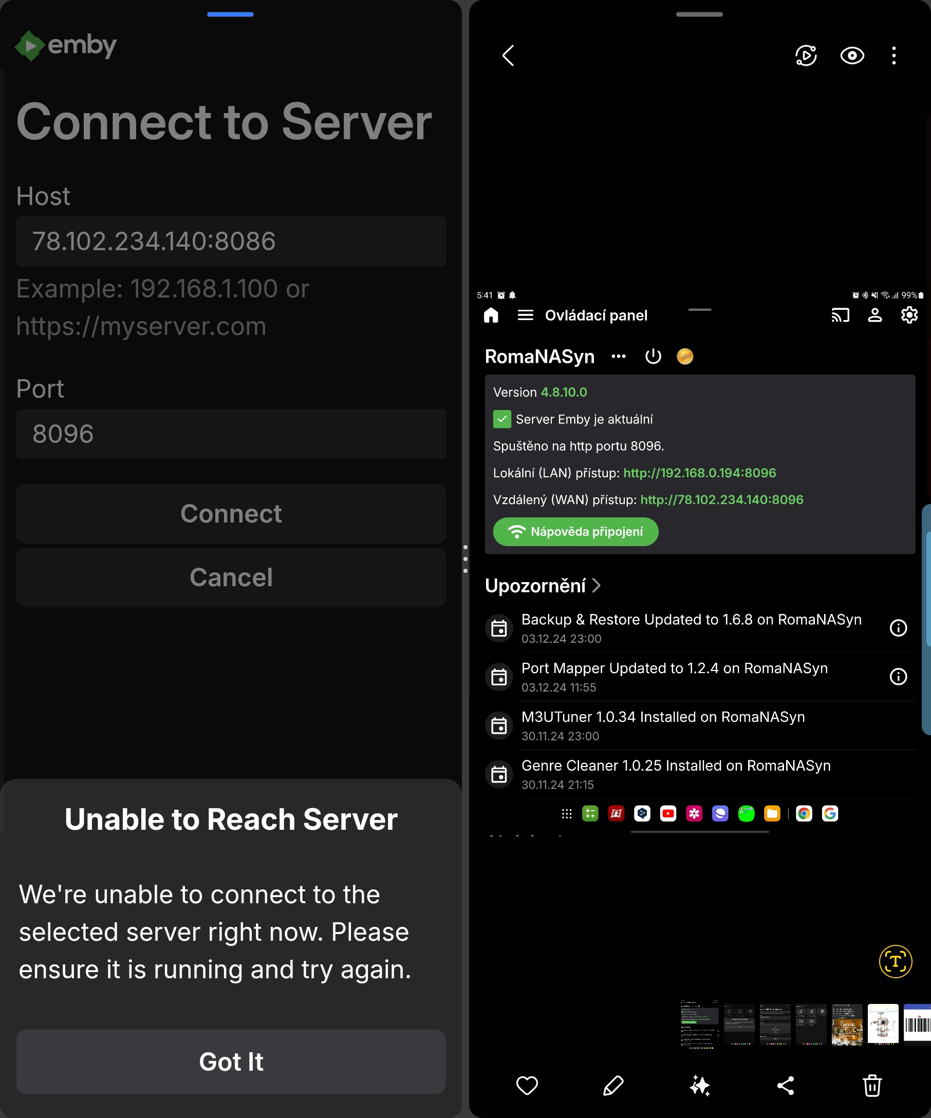

Mariob96 6 Posted December 5, 2024 Author Posted December 5, 2024 I don't know what's wrong with the input, but it doesn't work

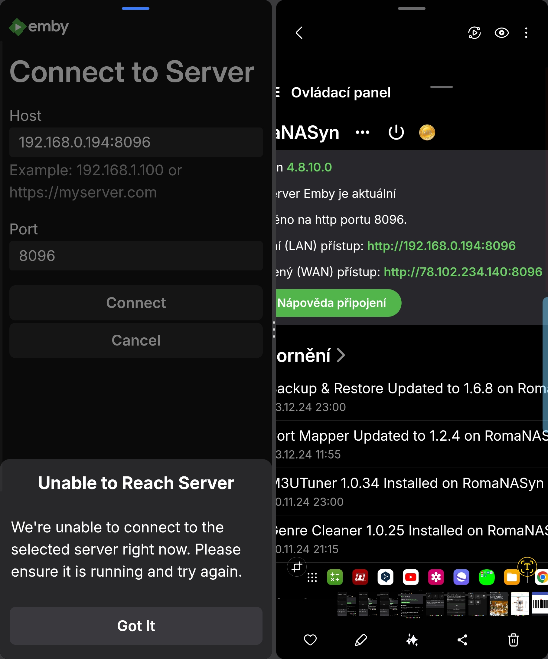

sa2000 697 Posted December 5, 2024 Posted December 5, 2024 6 hours ago, Mariob96 said: No, I'll try after work. I just don't understand why it's so complicated. I'll let you know how it turns out Why were you entering public port 8086 in the host on Add Server Anyway - on Add Server, the host is just the IP address and the port is entered on the next line in the port field So it would be Host - enter your 78.102.xx.xx public IP Address Port - enter 8096 If you have automatic port mapping enabled then Emby Server would setup the mapping of public port 8096 to your local IP Address 192.168.0.194 Of course if you have more than one Emby Server on the local network then this will not work as the first server to be setup will take the default 8096 port for the mapping and it will no longer be available for the 2nd server. In such case, you need to setup individual port mappings in the router with different public port for each server and in EMby Settings disable auto mapping and specify the public ports you selected for each server in the port forwards on the router

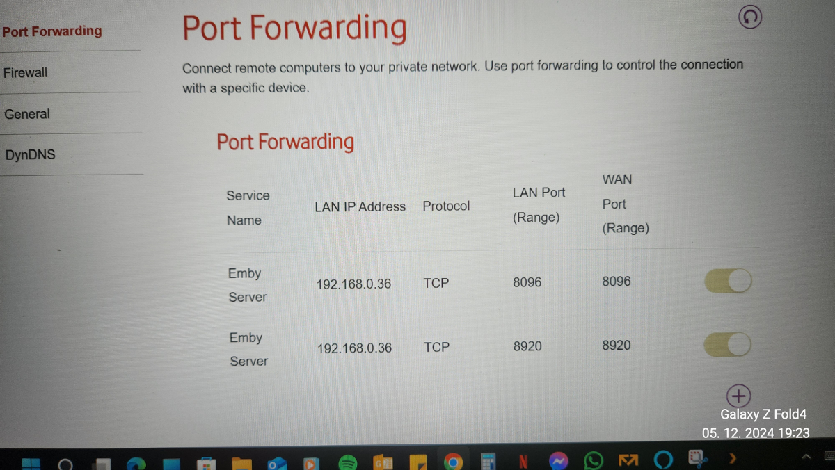

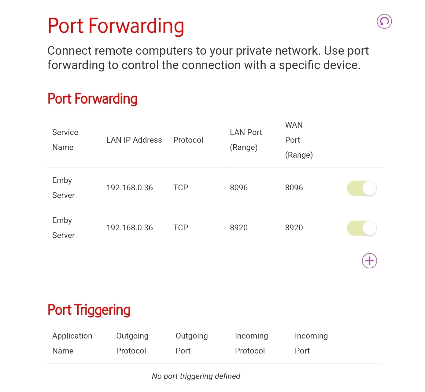

Mariob96 6 Posted December 5, 2024 Author Posted December 5, 2024 I have this on my router, see the picture. I don't understand it anymore, it's complicated for me and I'm afraid I'll mess something up on my router.

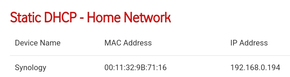

sa2000 697 Posted December 5, 2024 Posted December 5, 2024 (edited) That is the ROMAN-Lenovo PC on 192.168.0.36 and appears to be a manual port forward for 8096 for http and 8920 for https So for the Synology to be accessed remotely - you need to use different ports and either automatic port mapping or manually setup forwards eg 192.168.0.194 TCP local port 8096 remote port 8097 192.168.0.194 TCP local port 8920 remote port 8921 as examples so you would use wan ports 8097 and 8921 for the NAS and 8096 and 8920 for the lenovo make sure both IP addresses are static / DHCP Reserved Edited December 5, 2024 by sa2000

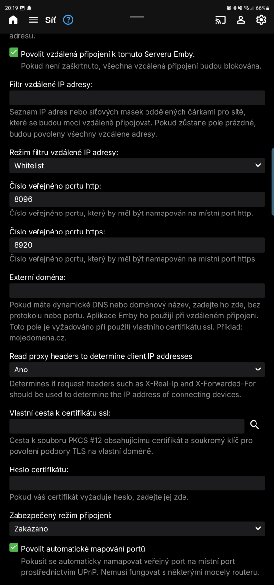

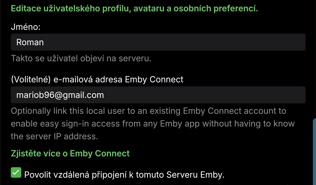

sa2000 697 Posted December 5, 2024 Posted December 5, 2024 (edited) 7 minutes ago, Mariob96 said: I removed the Lenovo PC server and turned on automatic port mapping sorry - what does that mean exactly Can you please look into the whole setup - In the router - what DHCP Reservations do you have for the Synology and Lenovo - In the router - what port forwarding do you have manually setup for the Synology and Lenovo - In Emby Server for the Lenovo what do you have in Server Settings for the WAN / Remote HTTP and HTTPS ports and do you have port mapping automatic or manual ? If you have manually created the port forwards in the router then automatic mapping in Emby Server settings need to be disabled and is the admin user linked to the Emby Connect account? - In Emby Server for the Synology what do you have in Server Settings for the WAN / Remote HTTP and HTTPS ports and do you have port mapping automatic or manual ? If you have manually created the port forwards in the router then automatic mapping in Emby Server settings need to be disabled and is the admin user linked to the Emby Connect account? And if you change the settings restart each server - safer option Edited December 5, 2024 by sa2000
Mariob96 6 Posted December 5, 2024 Author Posted December 5, 2024 V routeru jsem nic nenastavoval, DHCP tam bylo automaticky. Nevím kde a jak nastavit rezervaci, ale není potřeba Lenovo, stačí mi Synology server. Přesměrování portů mám nahrazeno automaticky. Uživatel admin je propojen s účtem Emby. V routeru jsem nic ručně nenastavoval. Restartoval jsem server. Níže přikládám aktuální screenshoty.
sa2000 697 Posted December 5, 2024 Posted December 5, 2024 The router still knows about the Lenovo You have 2 options 1. Assuming the lenovo will never launch Emby Server again - you could just reboot the router check that Port Forward to 192.168.0.36 has disappeared and if it has then you could just run the Synology with default ports and automatic port mapping enabled 2. A safer option - change the port numbers to use for the Synology. For example - have 8097 for remote / wan port for http and 8921 for remote / wan port for https and have automatic port mapping enabled. Keep local ports as they are 8096 and 8920 in Emby Server settings. The server should then be reachable through http on the WAN IP Address and port 8097. restart the server a few minutes after saving the changes
Mariob96 6 Posted December 5, 2024 Author Posted December 5, 2024 Great, it works now. Thank you very much for your help and patience. Have a nice day. 2
