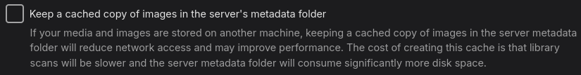

Solution Lessaj 484 Posted December 3, 2024 Solution Posted December 3, 2024 Have you explored this option for your libraries? 1
terse 1 Posted December 4, 2024 Author Posted December 4, 2024 9 hours ago, Lessaj said: Have you explored this option for your libraries? I've turned this option on for that, and now the process for emby is: I upload the nfo and poster to my cloud drive account - emby downloads the nfo and poster from my cloud drive - then caches it to the server's metadata folder - emby recognizes it for use My desired process (hopefully added to the options): I upload the nfo and poster directly to the server's metadata folder -- emby recognizes it for use
terse 1 Posted December 11, 2024 Author Posted December 11, 2024 6 hours ago, Luke said: @tersehas this helped? Didn't solve my problem, I had the option to keep a cached copy turned on in my settings before I initiated the problem. My desired process (hopefully added to the options): I upload the nfo and poster directly to the server's metadata folder -- emby recognizes it for use
Luke 42243 Posted December 11, 2024 Posted December 11, 2024 OK that is currently not supported. Nfo files are only supported in media folders, at this time at least.
