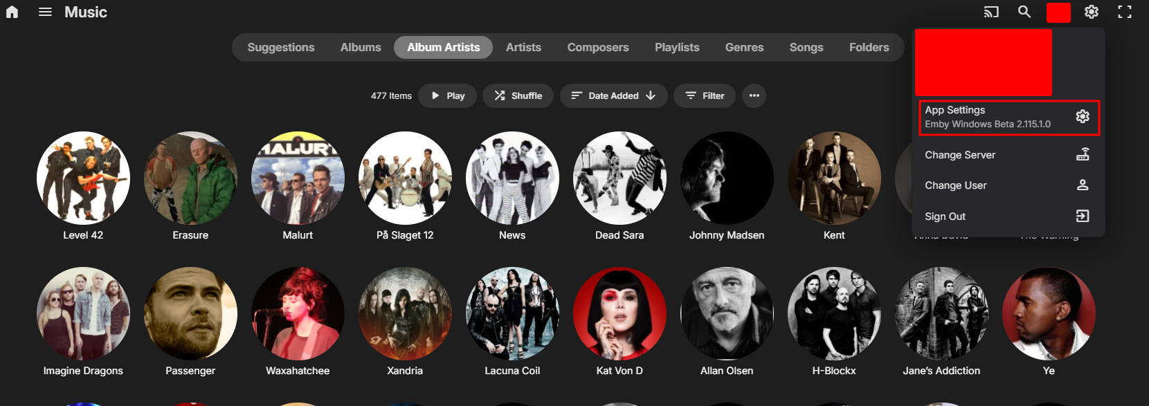

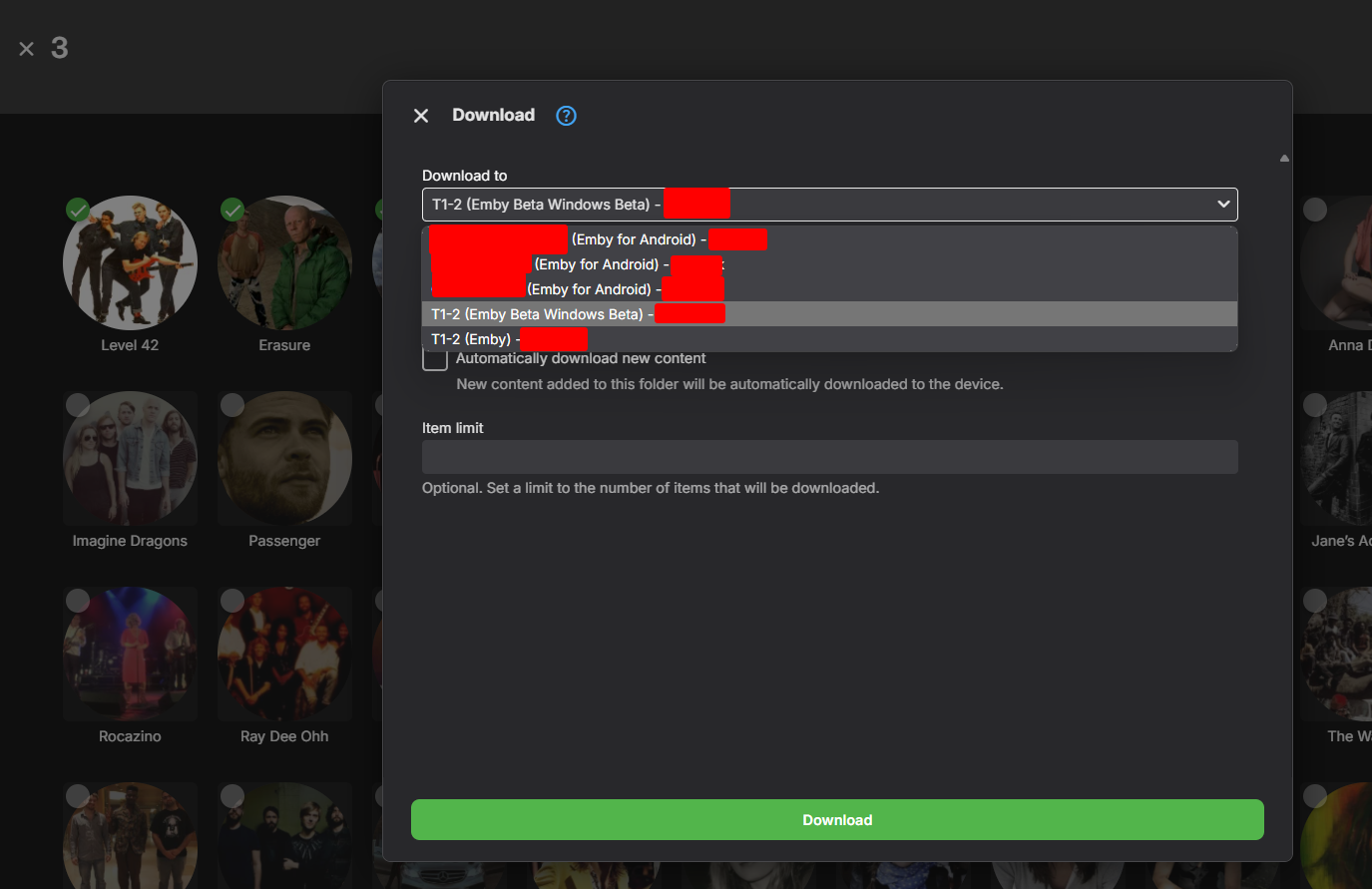

Neminem 1630 Posted December 2, 2024 Posted December 2, 2024 I using the new beta atm. I guess its works on beta app. 1
rbjtech 5345 Posted December 2, 2024 Posted December 2, 2024 (edited) 8 minutes ago, Neminem said: I using the new beta atm. I guess its works on beta app. ah-ha - so the new app has 'Download'. I'll load it later and check it out .. thanks ! edit - beta is invite only - but it may be being released this week anyway ... https://emby.media/community/index.php?/topic/131876-windows-xbox-app-beta/page/9/#findComment-1403926 Edited December 2, 2024 by rbjtech 2

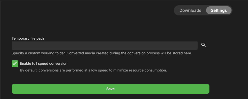

_amg29 2 Posted December 2, 2024 Author Posted December 2, 2024 C:\Users\<UserName>\AppData\Local\Packages\EmbyMedia.EmbyTheater_svmepx4c03f7m\LocalState\Photos Ok nvm I found it there finally. Is there a way to change this location to just be like the PC's download folder? I'm guessing it has something to do with this setting maybe in Downloads for my server?

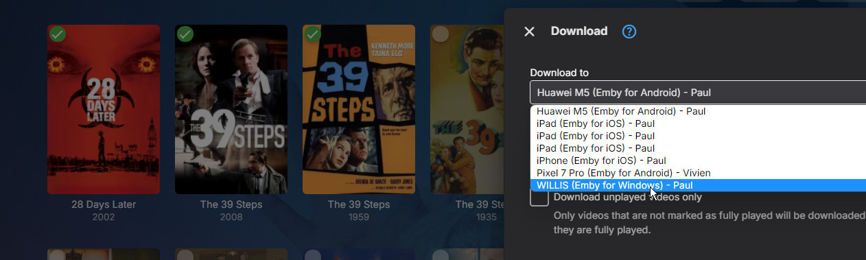

pwhodges 2039 Posted December 2, 2024 Posted December 2, 2024 I'm using Theatre for Desktop 3.0.21, and I can select multiple movies and when I go to download I can select the Windows client. However, I don't seem to be able to download episodes the same way (there's no Download option offered at all - maybe that's expected??). Paul
rbjtech 5345 Posted December 3, 2024 Posted December 3, 2024 15 hours ago, pwhodges said: I'm using Theatre for Desktop 3.0.21, and I can select multiple movies and when I go to download I can select the Windows client. However, I don't seem to be able to download episodes the same way (there's no Download option offered at all - maybe that's expected??). Paul I think the point being if you are already on the Client, then you just want to 'Download'. When selecting multiple items, this is what's missing but I believe the 'new' Emby Theater has addressed this (I think it uses the 'Universal' framework).
pwhodges 2039 Posted December 3, 2024 Posted December 3, 2024 The OP specifically says that downloading to a PC might be typical, and that on their phone the Download To dropdown didn't include all the other clients. In my testing, the DownLoad To dropdown includes all my clients (except Roku, understandably) - Android, iOS, Windows (Theatre, not Web client) - when invoked from any of those clients, or the web client. So the question I see is why is this not happening for the OP. Paul

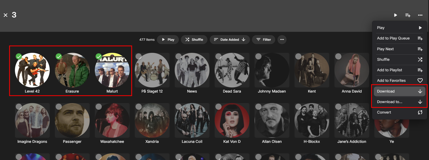

djdevon3 8 Posted January 5 Posted January 5 (edited) This is an older topic but is the first to come up in an internet search. Was having the same issue. I was hesitant to click Download because I didn't want it going straight to some device as default. However, after getting up some courage and selecting it I found out that Download will popup a normal file save window (Emby on PC). Download To is directed at downloading to registered mobile devices. As of Jan 2026 it's working properly, you simply have to use Download... not Download To.. I think the wording should be changed to Save to File and Download To instead. That wording would be clear that both options do entirely different things, in my opinion. Edited January 5 by djdevon3 1
