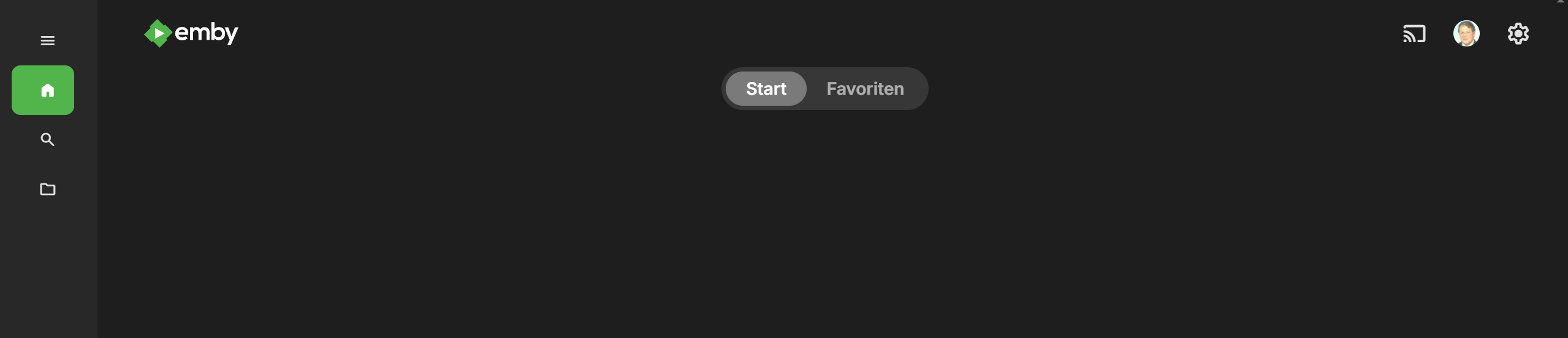

GHA777 2 Posted December 1, 2024 Posted December 1, 2024 The libraries no longer appear in display. They were visible after installation. After I created more libraries, it was no longer displayed. Then I deleted the libraries again. Currently, no libraries are visible or accessible. The library is in the "Library" folder, but it is not displayed under View/Start and under Library Order. I have already tried to rebuild the databases using "Vacuumize" - no success. System: DS224+ DSM Version: DSM 7.2.2-72806 Update 2

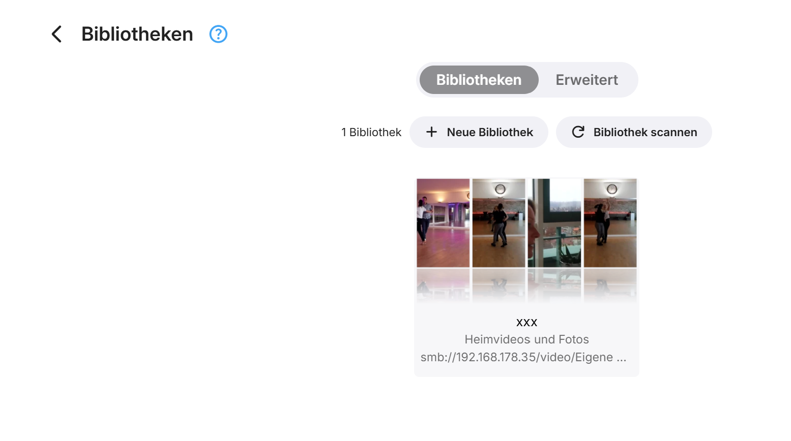

Happy2Play 9811 Posted December 1, 2024 Posted December 1, 2024 Please go over your library setup for the libraries you have configured along with a server log after a Full library scan.

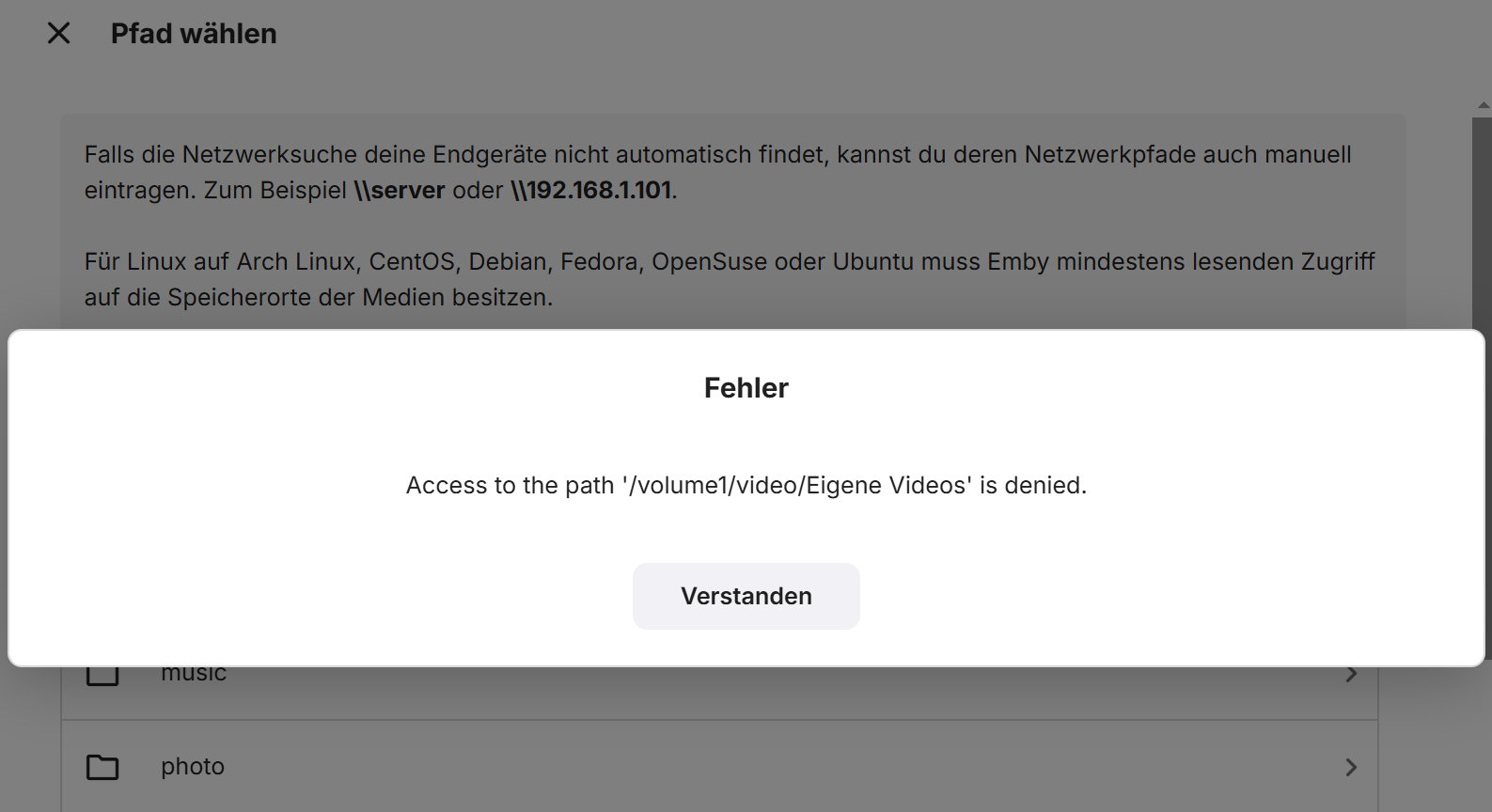

Happy2Play 9811 Posted December 1, 2024 Posted December 1, 2024 What are your configured libraries per library setup? Looks like permissions issues. System.UnauthorizedAccessException: Access to the path '/volume1/photo' is denied. failed authentication for path=smb://192.168.178.35/video/Eigene Videos 2024-12-01 20:46:12.692 Debug Server: http/1.1 Response 200 to host1. Time: 1ms. GET http://192.168.178.35:8096/emby/Environment/ParentPath?path=smb://192.168.178.35/video/Eigene Videos&X-Emby-Client=Emby Web&X-Emby-Device-Name=Chrome Windows&X-Emby-Device-Id=930b987d-9720-40fe-a87d-830ea6c9f57b&X-Emby-Client-Version=4.8.8.0&X-Emby-Token=x_secret1_x&X-Emby-Language=de 2024-12-01 20:46:12.708 Error Server: Error processing request *** Error Report *** Version: 4.8.8.0 Command line: /volume1/@appstore/EmbyServer/system/EmbyServer.dll -programdata /var/packages/EmbyServer/var -ffdetect /var/packages/EmbyServer/target/bin/ffdetect -ffmpeg /var/packages/EmbyServer/target/bin/ffmpeg -ffprobe /var/packages/EmbyServer/target/bin/ffprobe -nolocalportconfig -ignore_vaapi_enabled_flag -pidfile /var/packages/EmbyServer/var/EmbyServer.pid -defaultdirectory /volume1/Public -updatepackage emby-server-synology72_{version}_x86_64.spk Operating system: Linux version 4.4.302+ (root@build5) (gcc version 12.2.0 (GCC) ) #72806 SMP Thu Sep 5 13:44:44 CST 2024 Framework: .NET 6.0.25 OS/Process: x64/x64 Runtime: volume1/@appstore/EmbyServer/system/System.Private.CoreLib.dll Processor count: 4 Data path: /var/packages/EmbyServer/var Application path: /volume1/@appstore/EmbyServer/system System.IO.IOException: System.IO.IOException: Authentication Failed. at EzSmb.Transports.Connection..ctor(PathSet pathSet, ParamSet paramSet) at EzSmb.Node.GetNode(String path, ParamSet paramSet, Boolean isDirectory) at Emby.Server.Implementations.IO.SmbFileSystem.GetFileSystemEntries(String path, Boolean recursive, FileSystemCredentials credentials) at Emby.Api.EnvironmentService.GetFileSystemEntries(GetDirectoryContents request) at Emby.Api.EnvironmentService.Any(GetDirectoryContents request) at Emby.Server.Implementations.Services.ServiceController.Execute(HttpListenerHost appHost, Object requestDto, IRequest req, Type serviceType) at Emby.Server.Implementations.Services.ServiceHandler.ProcessRequestAsync(HttpListenerHost httpHost, IServerApplicationHost appHost, IRequest httpReq, IResponse httpRes, IStreamHelper streamHelper, RestPath restPath, String responseContentType, CancellationToken cancellationToken) at Emby.Server.Implementations.HttpServer.HttpListenerHost.RequestHandler(IRequest httpReq, ReadOnlyMemory`1 urlString, ReadOnlyMemory`1 localPath, CancellationToken cancellationToken) Source: Emby.Server.Implementations TargetSite: Void .ctor(EzSmb.Paths.PathSet, EzSmb.Params.ParamSet) 2024-12-01 20:46:12.709 Info Server: http/1.1 Response 500 to host1. Time: 18ms. POST http://192.168.178.35:8096/emby/Environment/DirectoryContents?X-Emby-Client=Emby For DLNA 2024-12-01 19:22:58.683 Error App: Error sending socket message from 0.0.0.0:1900 to 239.255.255.250:1900 *** Error Report *** Version: 4.8.8.0 Command line: /volume1/@appstore/EmbyServer/system/EmbyServer.dll -programdata /var/packages/EmbyServer/var -ffdetect /var/packages/EmbyServer/target/bin/ffdetect -ffmpeg /var/packages/EmbyServer/target/bin/ffmpeg -ffprobe /var/packages/EmbyServer/target/bin/ffprobe -nolocalportconfig -ignore_vaapi_enabled_flag -pidfile /var/packages/EmbyServer/var/EmbyServer.pid -defaultdirectory /volume1/Public -updatepackage emby-server-synology72_{version}_x86_64.spk Operating system: Linux version 4.4.302+ (root@build5) (gcc version 12.2.0 (GCC) ) #72806 SMP Thu Sep 5 13:44:44 CST 2024 Framework: .NET 6.0.25 OS/Process: x64/x64 Runtime: volume1/@appstore/EmbyServer/system/System.Private.CoreLib.dll Processor count: 4 Data path: /var/packages/EmbyServer/var Application path: /volume1/@appstore/EmbyServer/system System.Net.Sockets.SocketException: System.Net.Sockets.SocketException (13): Permission denied at Rssdp.SsdpCommunicationsServer.SendFromSocket(Tuple`3 socketTuple, Memory`1 messageData, IPEndPoint destination, CancellationToken cancellationToken) Source: System.Private.CoreLib TargetSite: Void Throw()

GHA777 2 Posted December 2, 2024 Author Posted December 2, 2024 Good morning, @Happy2Play: when I created the first two libraries, the display still worked. When it stopped working, I switched to controlled panic mode. I created the libraries and deleted them again. I removed and reinstalled the server. I vulcanized the databases. So I am not sure what is in the registry. Currently the folder '/volume1/photo' is not used, The currently created library points to the folder smb://192.168.178.35/video/own videos @Luke: I was not aware that both options exist here. The system is set up as follows: Synology with the three media folders photo, video and music User: GHA(S) = Admin and MMD(S) with read rights. The Emby server runs on the Synology User: GHA(E) = Admin and MMD(E) with user rights The library “xxx” refers to the folder smb://192.168.178.35/video/Eigene Videos Access to this folder is via the user: MMD(S) with read rights. An internal connection fails to access the folder. By accessing via the network, I am currently able to add the Synology user MMS(S) and its access authorization (read authorization). With internal access, I cannot access the folder and there is no user query. The users have the same names on the Synology and the Emby server. I have therefore labeled them with (S) for Synology and (E) for the Emby server. Thank you for your support GHA
Luke 42241 Posted December 2, 2024 Posted December 2, 2024 Setting up with local paths will perform better. You can learn how to do that here: please let us know is this helps. Thanks.
Happy2Play 9811 Posted December 2, 2024 Posted December 2, 2024 Permissions point to your specific configuration but with the configured library showing in Library setup page and nothing on Dashboard points to Parental control. Do you have any parental controls setup on user account? Can you test toggling parental controls and user access option for this user? Can you create a NEW user and see if you have the same result?
Solution GHA777 2 Posted December 2, 2024 Author Solution Posted December 2, 2024 Hi Luke, hi Happy2Play, the problem has been solved. Many thanks for your exceptional support. I had a problem with the user settings. The checkbox for “Allow access to all libraries” was unchecked for both users. After I checked the box again, the libraries appeared in the view. When setting up the users, I had ticked the box for both users. I cannot explain why it was deactivated. However, thanks to your help, I have learned a lot more about my Synology and its user rights. I have implemented the measures suggested by Luke accordingly. Thanks again to both of you. Best regards from Bavaria GHA 1 1
