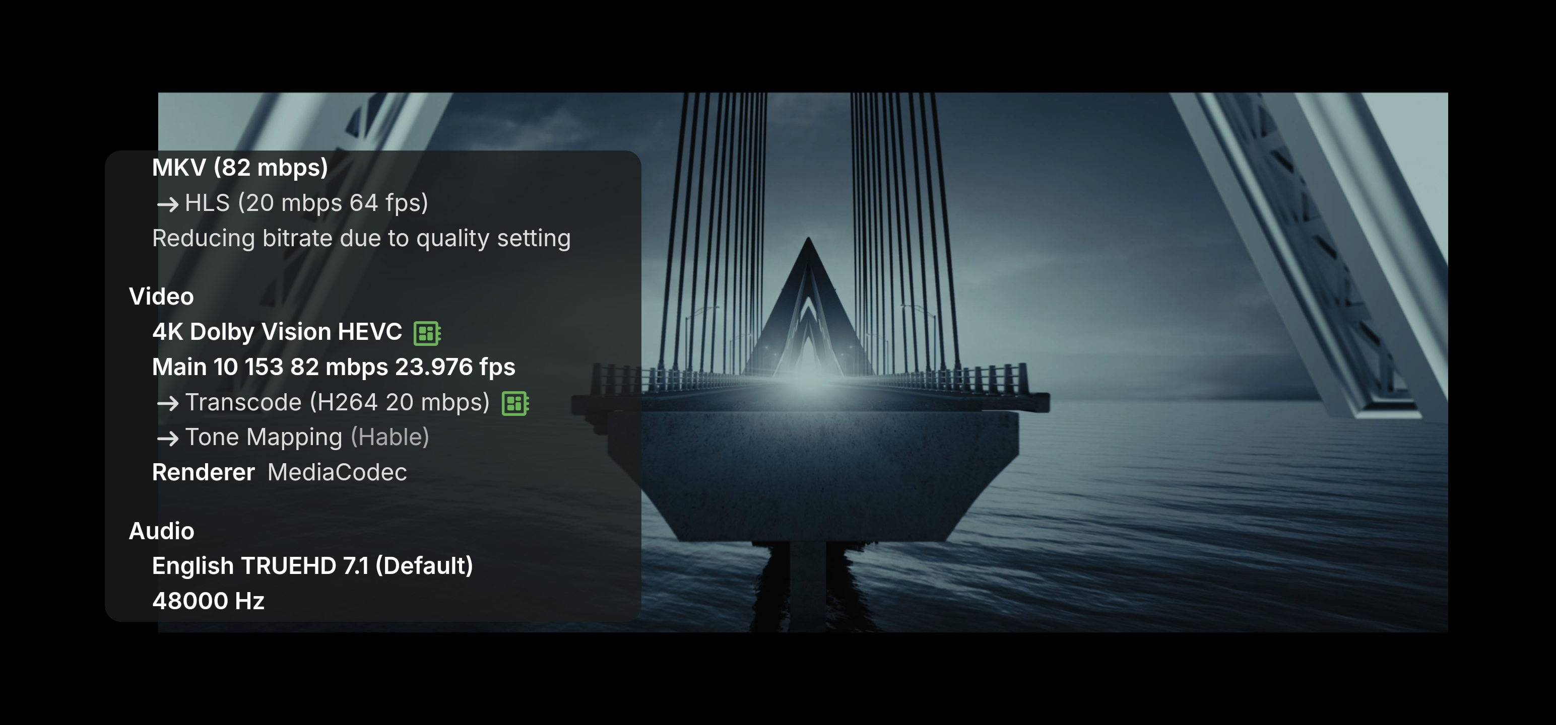

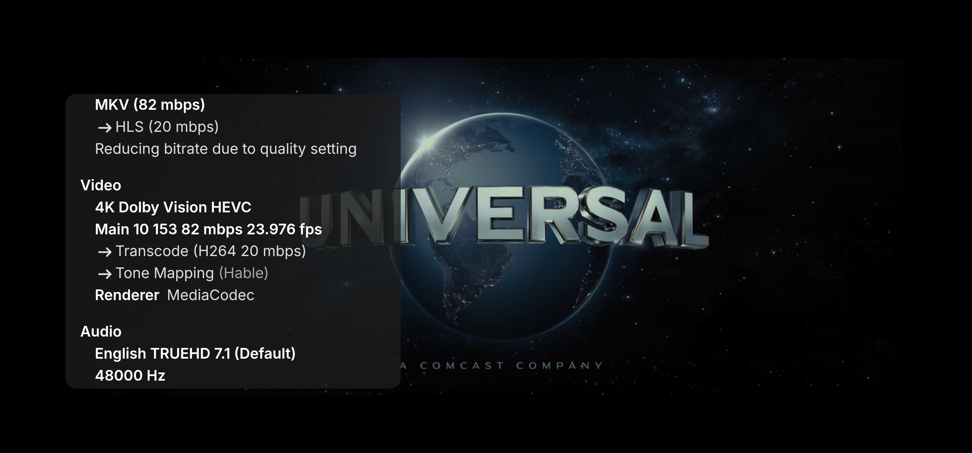

I now changed the order, installed the plug in (didn't change anything; the "Disable Hardware Subtitle Overlay" was already checked).
On the 1st movie, it start without showing the green symbol but after some seconds, it shows.
For this movie, I also have external subtitles (.srt) but the behavior was the same (screenshot 1 and 2)
Regarding the second movie (I don't have external subtitles) it still shows the green symbol (screenshot 3).
If it matters, the subtitles of the 1st movie are SUBRIP, and on the 2nd one are PGSSUB.

I tried now again (busy days so couldn't try it before) using my smartphone (Samsung Galaxy S23 Ultra Android 14, if that matters) on wifi, and both movies played without fine, without any green symbol.
- With the first movie, I tried using the Subrip subtitles from the movie, and with the external ones (.srt)
- The second one was with PGSSub.
Using 5G, it transcode to 1080p 20Mbpsand and the green symbols appeared after 25-30sec on the 1st movie (using Subrip or srt), and with the 2nd movie was right from the beginning.
