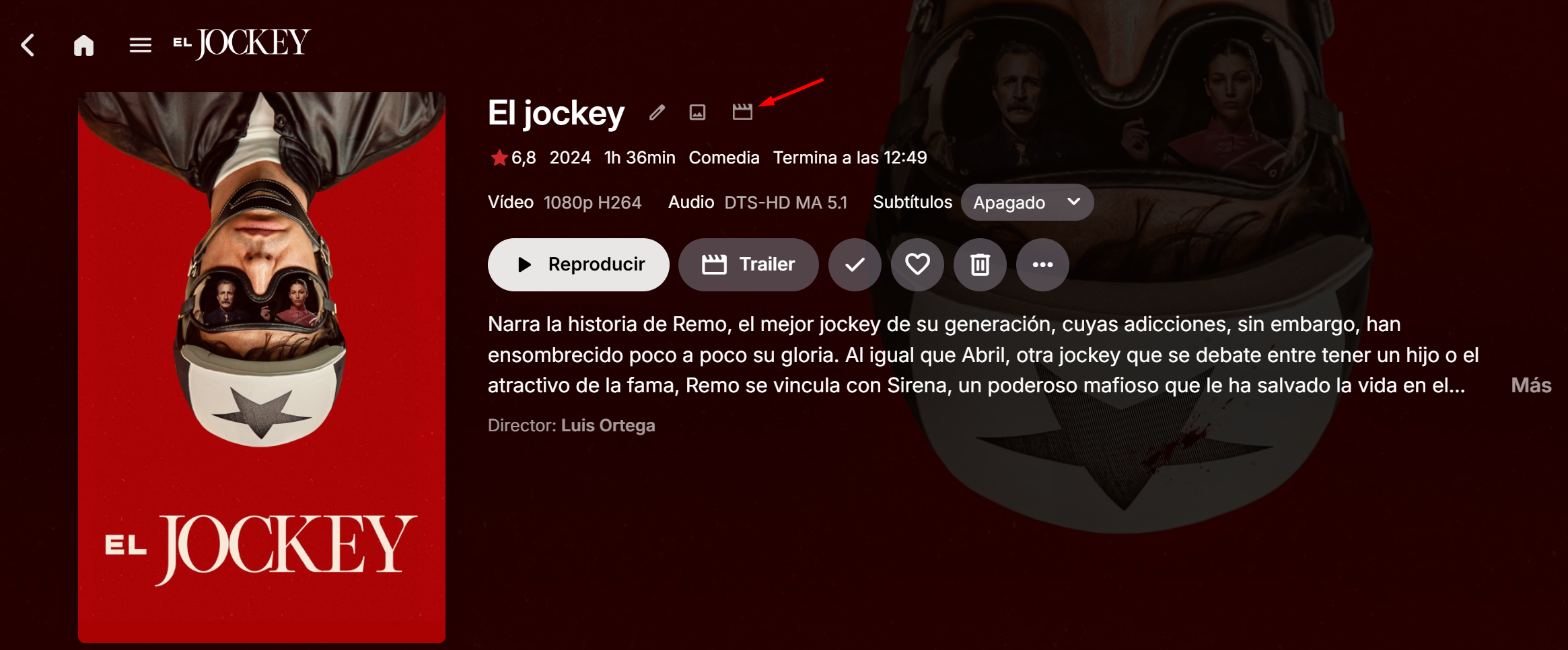

Asazen 8 Posted December 29, 2025 Posted December 29, 2025 (edited) I just created a request of this type and was directed to this thread. This is a fundamental issue; I don't understand why it's not already implemented. I think the best solution is to add a small icon like the one in the image so we can add any video we want, either via a link or a button to upload it to a custom folder on our server. Edited December 29, 2025 by Asazen 1

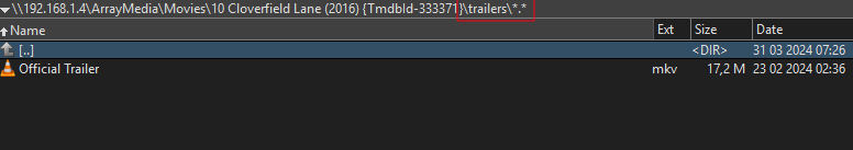

Luke 42242 Posted December 29, 2025 Posted December 29, 2025 5 hours ago, Asazen said: I just created a request of this type and was directed to this thread. This is a fundamental issue; I don't understand why it's not already implemented. I think the best solution is to add a small icon like the one in the image so we can add any video we want, either via a link or a button to upload it to a custom folder on our server. Hi, are you aware that you can add your own local trailer files? Trailer Naming
Asazen 8 Posted December 30, 2025 Posted December 30, 2025 Yes, I know, but I think that's a "dirty" option since you have to put the trailers along with the media. Ideally, everything should be located in a separate folder from the server, or even better, nothing should be hosted locally but rather with a YouTube link chosen by the server administrator. We don't even have the option to modify the current one that Emby extracts (I imagine it extracts it from TMDB).

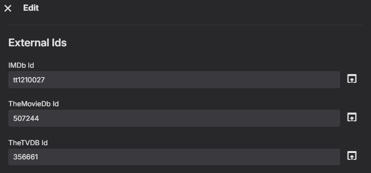

redaktorn 24 Posted January 3 Posted January 3 Just my opinion - but I think this problem can be easily solved. If you save .nfo files in your library settings, you can see in them that there is one or more lines for trailers. <trailer>plugin://plugin.video.youtube/play/?video_id=ZkEjle729tI</trailer> <trailer>plugin://plugin.video.youtube/play/?video_id=M7QhCm98eIQ</trailer> It works the same way as example the ID:s from TMDB/TVDB/IMDB: <imdbid>tt1210027</imdbid> <tvdbid>356661</tvdbid> <tmdbid>507244</tmdbid> When it comes to ID:s those can already be modified in the EMBY interface: I believe it would be pretty easy to make a similar options to put Youtube ID numbers for trailers into the interface? Maybe our clever developers can look into it? Myself, I sometimes edit the .nfo files when a trailer is "dead", has a strange language, is not relevant or has a very low quality. Only in very few cases I need to download a file and add it next to the movie file. (Downloading from Youtube with good quality can be very tricky, even if it is possible). Here is how it looks in the .nfo file: 4
