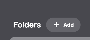

podonnell 48 Posted November 26, 2024 Posted November 26, 2024 If I wanted to add to an existing library, but have it separated for access purposes, is that as simple as hitting this button: And adding the new location? Then I'm guessing I would see an additional checkbox here, under that same library? Another important question, can I have my sub-library as a child folder within the existing library, or is that going to pick all files up automatically and add to the primary library? ie - say that C:\Movies\ is current library I want to make C:\Movies\Private Would having C:\Movies\ be granted to users prevent me from limiting access to C:\Movies\Private ?
Solution pwhodges 2023 Posted November 26, 2024 Solution Posted November 26, 2024 Do not add C:\Movies\Private as well as C:\Movies - this is a common source of problems. You'd be better off having another folder C:\Private-Movies and adding that. You can then use the Access tab in each user's setup to restrict access to the Private-Movies folder per user. Paul 2
podonnell 48 Posted November 26, 2024 Author Posted November 26, 2024 5 minutes ago, pwhodges said: Do not add C:\Movies\Private as well as C:\Movies - this is a common source of problems. You'd be better off having another folder C:\Private-Movies and adding that. You can then use the Access tab in each user's setup to restrict access to the Private-Movies folder per user. Paul Thanks - - I had surmised this may be an issue. My OCD wanted it to be set up within the same folder and not have to create a new private folder for each library I want to do this on, but if that is what prevents issues then I am all for it.
