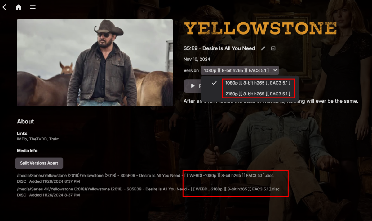

pmac 143 Posted November 26, 2024 Author Posted November 26, 2024 3 minutes ago, Neminem said: Hmm that's strange. All though "I know its not fair" done all these tests in beta 4.9.0.32 As that's my "destroy server setup" How much addon to the file naming do you have compaired to mine Folder : Cheers -- Season 01 file : Cheers s01e01 - 4K.disc Extension is a dummy file extension, left over from " Insert Disc to play " But has it's uses. My file names have a lot of information: "Yellowstone (2018) - S05E09 - Desire Is All You Need - [ WEBDL-2160p ][ 8-bit h265 ][ EAC3 5.1 ].mkv" But the same naming convention works fine for multi-version movies.
pmac 143 Posted November 26, 2024 Author Posted November 26, 2024 I'd like everything after the episode name to show up in the selection drop-down

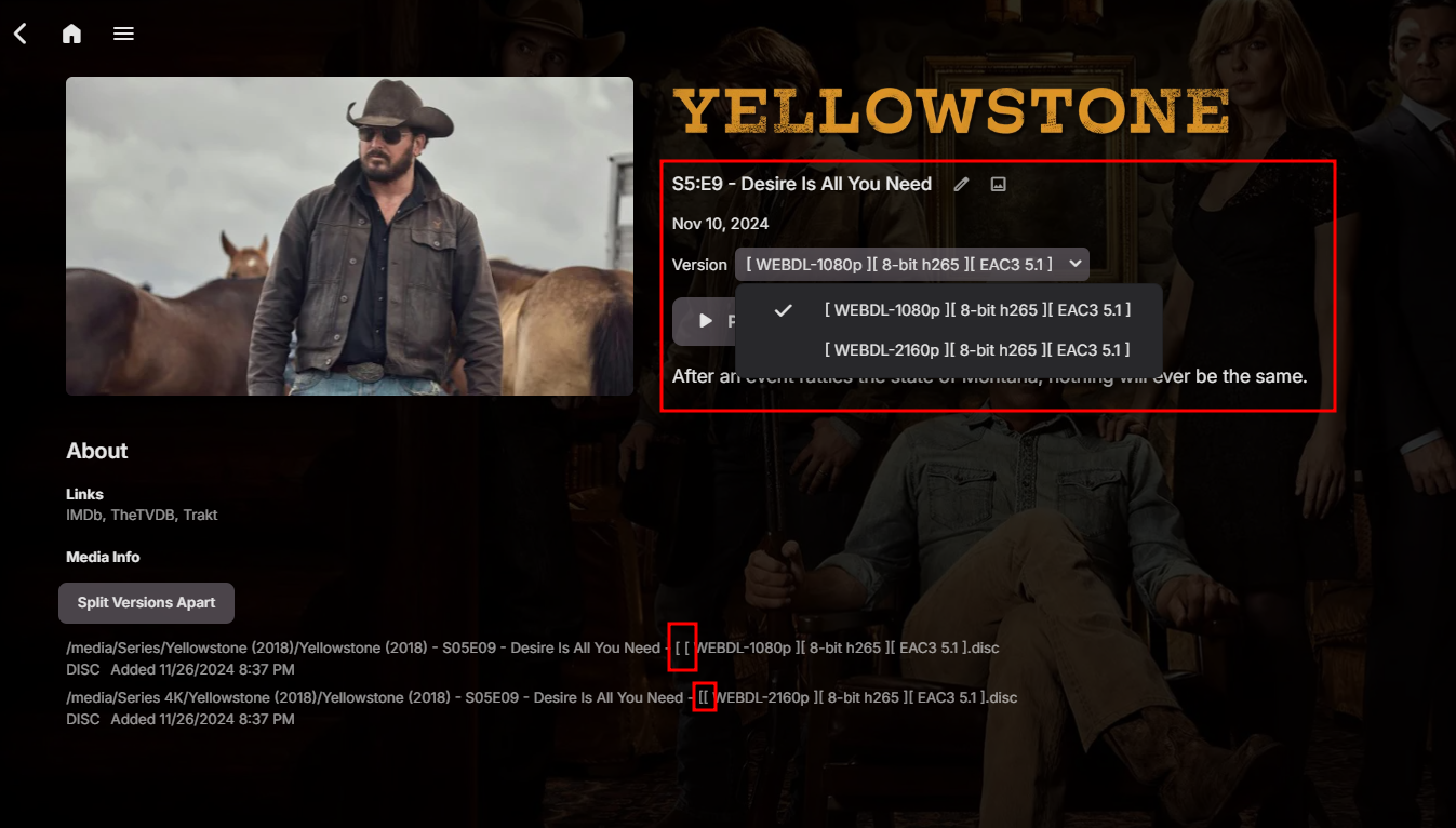

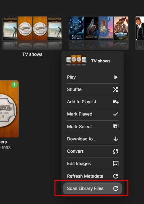

Neminem 1630 Posted November 26, 2024 Posted November 26, 2024 Hmm just testing something with your file naming. I think I found a in the beta server when testing you naming. But that's not a talk for this issue. But it look like you naming is good. Yellowstone (2018) - S05E09 - Desire Is All You Need - [ WEBDL-1080p ][ 8-bit h265 ][ EAC3 5.1 ].disc Here it is without the extra "space" on beta.
Neminem 1630 Posted November 26, 2024 Posted November 26, 2024 To get mine to update I do a library scan.

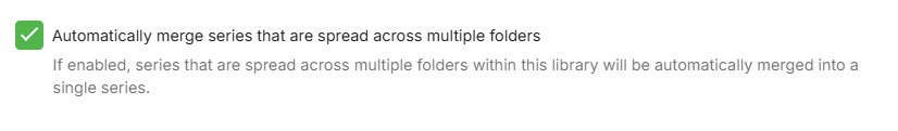

rbjtech 5345 Posted November 27, 2024 Posted November 27, 2024 @pmac- you've confirmed the setting below correct ? 6 hours ago, rbjtech said:
pmac 143 Posted November 27, 2024 Author Posted November 27, 2024 Just now, rbjtech said: @pmac- you've confirmed the setting below correct ? Yes

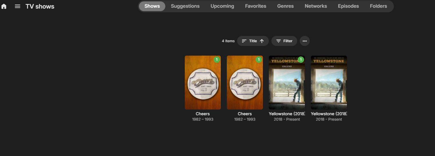

pmac 143 Posted November 28, 2024 Author Posted November 28, 2024 (edited) I've finally completed a full library scan after making renaming all of my files/folders to make sure they have the same naming conventions. None of my multi-version series have merged; still showing up as two separate series, yet have their watched statuses in sync with eachother regardless of which version was actually watched. Edited November 28, 2024 by pmac

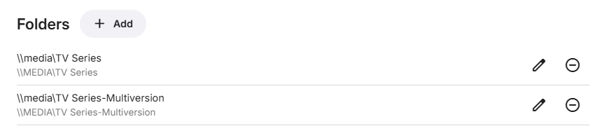

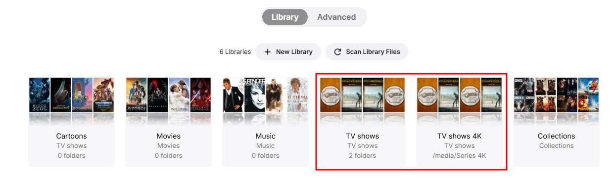

pmac 143 Posted November 28, 2024 Author Posted November 28, 2024 Also to note: I currently have two separate library's for tv series ("Television" and "4K Television"). "Television" is associated with both folders, and "4K Television" is only associated with the 4K folder. Would having two separate libraries be messing this up? ie. Should I remove the 4K library, and only have the single Television library that's associated with both version folders?
Solution Neminem 1630 Posted November 28, 2024 Solution Posted November 28, 2024 1 hour ago, pmac said: Would having two separate libraries be messing this up? ie. Should I remove the 4K library, and only have the single Television library that's associated with both version folders? Just tested this, and It broke my multi-version. Deleting my 4k only library bringes it back. I have to do a new scan, on my remaining tv library.
rbjtech 5345 Posted November 28, 2024 Posted November 28, 2024 1 hour ago, pmac said: Would having two separate libraries be messing this up? ie. Should I remove the 4K library, and only have the single Television library that's associated with both version folders? Yes. Just list both the folders in the single library.
rbjtech 5345 Posted November 28, 2024 Posted November 28, 2024 15 minutes ago, Neminem said: @Lukeis this a bug ? I don't think so - I'm not 100% on what you did, but it sounded like you added the same content to multiple libraries - ie a receipe for db corruption. All @pmacneeds to do is have a single library with multiple folders/shares - but I'm sure you're aware of that .. 1
Luke 42288 Posted November 28, 2024 Posted November 28, 2024 This isn't corruption, it's just that in this case the merging will not be supported when configure your libraries like that. The series is only added to your server database once, so which set of library options gets used will be arbitrary.
