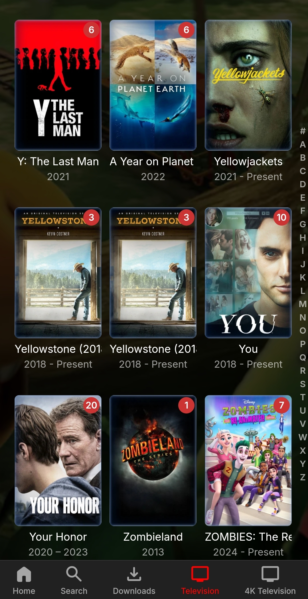

pmac 143 Posted November 23, 2024 Posted November 23, 2024 I'm trying to organize my HD and UHD tv series libraries to show up as a single series with a version dropdown like my movie collection (which works just as intended). I have my library split into separate folders "/Television/Series/Season/" and "/Television4K/Series/Season/", merge separate folders is enabled, the series folders are named identically, and I've manually used identify on both series versions to make sure sure they were identified correctly. I have HD and UHD set up as separate libraries for easy access from the home screen, but I've also added the UHD folder to the HD library (just as I've done with movies), in hopes it would show both versions when playing an episode from the HD library. One example would be: ".../Television4K/The Expanse (2015)/Season 6/The Expanse - S06E01 - Strange Dogs [ WEBDL-2160p ][ 10-bit h265][ EAC3 5.1 ].mkv" ".../Television/The Expanse (2015)/Season 6/The Expanse - S06E01 - Strange Dogs [ HDTV 720p ][ 8-bit h264][ EAC3 5.1 ].mkv" Both of these have identical series/episode metadata, but show up as separate series instead of being merged and presenting a version drop-down like expected. Is there something I'm missing here? I used an auto-grouping plugin to merge movies across separate folders to behave this way, but I was under the impression that this was natively possible with Multi-version TV series. Keeping both files in the same folder isn't possible with my setup.

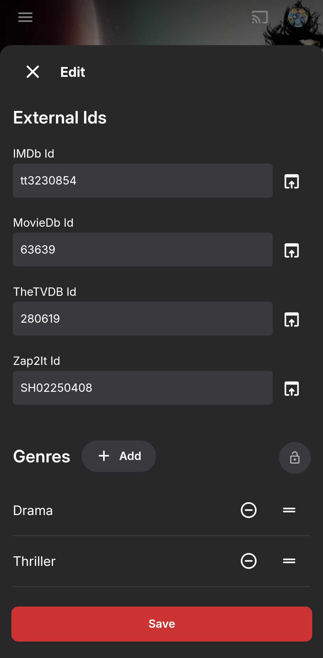

Luke 42288 Posted November 24, 2024 Posted November 24, 2024 They need to show up as the same series. Once that happens, the episodes will merge. I would compare the metadata between the two.

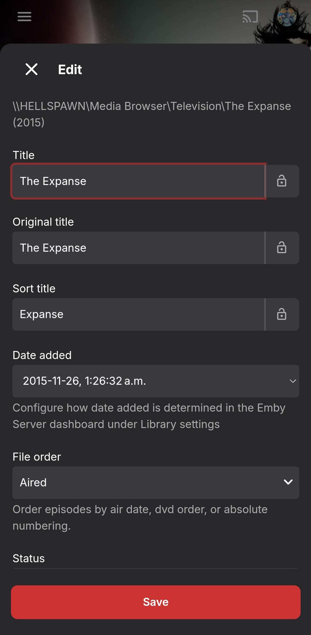

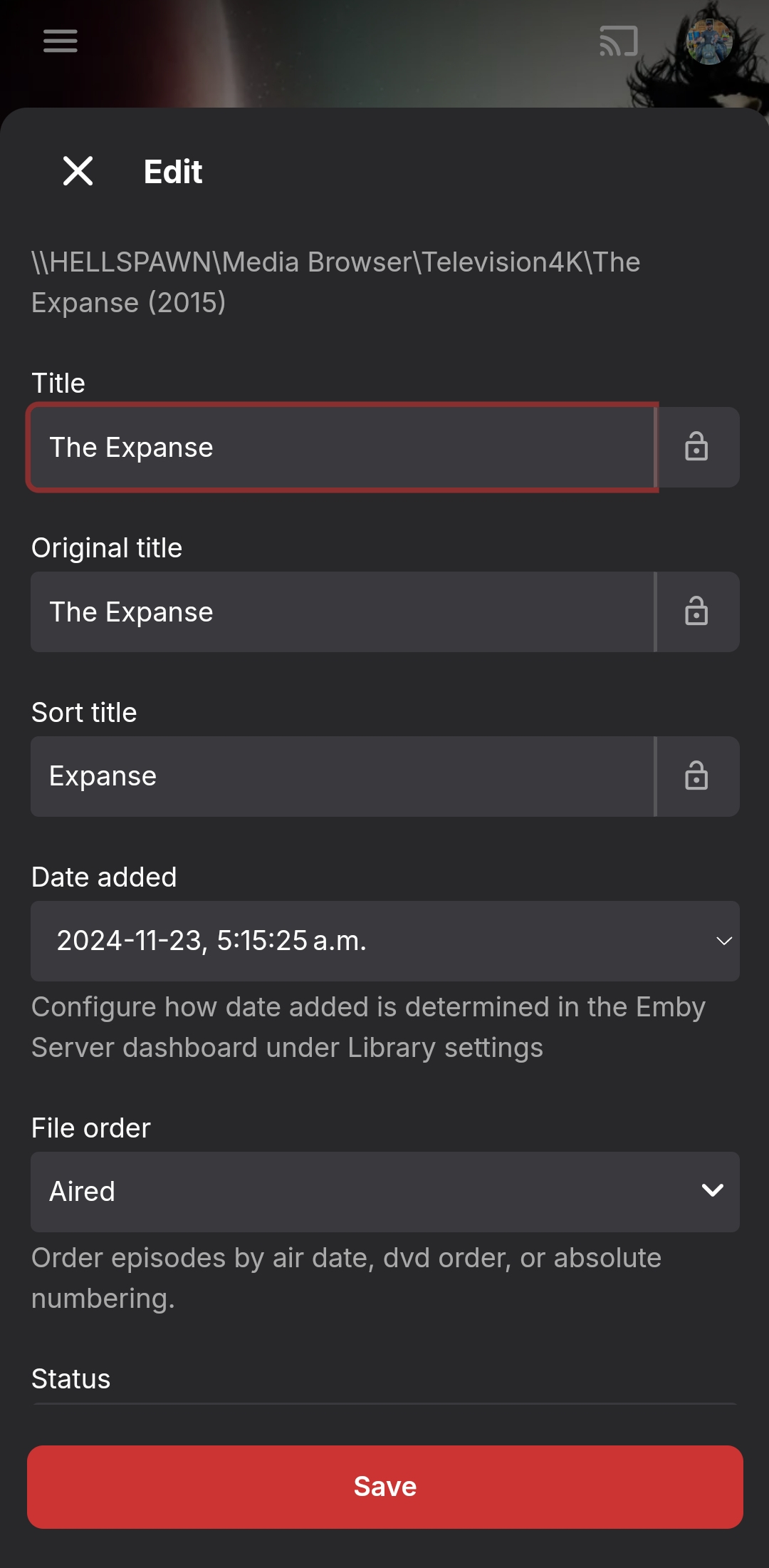

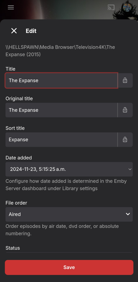

pmac 143 Posted November 24, 2024 Author Posted November 24, 2024 16 minutes ago, Luke said: They need to show up as the same series. Once that happens, the episodes will merge. I would compare the metadata between the two. They're identical, aside from the folder location. HD: UHD:

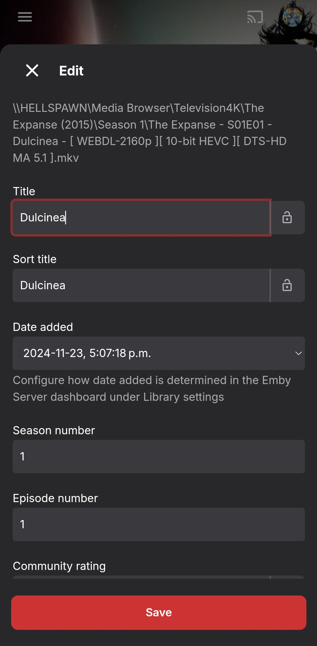

pmac 143 Posted November 24, 2024 Author Posted November 24, 2024 Here is an example comparing metadata of two versions of the same episode:

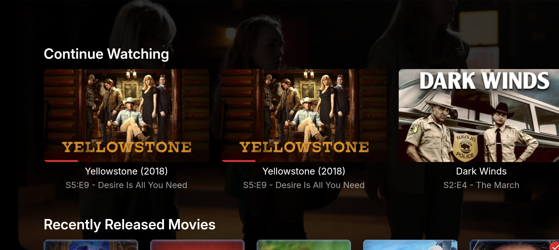

pmac 143 Posted November 26, 2024 Author Posted November 26, 2024 For example, I just skipped ahead roughly 11 minutes on the UHD version of this show, and when I go back to the home screen it shows the HD and UHD versions separately on "Continue Watching" as if I watched them both at the same time, rather than combining them into one show

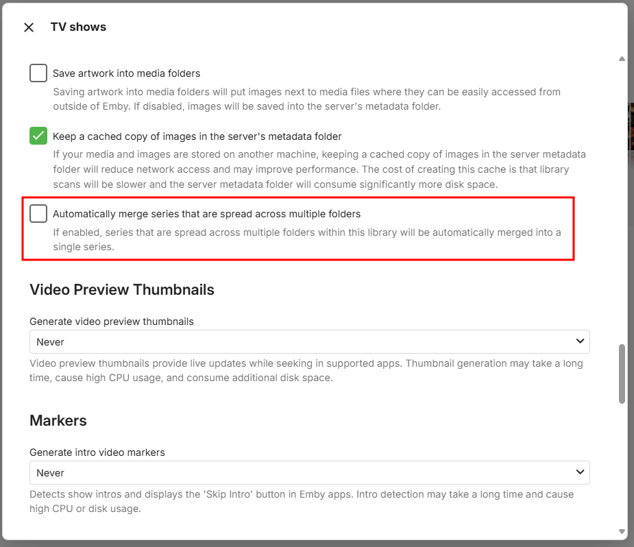

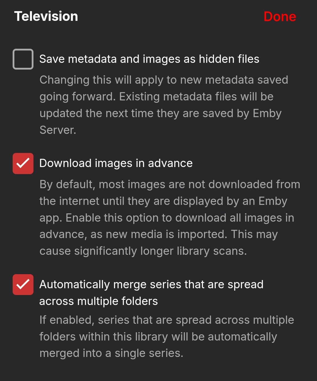

Neminem 1630 Posted November 26, 2024 Posted November 26, 2024 More info We need this enabled Other wise this happens.
pmac 143 Posted November 26, 2024 Author Posted November 26, 2024 41 minutes ago, Neminem said: Did you rename your whole tv collection ? Or just a test sample ? I started with a test sample, but it didn't fix the issue I'm having. I'm still renaming my whole collection (it's still processing right now), but only because I didn't realize there were some inconsistencies in naming and I'm a little OCD about that, lol. Unfortunately, it doesn't look like it's going to fix my issue though.
pmac 143 Posted November 26, 2024 Author Posted November 26, 2024 24 minutes ago, Neminem said: More info We need this enabled Other wise this happens. I have that enabled, but I'm still getting the result in the bottom of your post, as if it's not enabled.

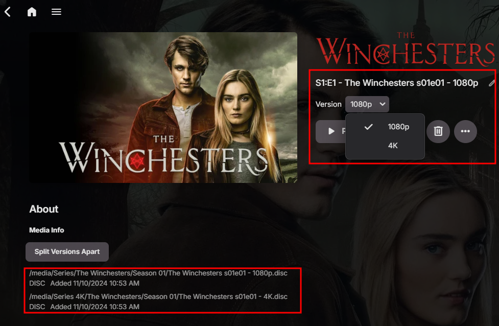

Neminem 1630 Posted November 26, 2024 Posted November 26, 2024 It took some time for mine to see my change, even if was just 2 episodes. 1080p and a 4k file. I'm guessing is still sorting all you other file renaming. By the way, have you set is up like this ?
pmac 143 Posted November 26, 2024 Author Posted November 26, 2024 4 minutes ago, Neminem said: It took some time for mine to see my change, even if was just 2 episodes. 1080p and a 4k file. I'm guessing is still sorting all you other file renaming. By the way, have you set is up like this ? Yes, it's set up just like that. It's been a few days since I first tested this with a single series, and refreshed library data. Still isn't working though. My current renaming process wouldn't have made a difference there, as I just started doing that earlier today.

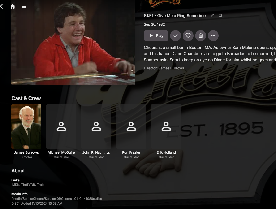

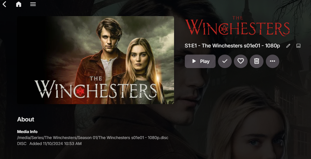

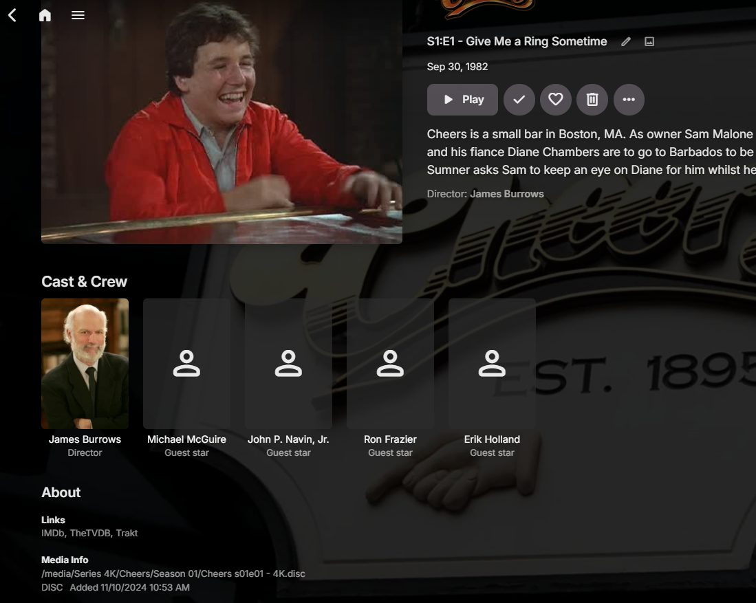

Neminem 1630 Posted November 26, 2024 Posted November 26, 2024 Hmm ok here is a simple test. This give me 1080p and 4k
Neminem 1630 Posted November 26, 2024 Posted November 26, 2024 Hmm that's strange. All though "I know its not fair" done all these tests in beta 4.9.0.32 As that's my "destroy server setup" How much addon to the file naming do you have compaired to mine Folder : Cheers -- Season 01 file : Cheers s01e01 - 4K.disc Extension is a dummy file extension, left over from " Insert Disc to play " But has it's uses.
