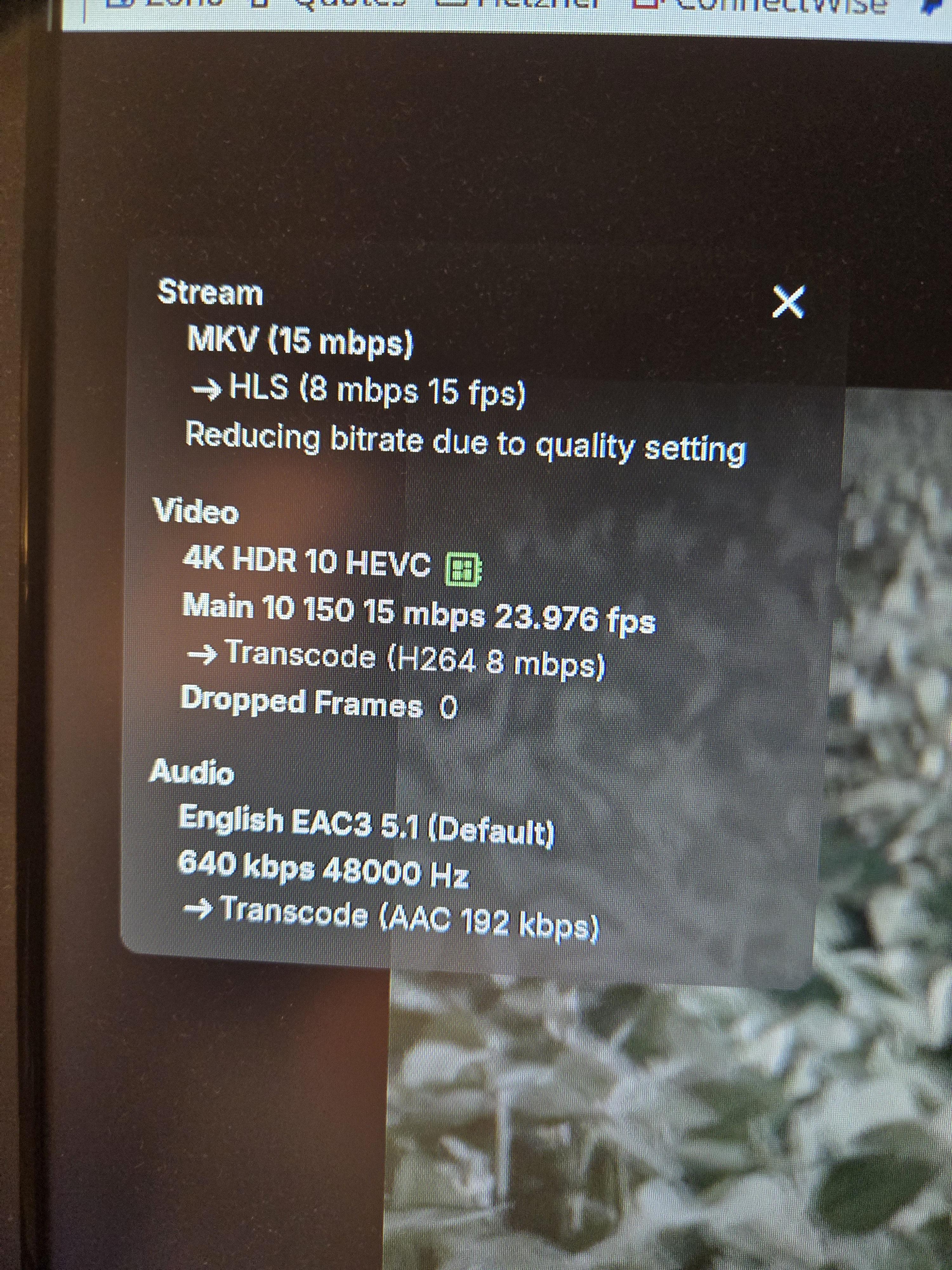

tollgate 8 Posted November 23, 2024 Author Posted November 23, 2024 Thank you for taking the time to look at the log. Yes. Arch. Running as user emby - added to video and render groups. DynamicUser set to false. HW acceleration is working but still only manages 16fps. Please see jpg attached.
