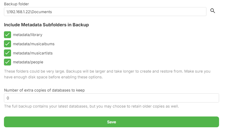

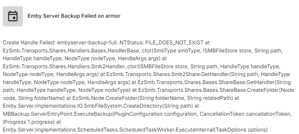

robsch 45 Posted November 21, 2024 Posted November 21, 2024 I started to have issues as well. Strangely it makes the folder, it just fails to put anything IN the folder. The server it is writing to has 60tb free, and I the permissions are properly set. I have manually mapped the drive to that machine and I can write/delete files and directories into that folder.
Barlog9511 17 Posted November 21, 2024 Author Posted November 21, 2024 On 11/20/2024 at 2:17 AM, Luke said: Hi, is your disk full or hard drive having a problem? Hi @Luke My HDD is OK nothing change , this plugin just stop working

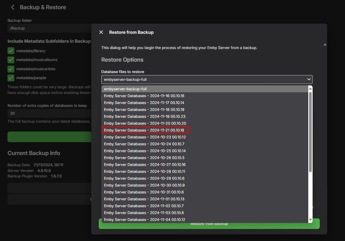

Neminem 1586 Posted November 21, 2024 Posted November 21, 2024 (edited) @robschThis look fun, you are not keeping any backups What happens if you press restore ? Mine did a backup today, i'm kepping 30 days. Edited November 21, 2024 by Neminem

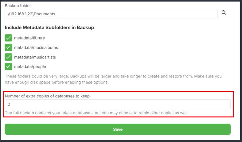

robsch 45 Posted November 21, 2024 Posted November 21, 2024 7 minutes ago, Neminem said: @robschThis look fun, you are not keeping any backups What happens if you press restore ? Mine did a backup today, i'm kepping 30 days. I had it to 10, but I changed it to 0, which I thought might of been "Unlimited" I have no options to restore anything. I changed it to 10, restarted Emby, and still get the same exact error.
Neminem 1586 Posted November 21, 2024 Posted November 21, 2024 Did you run the Emby Server Backup task, after editing the amount of backups to keep ?

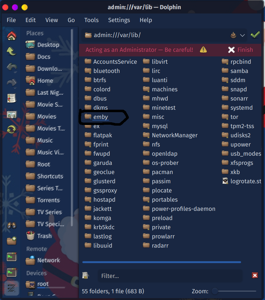

IAmHugh 63 Posted November 28, 2024 Posted November 28, 2024 (edited) I attempted to setup backups yesterday and I'm having the same issue. I believe in my case that it may be due to the fact that in Arch /var/lib/emby is a locked directory unless I stop the Emby service or I access it as admin. embyserver.txt Edited November 28, 2024 by CummingCowGirl

IAmHugh 63 Posted November 29, 2024 Posted November 29, 2024 I just tried systemctl start emby-server.service and checked /var/lib/emby/ and still locked. Shut down the server from within Emby and the folder is still locked. Any ideas?
Q-Droid 1001 Posted November 29, 2024 Posted November 29, 2024 What do you mean by locked? What is it that's actually locked? In the logfile you posted the errors are due to the backup destination being read-only for the Emby runtime user. The server can't create backups in that path. There's no indication of a problem with /var/lib/emby.
IAmHugh 63 Posted November 30, 2024 Posted November 30, 2024 (edited) All three of my external drives are setup the exact same way. GPT device table with BTRFS partitions, so the permissions would be the same across the board. Why should something like backup for Emby have a issue accessing any folder on any of those drives when Emby accesses my media folders without issue? As for the locked folder. First image Dolphin opened in my user account. Second image opened in root. Edited November 30, 2024 by CummingCowGirl
