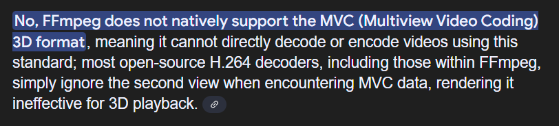

Guest Posted November 22, 2024 Posted November 22, 2024 Pretty sure MVC isn't supported, but I'll have to confirm that later.
Guest Posted November 22, 2024 Posted November 22, 2024 (edited) --vf=format:stereo-in=help What mpv supports no mono sbs2l ab2r ab2l checkr checkl irr irl icr icl arcc sbs2r agmc al ar MVC isn't supported Edited November 22, 2024 by generiq
