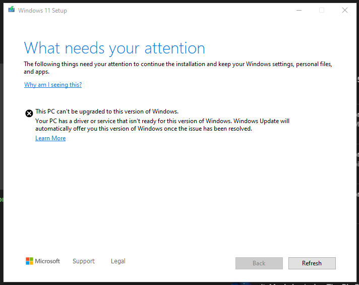

Lyfesaver 135 Posted December 6, 2024 Author Posted December 6, 2024 On 12/4/2024 at 8:30 PM, softworkz said: It's a little late that you "suddenly remember" that there has been a fundamental system change in-between. It's not about graphics drivers then, but other drivers which haven't been switched properly. Install Win11 - it will keep your settings, but it's like a fresh install - probably the best in yure case now. I am trying to do that, but even it is not going as plannned My current roadblock. I know y'all cant help on that one, but just wanted to show you where I was at in the upgrade process. No worries tho, I will get to the mountain top, even if its the last thing I do
softworkz 5133 Posted December 6, 2024 Posted December 6, 2024 There's surely a log which tells the exact reason, then you can uninstall that driver or service. Or: Download an ISO image for installation from a USB stick on bootup, yet I don't remember whether this will retain your data, so don't go without backup into this. 1
Lyfesaver 135 Posted December 6, 2024 Author Posted December 6, 2024 1 minute ago, softworkz said: There's surely a log which tells the exact reason, then you can uninstall that driver or service. Or: Download an ISO image for installation from a USB stick on bootup, yet I don't remember whether this will retain your data, so don't go without backup into this. Turns out it was my EasyAntiCheat. Renamed the folder and poof: 1

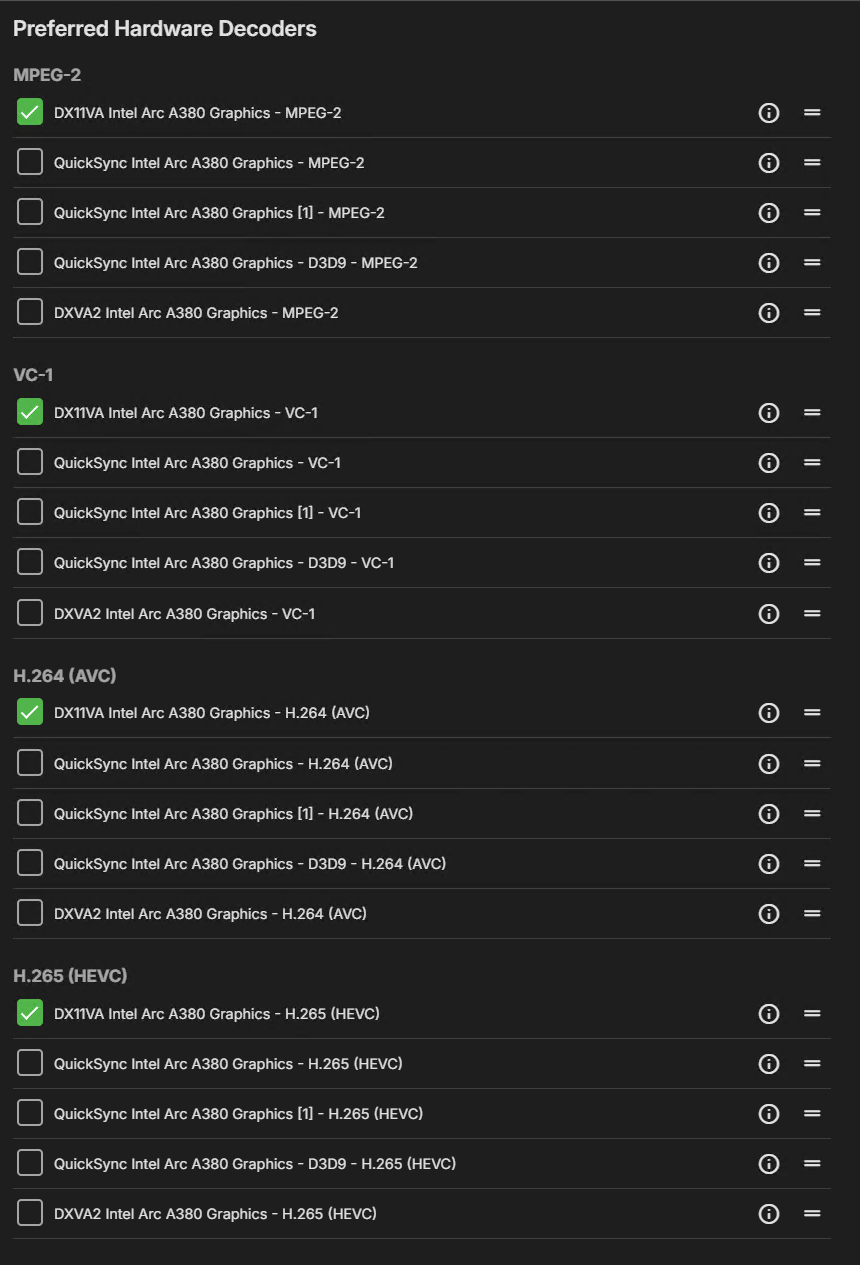

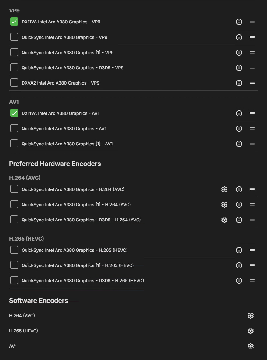

softworkz 5133 Posted December 6, 2024 Posted December 6, 2024 It seems to be a hardware issue. The duplication is still there. But probably it's working at least. Just uncheck the entries with [1] Also, disable trhe "Show D3D9 Codecs" settings in the diagnostics plugin that we had enabled. 1
Lyfesaver 135 Posted December 6, 2024 Author Posted December 6, 2024 3 minutes ago, softworkz said: It seems to be a hardware issue. The duplication is still there. But probably it's working at least. Just uncheck the entries with [1] Also, disable trhe "Show D3D9 Codecs" settings in the diagnostics plugin that we had enabled. Done! Thank you so much softworks and Carlo, seriously. I know it can be very frustrating to offer support on projects and extremely frustrating when dealing with me in particular. So from the core of my being... thank you very, very much 2
Lyfesaver 135 Posted December 6, 2024 Author Posted December 6, 2024 34 minutes ago, softworkz said: ... Just uncheck the entries with [1] ... Seems if I check one and Save then the other [1] also gets checked but you are right that it is most likely working fine
softworkz 5133 Posted December 6, 2024 Posted December 6, 2024 33 minutes ago, Lyfesaver said: Seems if I check one and Save then the other [1] also gets checked That's probably due to identical IDs. We have never had any case like that - which illustrates how quirked the situation is. Just leave it checked then, it probably won't matter if it's the same Id. I would still consider contacting Intel about it, evenmore when something doesn't work as expected - that will be the first step. 1
