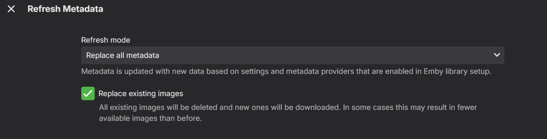

Next, I tried "Refresh Metadata" (Replace existing images), but the album art did not update.

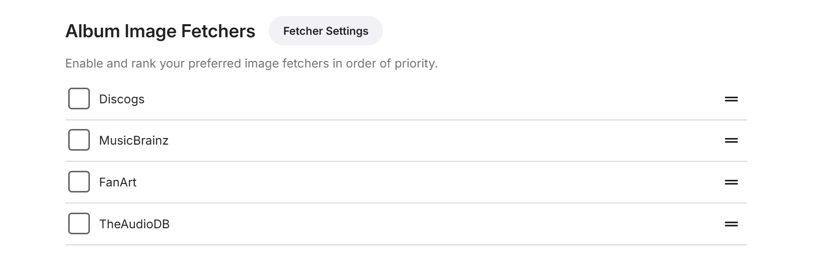

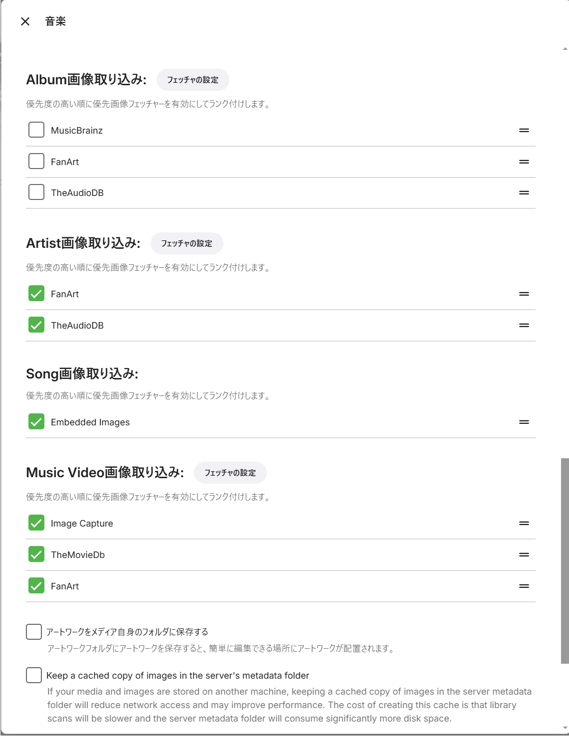

Ok, I've been trying a few things... If you have any Album Image Fetchers enabled when you first set up your music library, then Emby may have imported album images that you deem as incorrect. Even if you then try to import your preferred embedded images Emby may still not accept them, due to the Album Image Fetchers enabling. If you disable all of these, then hopefully that will allow you to import your own embedded Album images in place of the others.
Go into your Emby settings and select the relevant library and scroll down, you should see this:
Turn all of these off and then go back and try the steps I mentioned previously.
You might also want to review all of the other downloaders and fetchers that may be enabled by default. sometimes they are useful and sometimes they are not!
After your turn off the Album Image Fetchers you could also try this:

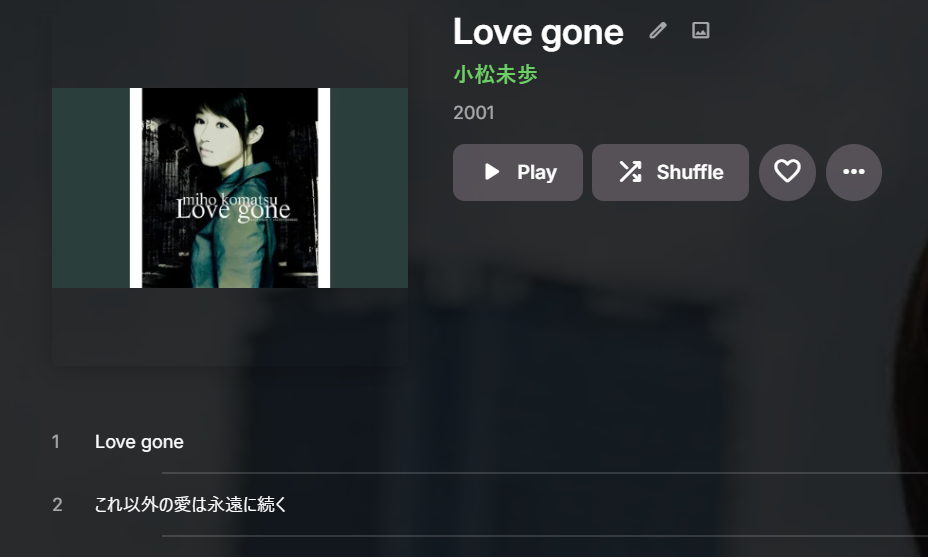

The track's album art was changed in the tags. However, the album's album art itself remained unchanged.
Now it's just the album's album art left, so I think I'll change it manually.

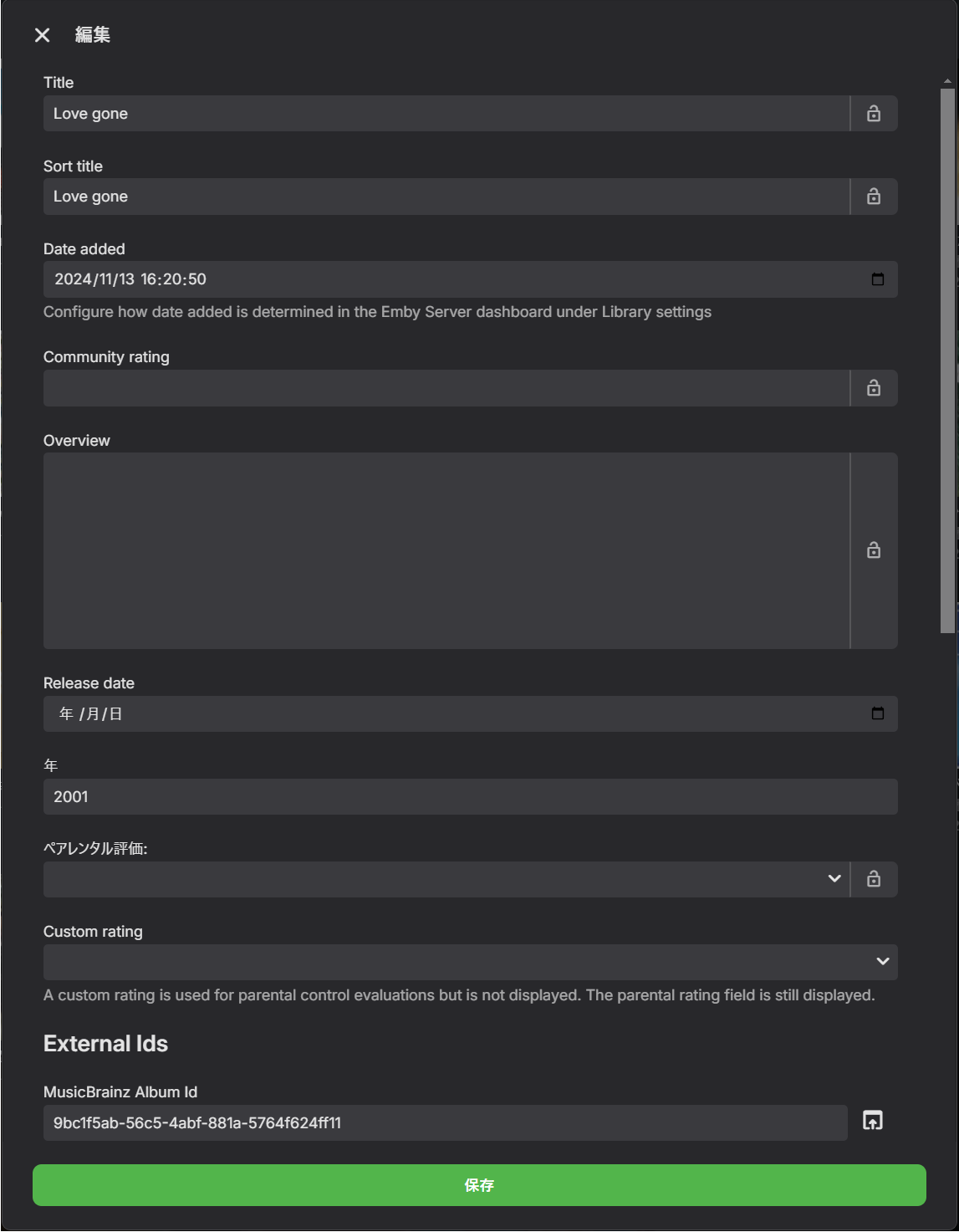

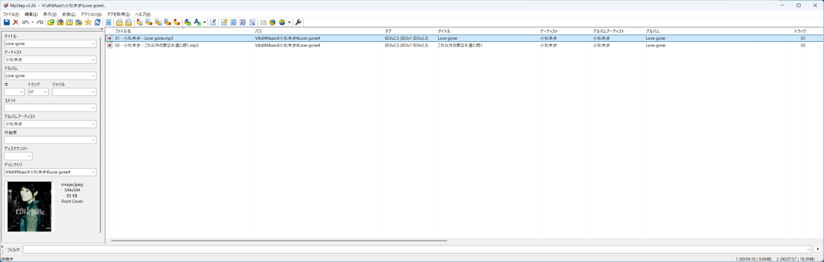

Hmmm, I'm just guessing as to what the exact cause could be with you set up. Are you able to provide a specific example of a problem album and further details of how you have set up your musc library. This may help reproduce the problem. E.g.
  • Example album
  • Are you using Mp3tag (or another program) first. I'm not exactly sure from what you are saying.
  • Screenshots of the Mp3tag metadata
  • Screenshots of Emby metadata
  • Overall library folder structure
  • Screenshot of your files in a problem album folder
  • The settings you have enabled/disabled for your music library in Emby
  • Do you have any MusicBrainz IDs in your embedded metadata or Emby

  • Example album

It's included. Please look at the "Screenshots of Emby metadata."

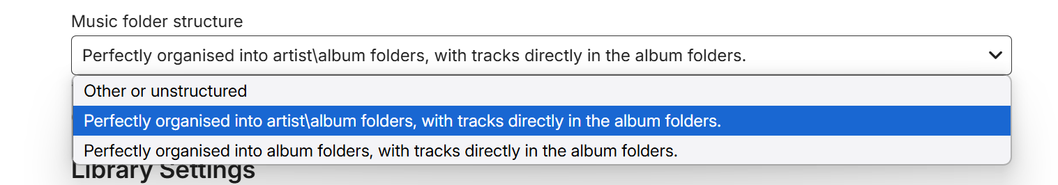

Your overall folder structure e.g. Artist|Album|Song, but what do you have selected here:

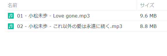

This is a folder of entities.
There are no files other than mp3.
What do you have selected here:
The second "Artist/Album".

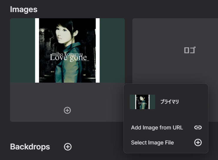

I deleted the album art in Emby, but it doesn't seem to disappear.
