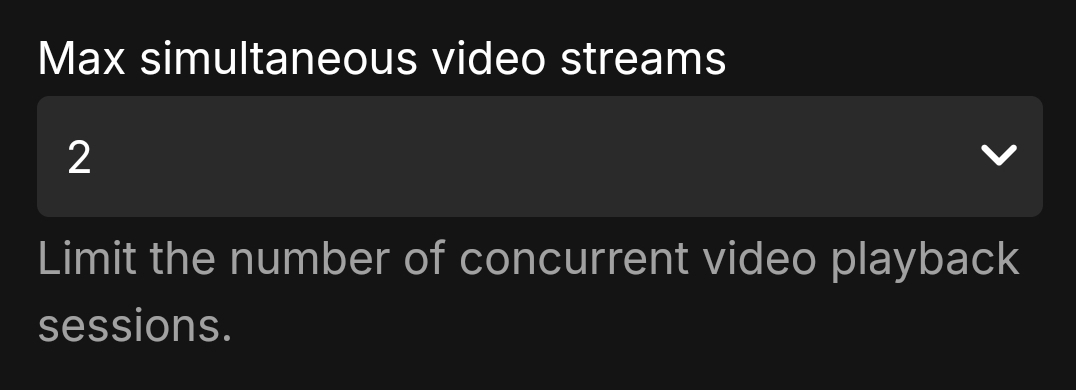

beefsnack 17 Posted November 14, 2024 Posted November 14, 2024 Where can I stop this from happening to my users? "Your account has gone over the maximum streaming limit set by your Emby Server Admin. please contact them." I always reset the streams and it works but i have to do this every time, with all my users every now and again don't really pay attention if it's a weekly monthly thing but it's frequently enough to be annoying, any assistance would be appreciated. TIA. Beef.

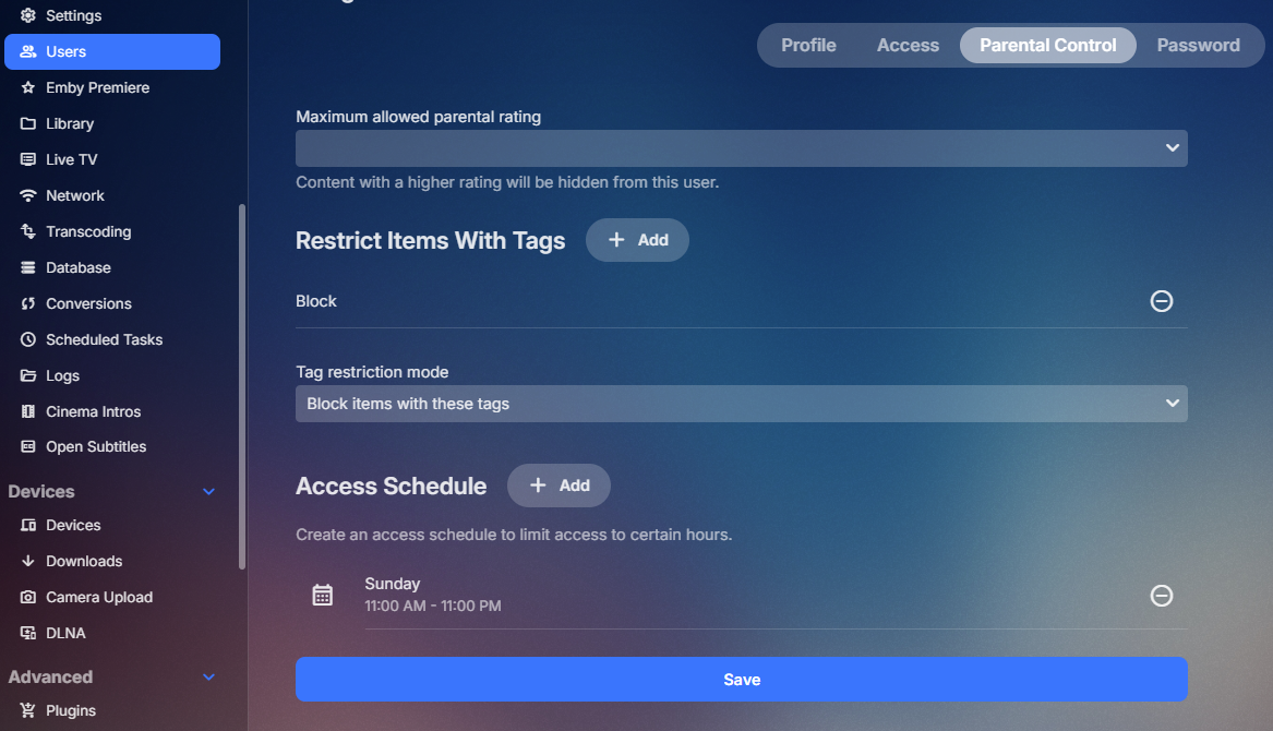

Happy2Play 9814 Posted November 14, 2024 Posted November 14, 2024 That notice suggest there is Access Schedule applied to the user.

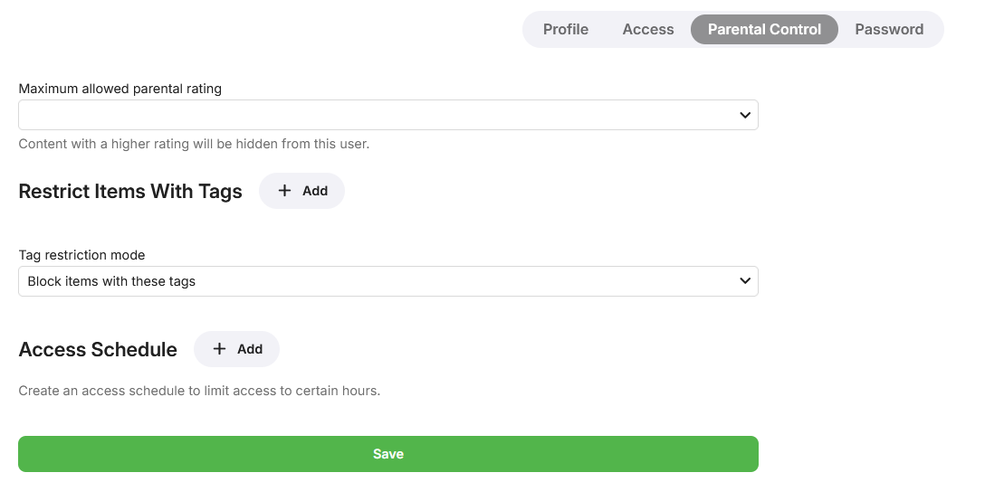

beefsnack 17 Posted November 14, 2024 Author Posted November 14, 2024 (edited) nope it's blank, I've checked Edited November 14, 2024 by beefsnack
darkassassin07 674 Posted November 14, 2024 Posted November 14, 2024 I've found in the past; if I set this to 1, users occasionally have issues quickly ending one stream and starting another. Moving from one episode to the next, for example. 1
Luke 42287 Posted November 14, 2024 Posted November 14, 2024 It could also be set globally in the server network section, or on the m3u tuner in live tv settings.
beefsnack 17 Posted November 14, 2024 Author Posted November 14, 2024 1 hour ago, Luke said: It could also be set globally in the server network section, or on the m3u tuner in live tv settings. I'll check, I don't have Live enabled so network it is
Solution beefsnack 17 Posted November 14, 2024 Author Solution Posted November 14, 2024 Thanks for the help, I'll test and see if the Network helps, everything else I've already done and redone, I'll wait and see if it happens anymore. Thanks again. 1
AaronClarke 3 Posted December 13, 2024 Posted December 13, 2024 On 14/11/2024 at 04:41, Happy2Play said: That notice suggest there is Access Schedule applied to the user. I was having the same issue with my kids accounts. Even when outside of the times specified in the schedule, they were getting this message preventing them from watching anything on Emby. I had to completely remove the Access Schedule in order for them to be able to start watching again! It seems this functionality may not be working properly? Would also be helpful if the message displayed reflected that they user is trying to view content outside of the permitted Access Schedule.

Happy2Play 9814 Posted December 17, 2024 Posted December 17, 2024 Yes minus your server writing something wierd or maybe something off with Time on system? As my test of Tuesday between 7am and 8am had no issues. <AccessSchedules> <AccessSchedule> <DayOfWeek>Tuesday</DayOfWeek> <StartHour>7</StartHour> <EndHour>8</EndHour> </AccessSchedule> </AccessSchedules>

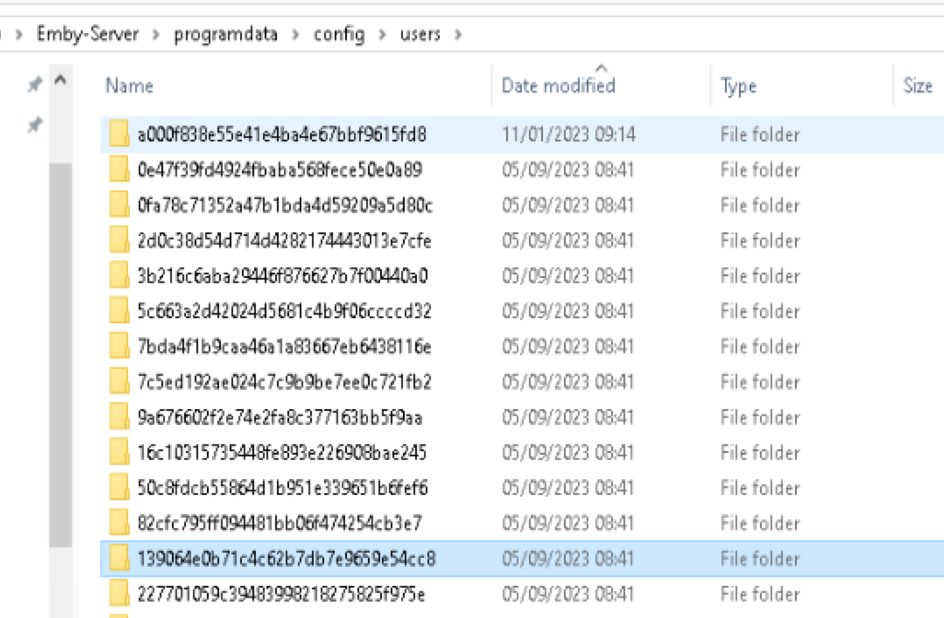

AaronClarke 3 Posted December 17, 2024 Posted December 17, 2024 Actually.... Ive just noticed that the User Folders seem to be messed up..... The policy I posted before was from the user folder named after one of the accounts in question but on closer inspection I noticed that it does not reflect the changes made... .instead there is a folder named with a random string "config\users\139064e0b71c4c62b7db7e9659e54cc8" which contains the relevant policy. Could this cause issues? <?xml version="1.0"?> <UserPolicy xmlns:xsi="http://www.w3.org/2001/XMLSchema-instance" xmlns:xsd="http://www.w3.org/2001/XMLSchema"> <IsAdministrator>false</IsAdministrator> <IsHidden>true</IsHidden> <IsHiddenRemotely>true</IsHiddenRemotely> <IsHiddenFromUnusedDevices>true</IsHiddenFromUnusedDevices> <IsDisabled>false</IsDisabled> <LockedOutDate>0</LockedOutDate> <MaxParentalRating>5</MaxParentalRating> <AllowTagOrRating>false</AllowTagOrRating> <BlockedTags> <string>Children's</string> <string>Childrens</string> </BlockedTags> <IsTagBlockingModeInclusive>true</IsTagBlockingModeInclusive> <IncludeTags /> <EnableUserPreferenceAccess>false</EnableUserPreferenceAccess> <AccessSchedules> <AccessSchedule> <DayOfWeek>Sunday</DayOfWeek> <StartHour>6</StartHour> <EndHour>20</EndHour> </AccessSchedule> <AccessSchedule> <DayOfWeek>Monday</DayOfWeek> <StartHour>8</StartHour> <EndHour>20</EndHour> </AccessSchedule> <AccessSchedule> <DayOfWeek>Tuesday</DayOfWeek> <StartHour>8</StartHour> <EndHour>20</EndHour> </AccessSchedule> </AccessSchedules> <BlockUnratedItems> <UnratedItem>Book</UnratedItem> <UnratedItem>Game</UnratedItem> <UnratedItem>ChannelContent</UnratedItem> <UnratedItem>LiveTvChannel</UnratedItem> <UnratedItem>Movie</UnratedItem> <UnratedItem>Music</UnratedItem> <UnratedItem>Trailer</UnratedItem> <UnratedItem>Series</UnratedItem> </BlockUnratedItems> <EnableRemoteControlOfOtherUsers>false</EnableRemoteControlOfOtherUsers> <EnableSharedDeviceControl>false</EnableSharedDeviceControl> <EnableRemoteAccess>true</EnableRemoteAccess> <EnableLiveTvManagement>false</EnableLiveTvManagement> <EnableLiveTvAccess>true</EnableLiveTvAccess> <EnableMediaPlayback>true</EnableMediaPlayback> <EnableAudioPlaybackTranscoding>true</EnableAudioPlaybackTranscoding> <EnableVideoPlaybackTranscoding>true</EnableVideoPlaybackTranscoding> <EnablePlaybackRemuxing>true</EnablePlaybackRemuxing> <EnableContentDeletion>false</EnableContentDeletion> <RestrictedFeatures /> <EnableContentDeletionFromFolders /> <EnableContentDownloading>false</EnableContentDownloading> <EnableSubtitleDownloading>false</EnableSubtitleDownloading> <EnableSubtitleManagement>false</EnableSubtitleManagement> <EnableSyncTranscoding>false</EnableSyncTranscoding> <EnableMediaConversion>false</EnableMediaConversion> <EnabledChannels /> <EnableAllChannels>false</EnableAllChannels> <EnabledFolders> <string>f137a2dd21bbc1b99aa5c0f6bf02a805</string> <string>7e5d6762cebfc7d7da81474ba5970655</string> <string>d3ac2f2d9142f25ff53d49ff5852d6b4</string> <string>dfbd84266bb0ba7ec7c4222ea7441f47</string> <string>733d9ca4d09866bf2e2d8a48cf462b3b</string> </EnabledFolders> <EnableAllFolders>false</EnableAllFolders> <InvalidLoginAttemptCount>0</InvalidLoginAttemptCount> <EnablePublicSharing>false</EnablePublicSharing> <RemoteClientBitrateLimit>0</RemoteClientBitrateLimit> <AuthenticationProviderId>Emby.Server.Implementations.Library.DefaultAuthenticationProvider</AuthenticationProviderId> <ExcludedSubFolders> <string>f137a2dd21bbc1b99aa5c0f6bf02a805_427825</string> <string>f137a2dd21bbc1b99aa5c0f6bf02a805_427826</string> <string>f137a2dd21bbc1b99aa5c0f6bf02a805_427828</string> <string>f137a2dd21bbc1b99aa5c0f6bf02a805_427829</string> <string>f137a2dd21bbc1b99aa5c0f6bf02a805_427830</string> <string>f137a2dd21bbc1b99aa5c0f6bf02a805_427831</string> <string>f137a2dd21bbc1b99aa5c0f6bf02a805_427833</string> <string>f137a2dd21bbc1b99aa5c0f6bf02a805_427834</string> <string>f137a2dd21bbc1b99aa5c0f6bf02a805_427835</string> <string>f137a2dd21bbc1b99aa5c0f6bf02a805_427836</string> <string>f137a2dd21bbc1b99aa5c0f6bf02a805_427837</string> <string>f137a2dd21bbc1b99aa5c0f6bf02a805_427838</string> <string>f137a2dd21bbc1b99aa5c0f6bf02a805_427839</string> <string>f137a2dd21bbc1b99aa5c0f6bf02a805_427840</string> <string>f137a2dd21bbc1b99aa5c0f6bf02a805_427842</string> <string>f137a2dd21bbc1b99aa5c0f6bf02a805_834372</string> <string>b34574845035cd222917cc69435b145f_1721945</string> <string>7e64e319657a9516ec78490da03edccb_460068</string> <string>9713ca41539b6bcc9215a8bbed2b1b32_2024781</string> <string>e957f9042f99d8b3c9c0f7f4d81898b8_238838</string> <string>63e31d811dd150914d17126747e936aa_6391477</string> <string>6c2a057148b4d7c20a207c789aba6d07_22708</string> </ExcludedSubFolders> <SimultaneousStreamLimit>0</SimultaneousStreamLimit> <EnabledDevices /> <EnableAllDevices>true</EnableAllDevices> <AllowCameraUpload>true</AllowCameraUpload> <AllowSharingPersonalItems>false</AllowSharingPersonalItems> </UserPolicy>

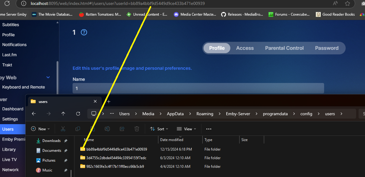

Happy2Play 9814 Posted December 17, 2024 Posted December 17, 2024 Possibly as it can be difficult to find the correct folder for the user as you may have to query the user in the api to actually find the correct folder if you have a log of user folders. But going to said user in Settings-Users-select user you will see the userid in the url and that corresponds to the user folder. But that one you just posts is configure for access Sunday, Monday and Tuesday 8am to 8pm <AccessSchedules> <AccessSchedule> <DayOfWeek>Sunday</DayOfWeek> <StartHour>6</StartHour> <EndHour>20</EndHour> </AccessSchedule> <AccessSchedule> <DayOfWeek>Monday</DayOfWeek> <StartHour>8</StartHour> <EndHour>20</EndHour> </AccessSchedule> <AccessSchedule> <DayOfWeek>Tuesday</DayOfWeek> <StartHour>8</StartHour> <EndHour>20</EndHour> </AccessSchedule> </AccessSchedules> So are you saying you get a error playing media right now?

sa2000 703 Posted December 20, 2024 Posted December 20, 2024 11 minutes ago, AaronClarke said: The issue has occurred again just now at 15:16 for 'Erin' UserID: 139064e0b71c4c62b7db7e9659e54cc8 That is legitimate - becuase the user is only allowed access on Sunday, Monday and Tuesday <AccessSchedules> <AccessSchedule> <DayOfWeek>Sunday</DayOfWeek> <StartHour>6</StartHour> <EndHour>20</EndHour> </AccessSchedule> <AccessSchedule> <DayOfWeek>Monday</DayOfWeek> <StartHour>8</StartHour> <EndHour>20</EndHour> </AccessSchedule> <AccessSchedule> <DayOfWeek>Tuesday</DayOfWeek> <StartHour>8</StartHour> <EndHour>20</EndHour> </AccessSchedule> </AccessSchedules>
