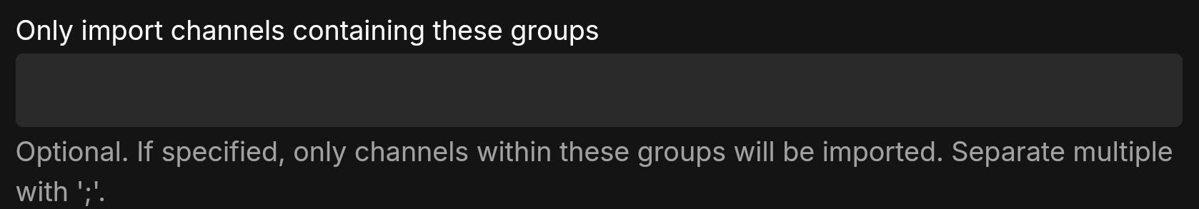

Carlo 4561 Posted November 14, 2024 Posted November 14, 2024 Have you explored the m3u tuner setup dialog? There is a field you can use to setup a list of groups to import, discarding other channels. I know Emby will read the group using the traditional method like: #EXTINF:-1 tvg-id="AAAA" tvg-name="AAAA HD tvg-logo="http://BLABLABLAUR.cx/logo/AAAA.png" group-title="Group A",AAAA HD http://BLABLABLAURL:8090/s/5e3e3bd7/channel-A-hd.m3u8 I've not seen/tested this using the extended M3U format as it seems almost universally IPTV providers are using the conventional group=title parameter. #EXTINF:0 group-title="Group1" tvg-id="Channel-A-hd" tvg-logo="http://BLABLABLAUR.app/streams/Channel-A-HD.png" tvg-rec="7",Channel A HD #EXTGRP:GroupA http://BLABLABLAURL:8090/s/5e3e3bd7/channel-A-hd.m3u8
ak2k5 0 Posted November 14, 2024 Author Posted November 14, 2024 12 minutes ago, Carlo said: Have you explored the m3u tuner setup dialog? There is a field you can use to setup a list of groups to import, discarding other channels. You mean this field? The field looks like group filter to let emby import channels from choosen groups only. The problem is emby could not get (and didn't display of process) any group information from the source.

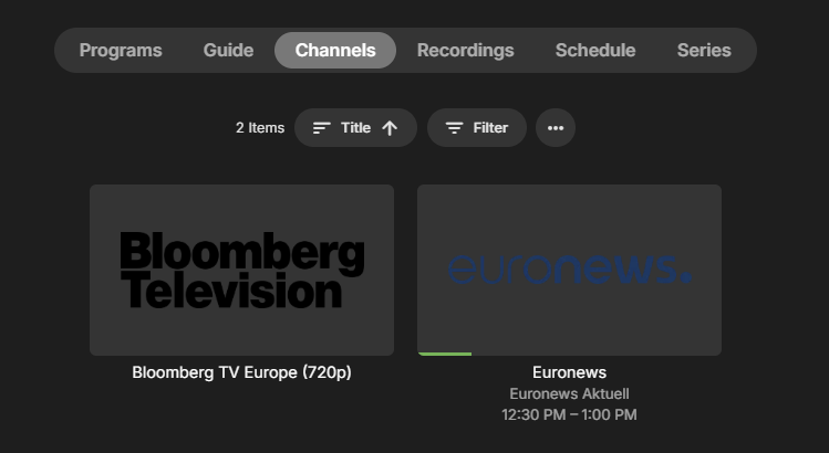

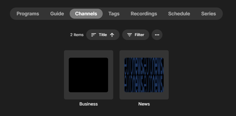

ak2k5 0 Posted November 18, 2024 Author Posted November 18, 2024 12 hours ago, Luke said: Never heard of ExtGrp. Anyway here's a build of the m3u plugin with some support added for it that you can test out. If it works out well enough then we can publish this. Thanks. It seems new plugin lost group support completely. Attached two m3u8 sample files. Original plugin with group-title: New plugin with group-title/#EXTGRP: digest.extgrp.m3u8 digest.group-title.m3u8

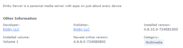

ak2k5 0 Posted November 23, 2024 Author Posted November 23, 2024 On 11/21/2024 at 11:20 PM, Luke said: It should add support for extgrp. Can you try it again? New version tuner throws an exception on reading any playlist. Information I forgot to add: EMBY server works on Synology. embyserver.txt

sa2000 695 Posted November 27, 2024 Posted November 27, 2024 2 hours ago, Luke said: Tested, no problem found. Can you try it again? here, for good measure: Thanks - worked ok with my 1 one channel test and I mapped the channel to a guide channel and all good. Thanks On 23/11/2024 at 15:56, ak2k5 said: New version tuner throws an exception on reading any playlist Hi Can you please try the updated Emby.M3UTuner dll above to check the fix for your group names 1
Carlo 4561 Posted November 27, 2024 Posted November 27, 2024 3 hours ago, Luke said: Tested, no problem found. Can you try it again? here, for good measure: Emby.M3UTuner.zip 46.05 kB · 0 downloads This worked for me as well loading the #EXTGRP 1 1
