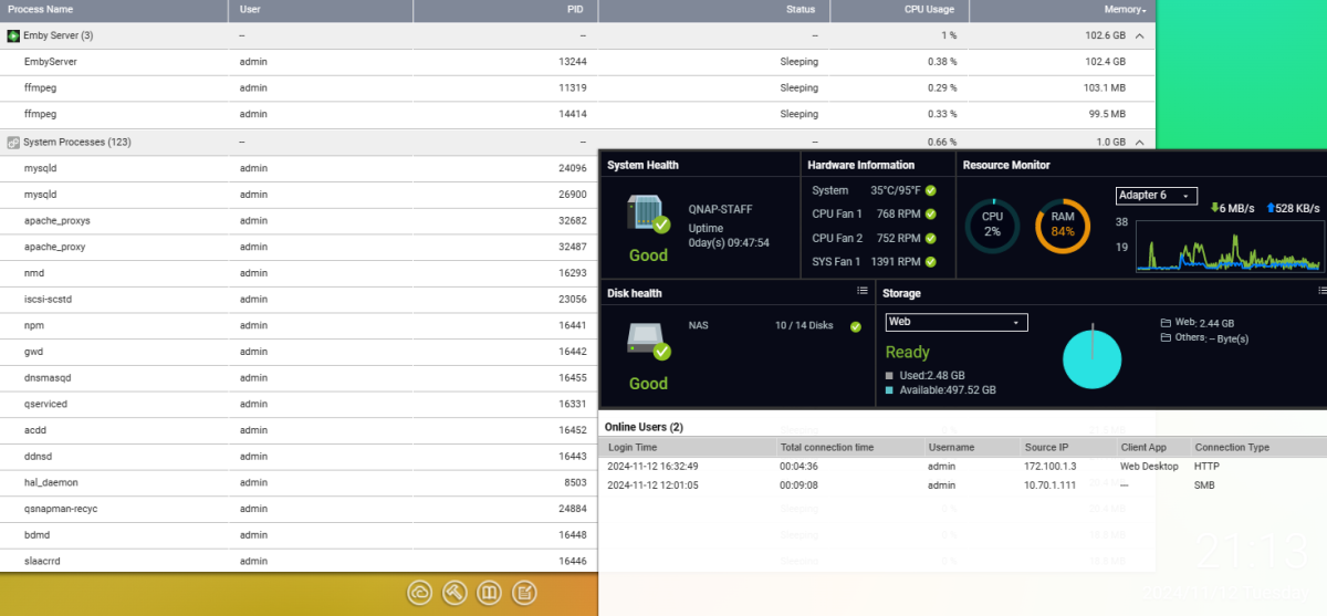

sezsat 1 Posted November 13, 2024 Author Posted November 13, 2024 (edited) Example of once instance where the Server is consuming too much memory with only 1 active playback. Note: Prior to this, we tested the server by playing movies on multiple desktop/mobile phones with transcoding. (About 8-10 devices) Edited November 13, 2024 by sezsat

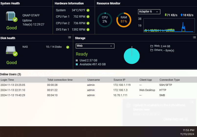

sezsat 1 Posted November 13, 2024 Author Posted November 13, 2024 Screenshot from QNAP NAS Resource Monitor after doing a test Test details: Number of simultaneous playback (all direct play): 10 Devices: 1 apple tv and 9 windows PC running Emby theater

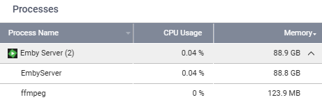

sezsat 1 Posted November 13, 2024 Author Posted November 13, 2024 (edited) Snapshot of QNAP NAS memory usage right after Emby server restart @sa2000 Edited November 13, 2024 by sezsat

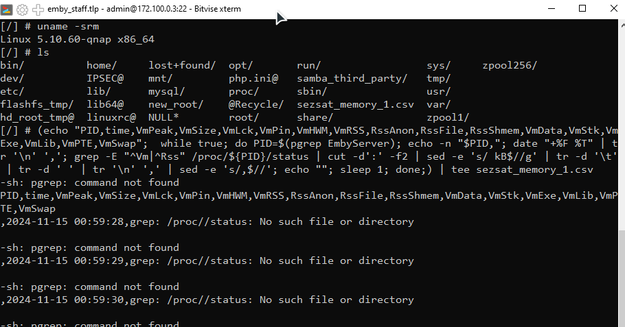

sezsat 1 Posted November 14, 2024 Author Posted November 14, 2024 Hi! we tried out the script however it looks like it does not recognized the pgrep command or we missed something? Linux version of QNAP is Linux 5.10.-qnap x86_64.
sa2000 696 Posted November 15, 2024 Posted November 15, 2024 There are some references about pgrep and QNAP - here mentioning need for installing "procps-ng" suite of command line tools. Is it something you can look into?
