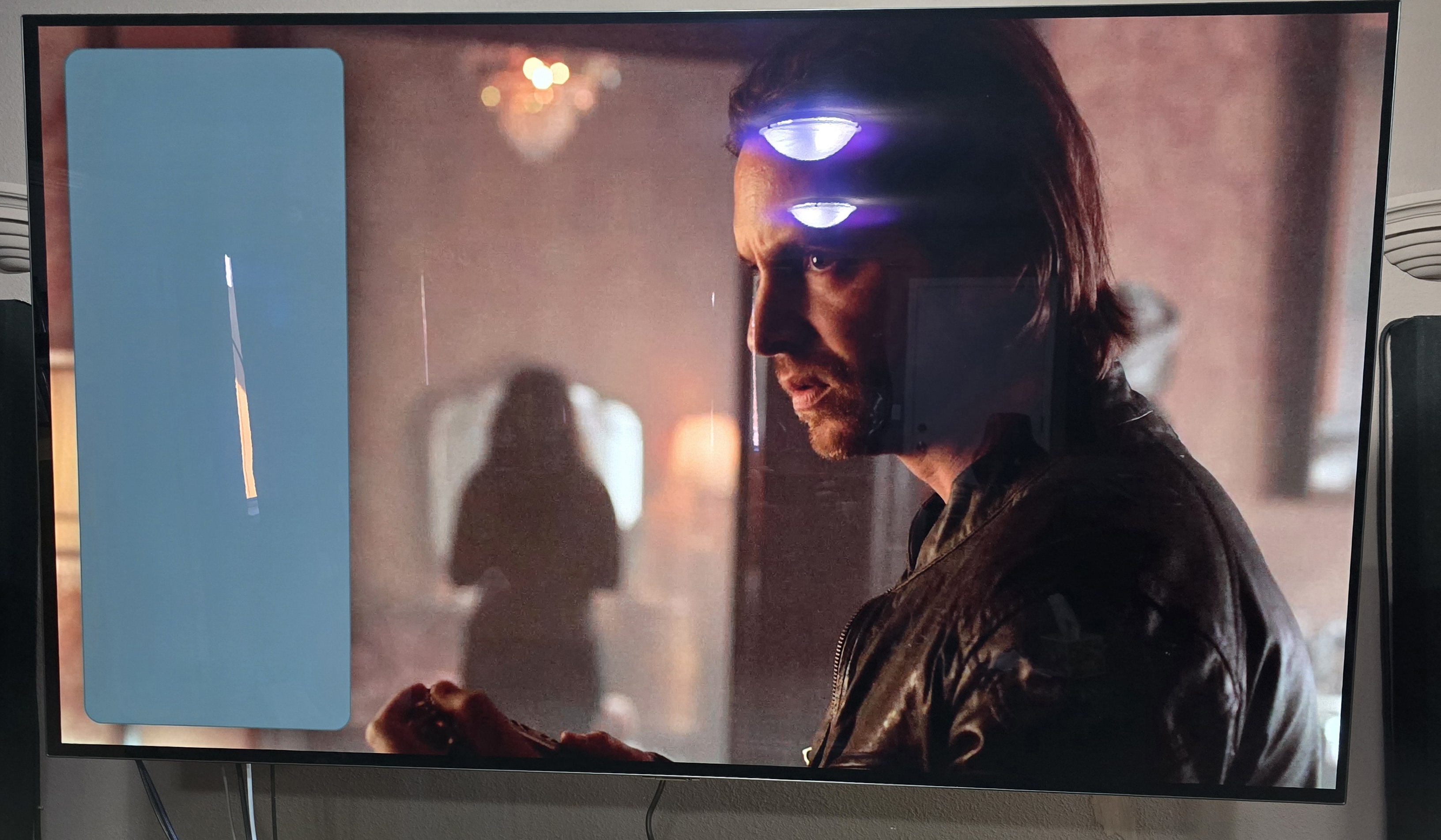

audiom3 12 Posted November 29, 2024 Author Posted November 29, 2024 (edited) @LukeI'll monitor the Fire Cube apps. But both apps are buggy as heck on the Shield. For Android TV... When I enable auto skip intros, a lot of times the video starts skipping/pausing after it skips the intro until I hit the back (rewind) button. Sometimes it still continues, so I have to hit it again to get the audio and video to sync. And even if I manually click the skip intro button, it happens. And then if I choose to disable both and try to FF the show, it will do the same thing. There is no way around this bug. For non-TV Android on the Shield. There is no way to exit the movie or show. Even though I have the back button performs a STOP, it doesn't do anything except bring up a blank grey banner on the left side of the screen. I just had to hold the back button to get out, the audio for the episode continued and a double tap of the circle button did nothing. So I had to go into apps and force close Emby. This is definately worse for me than the Android TV app that I've been using. Edited November 29, 2024 by audiom3
audiom3 12 Posted November 29, 2024 Author Posted November 29, 2024 (edited) This can easily be replicated by anyone by tapping the 'FF' button. If it works the first time and video plays as it should, just hit it again and you'll see the issue I'm talking about. This has been a bug since I signed up for Emby months ago. 20241129_132756.mp4 Edited November 29, 2024 by audiom3
