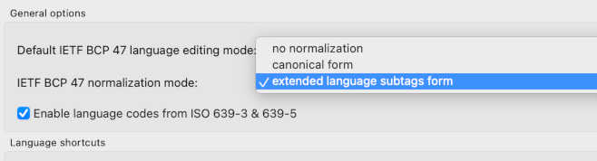

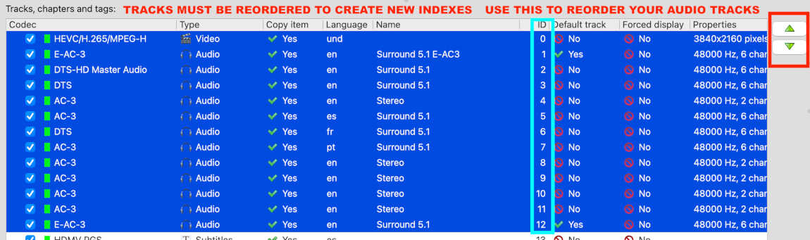

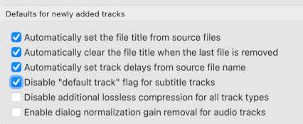

forenaite 8 Posted January 28, 2025 Author Posted January 28, 2025 (edited) I was able to get around this problem. The issue is related to the way some software assembles the internal IDs that exist to identify all the video components. As you already know, WebOS has a bug with this. I used MKVToolNix v89.0 64bit to reorder the audio tracks. That solved the problem for me. Here's what you need to do: Open your video in MkvtoolNix. Your tracks MUST be reordered to create new IDs. The default audio track should be the first in the list of available audio tracks. Also, make sure you select ONLY ONE default audio track. Configure MKVToolNix as in the attached images. After doing this process, the audio selection started working correctly on LG WebOS. It may be useful to add commentary to the audio track (I did). If you have problems selecting subtitles (it didn't happen to me, but I did it anyway), use the same process. Edited January 28, 2025 by forenaite
