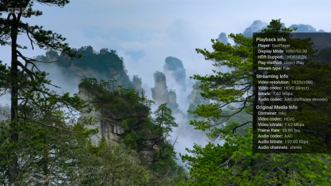

njiska 8 Posted November 9, 2024 Posted November 9, 2024 I've had this issue for a while now, and even with the latest beta, which notes SMB performance improvement, it's still happening. Basically, I have a few very high bitrate files (200+ Mbit/s) and while I can play them back directly from the network share using VLC or Kodi, using Emby on the same devices results in buffering and stutter. When using my primary Emby device, an Nvidia Shield Pro (2019), after a few seconds of playback Emby has to pause and buffer. With Kodi 21 on the same hardware, playback is smooth and without issue. On my laptop, using the Emby Windows Store app, the experience is the same, playback for a few seconds, then buffering. VLC and Kodi, play the file fine. In all tests the same file is being played from the same network share. I'm rather stumped. Environment Emby Server 4.9.0.31 running on DS1821+ with DSM 7.2.1 Update 5 Sample file: https://archive.org/details/g-2020 Client 1: Emby Android app on Nvidia Shield Pro (2019) Client 2: Emby Windows Store App (Windows 11, Dell XPS13) Transcoding has been disabled to force Directplay as the DiskStation can't realtime transcode this Everything is hardwired with CAT, except the laptop which is Wifi-6 embyserver (1).txt

njiska 8 Posted November 11, 2024 Author Posted November 11, 2024 @LukeI understand restricting access to transcoding may cause playback issues due to unsupported formats. That's not really the issue I am concerned about. I know these are supported files. I know ExoPLayer can decode them. I know the hardware can decode them. I can say this confidently because: I only disabled transcoding as part of troubleshooting to make sure the player was trying to play the native files for consistency when testing against playing the native files on the same devices with alternative media players. If I allow Emby to transcode when it wants to, it still doesn't try to transcode the file on my Nvidia Shield Pro (2019) and the same playback problems occur until it fails over to transcoding. Here's a video of what happens. My account is set to allow transcoding. The Emby App is set to allow a max bitrate of 1000 Mbit/sec. The client is connected to CAT6 as is the NAS the file is hosted on. Every port in the chain is a gigabit port. Following along with Stats for Nerd you can see it eventually decides to switch to transcoding due to a DirectPlay error. It honestly looks like like decoding is working fine, but the player isn't getting fed data over the network fast enough. A few times the player has just crashed. Test with Emby: 20241111_110346.mp4 Test with Kodi: 20241111_094956.mp4embyserver (2).txt

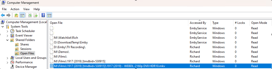

rbjtech 5417 Posted November 11, 2024 Posted November 11, 2024 (edited) The fundamental different between VLC/Kodi and the emby clients(*) - is they are playing direct via SMB, Emby is not - it is 'streaming' via HTTP via the Emby Server. This extra 'layer' adds latency and is likely the primary cause of your stuttering - especially at those bitrates. It's not the network capacity per se - but it is the emby stack/network combo. NAS > SMB > VLC/Kodi NAS > SMB > Emby Server > HTTP > Emby Client This is the difference. (*) The only clients that have the ability to play directly (via SMB) - Is the Emby Theatre - when you have setup the 'optional' SMB file path in your libraries (and have it working) OR the AndroidTV Emby Client running on an older version of Android - that allows the same Direct SMB playback. (which I use as my mainstream 4K remux playback client). NAS > SMB > Emby Client (in SMB Direct File Mode) Why Emby have removed this ability from their other mainstream clients I have no idea - but in the many years of using emby, it is the only guaranteed way to have faultness/fast responsive 4K+ high bitrate playback (100-120Mbit/sec or + if the client can handle it) imho. Edited November 11, 2024 by rbjtech 1

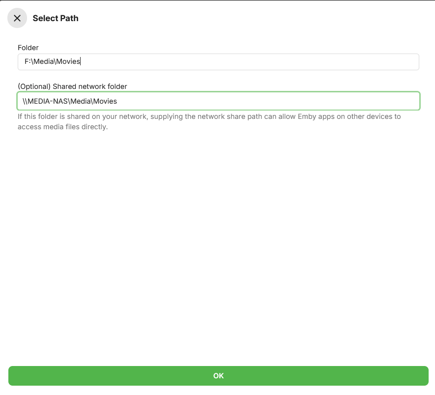

njiska 8 Posted November 11, 2024 Author Posted November 11, 2024 (edited) Thanks @Carlo @rbjtech, that's the kind of detail I was looking for. Emby Server is also running on the NAS and accessing media via a local filepath, so in this case it would be Btrfs > Emby Server > HTTP > Emby client, but that's still a different protocol/stack than the SMB path and explains what I'm seeing. I can try giving direct paths a go and see how that performs. I've used the alternate path option before when playing direct using the Emby add-on for Kodi, so that should be a viable alternative. There's nothing in my media archive that the Shield can't natively decode, so losing transcoding is a fair trade off. As for the Emby Windows Store App, I only used that to test an alternate client, my media setup is built around Nvidia Shields. Three of them in use so far. I wish a newer, more powerful Android box would exist, but alas, that remains a pipe dream. Edited November 11, 2024 by njiska
njiska 8 Posted November 11, 2024 Author Posted November 11, 2024 This was a journey. Setup Android Attached Storage as required. Apparently it resolves the hostname, so I had to update my alternate paths that were configured using the IP address. Went to setup direct paths and discovered it requires an External Player because the Shield is running Android 11. Ok, downloaded VLC for Android. Tried to play a file and it failed immediately. Searched the forums and found someone else with this issue from 2022. Downloaded MX player and now I get a popup option to use VLC or MX Player. VLC plays the file fine as an external player. I guess I have a solution, but this is not ideal. Part of the reason why I moved from using Kodi with the Emby Addon to using Emby directly was to simplify the experience and have an easy ability to resume playback across multiple devices. Now, at least for high bitrate files, I have to jump through hoops again. If there's a known limitation to what Emby server can stream via HTTP, than why can I set the max supported bitrate above it in the client? Similarly, if Direct File playback is the solution, then why isn't there a native option to load the file with ExoPlayer? I understand this would still require mounting as Attached Storage as ExoPLayer doesn't natively support SMB, but at least that would still be playback directly in Emby with the Emby UI. Still, appreciate all the help. I'll probably just switch on direct paths when I need it and leave it disabled the rest of the time.

rbjtech 5417 Posted November 12, 2024 Posted November 12, 2024 (edited) 10 hours ago, njiska said: This was a journey. Setup Android Attached Storage as required. Apparently it resolves the hostname, so I had to update my alternate paths that were configured using the IP address. Went to setup direct paths and discovered it requires an External Player because the Shield is running Android 11. Ok, downloaded VLC for Android. Tried to play a file and it failed immediately. Searched the forums and found someone else with this issue from 2022. Downloaded MX player and now I get a popup option to use VLC or MX Player. VLC plays the file fine as an external player. I guess I have a solution, but this is not ideal. Part of the reason why I moved from using Kodi with the Emby Addon to using Emby directly was to simplify the experience and have an easy ability to resume playback across multiple devices. Now, at least for high bitrate files, I have to jump through hoops again. If there's a known limitation to what Emby server can stream via HTTP, than why can I set the max supported bitrate above it in the client? Similarly, if Direct File playback is the solution, then why isn't there a native option to load the file with ExoPlayer? I understand this would still require mounting as Attached Storage as ExoPLayer doesn't natively support SMB, but at least that would still be playback directly in Emby with the Emby UI. Still, appreciate all the help. I'll probably just switch on direct paths when I need it and leave it disabled the rest of the time. Using the Shield / Emby AndroidTV client with it's current OS (Android 11/Shield Experience 9), Emby have made the concious decision to not allow SMB (for direct play). They say it's because you then need to give permissions on Android to allow access and that changes what they need to say in the store... (weak excuse imo - or just have a sideload version that works..). To get it to work, you need to downgrade the OS to Android 9/Shield Experience 8.2.2. Then you can mount the storage and it work properly. When working - you will see the stream type as 'File' in SFN. Considering AndroidTV will soon be unsupported anyway - being replaced by the currently functionally inferior Android Client (with No SMB support full stop), then the choice of using Emby Clients (and ultimately Emby itself) for high end playback will be coming to an end. Edited November 12, 2024 by rbjtech
