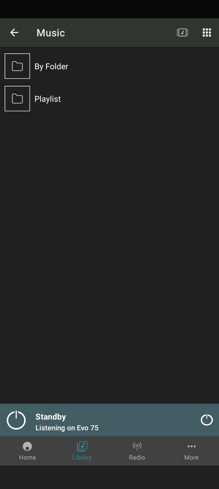

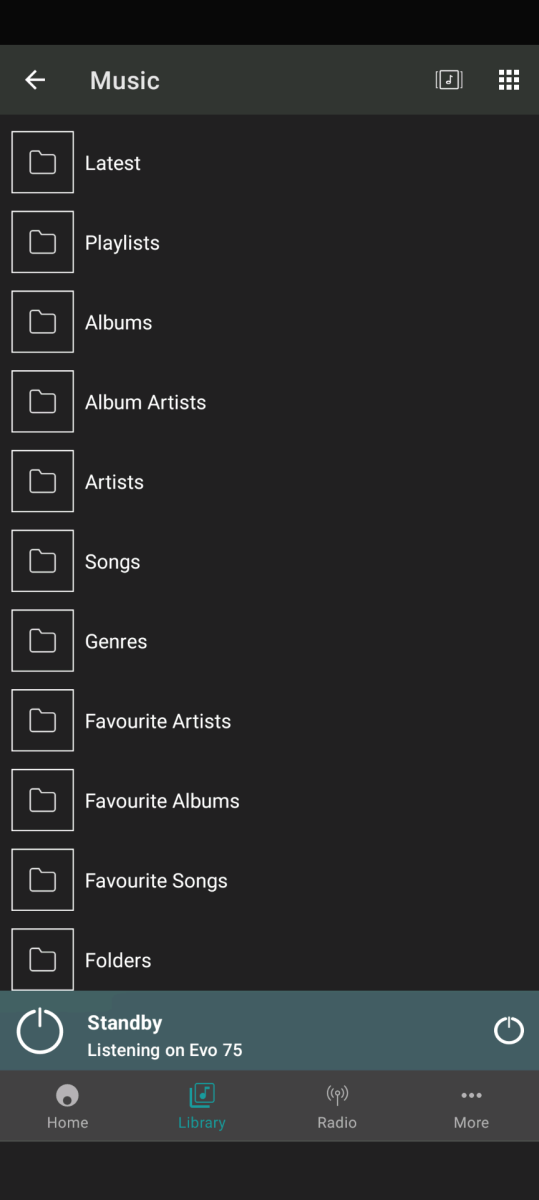

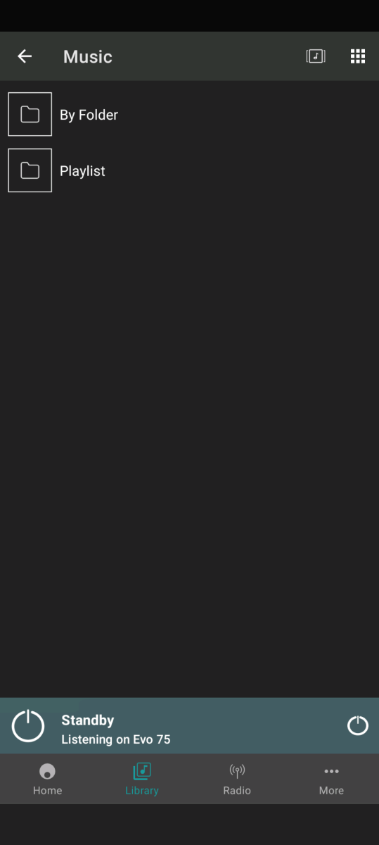

freemansteve 8 Posted November 9, 2024 Posted November 9, 2024 Hi - after a pause, I thought I'd try Emby again on my NAS, to see what's changed.... Specifically, the beta - emby-server-synology72_4.9.0.31_x86_64.spk I'm running DLNA, and just testing it on my very large music collection. N.B. All files in very structured folders and perfectly done tags and cover art. I have looked quite hard, but I still don't understand how to change virtual folders or database views that appear in the control app for my playback device..... The first pic shows what I want to see (Synology Media Server "view"), but the second pics shows masses of clutter that I'd like to suppress (Emby).... How do I configure to simplify the views?

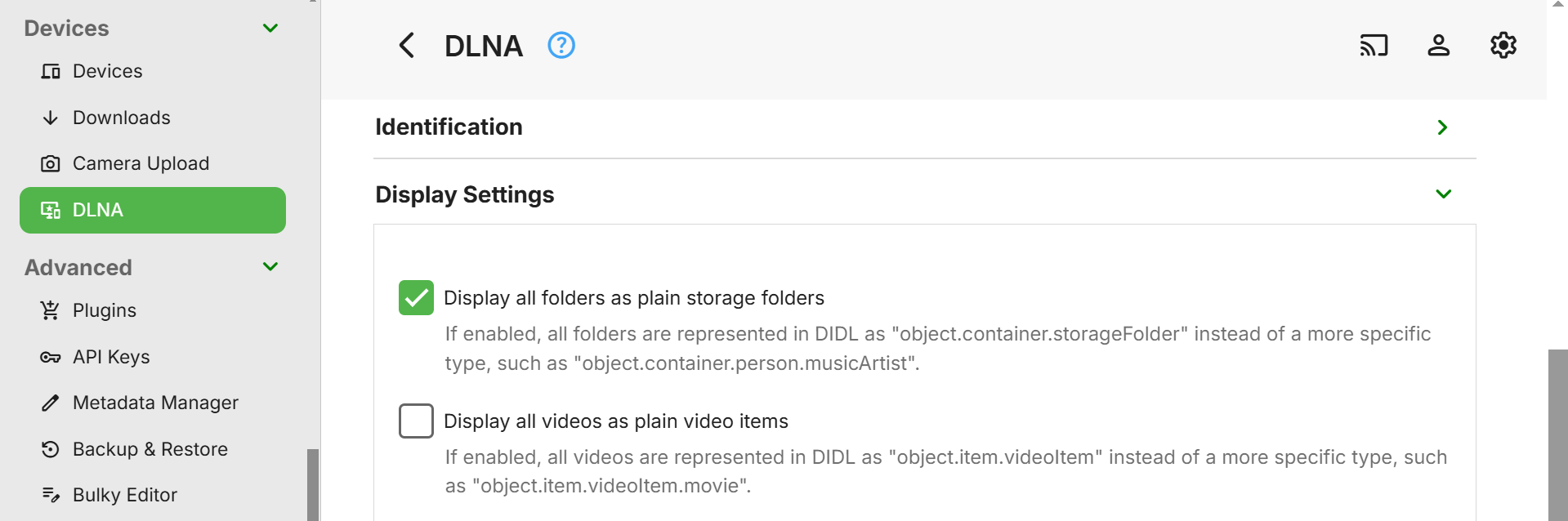

user24 349 Posted November 9, 2024 Posted November 9, 2024 Hi, Have you tried looking at DLNA Custom Profiles and the Plain Storage Folders option? I don't know anything about setting it up myself, so not sure if it will help? Others may know more. However, if this is feasible, you could end up with the Emby view being the exact same info as your current Synology view??? 1
freemansteve 8 Posted November 9, 2024 Author Posted November 9, 2024 (edited) I just found the page you mention, but ticking the box "Display all folders etc....." doesn't seem to work on my version. I "save" the settings but they are lost when I go back to check, and the virtual folders I see on my controller are unchanged. It really should not be that obfuscated for simple and obvious settings! My other problem is the same as I found with the previous few betas - Emby is horrendously slow when I'm trying to view playlists - I mean like a blank screen for 15 seconds, which makes it kind of unusable for me. I did try an earlier full release version which was OK, response-wise. I reported all this before, but nothing has improved AFAICT - I think the whole structure of Emby may need a rethink - it's currently not really suitable for large audio collections, even when I run it on a fast PC (my NAS is pretty nippy in all other respects). UMS on the same PC is massively faster and much easier, but I just can't get it to work using Docker on my NAS! Edited November 9, 2024 by freemansteve
user24 349 Posted November 9, 2024 Posted November 9, 2024 Oh well, perhaps someone else will know...! (It could be much more involved than just ticking the box.) Anyway, I don't have any problems with Emby DLNA and Playlists with a music library with 100k+ tracks. (I know there are some ongoing problems, reported by many, related to Genres playback that are being looked at though.) I possibly have a comparable setup (Naim though, not Cambridge Audio). I keep the audio library currently on a Synology DS218+ BUT have the Emby Server on a laptop PC. The Naim app gives the exact same folder views as you are seeing on the Evo app, so its likely derived from Emby? I don't like the Naim app at all, so just use the Emby web app and DLNA cast direct to my Naim devices. (The various music views/browsing is far superior to Naim.) It seems like you may have already tried doing something similar? Maybe it's just the Synology version of Emby that is slow???

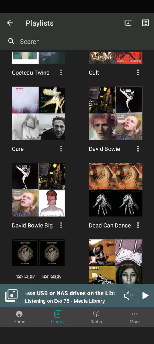

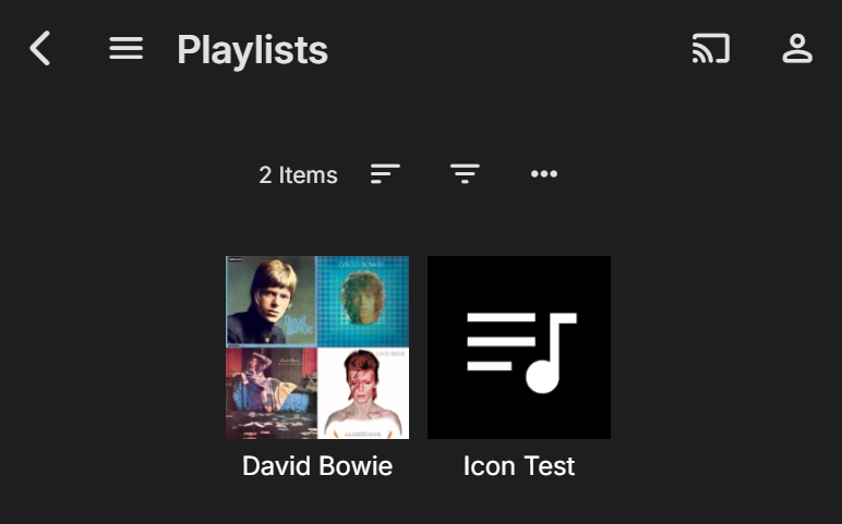

user24 349 Posted November 11, 2024 Posted November 11, 2024 (edited) 1 hour ago, freemansteve said: I don't understand when you say "I don't use the Emby-generated 'composite graphic' images for anything". To be clear, I'm referring to the pictures that appear against playlists (see pic below from the StreamMagic app) that are made of 4 separate images from various album art, but if you know of a way to turn these off, that would be excellent! I'm happy with just text names for playlists, but I did read that you can include a reference in the playlist files to a specific image file. I did play with this a while back, but if I recall, it was non-standard (although .m3u files are non-standardized) and caused issues on other players - as I said, I like to have one set of playlists that are portable for all players and all systems. It would not be too hard for me to process 250 *.m3u's using a batch file, but even easier if Emby themselves made some sensible changes! I don't think you can "turn these off" directly (I could be wrong though?), but you can add your own custom images. Something like this then... David Bowie Playlist is standard auto-generated composite image Icon Test Playlist is non-standard custom-created icon image You can add the custom images as follows: three dot menu bottom RHS of playlist image > Edit Images > Primary > three dot menu > Select Image File > Browse I guess you will be able to easily find it and there may likely also be other paths to get to it. If you look here: https://fonts.google.com/icons there are plenty of icons (e.g. search for "playlist") to find one you like that will match Emby/CA style, and any other apps that get their icons from here. You could set all of your 250 playlists exactly the same if you wanted to? You can apply the same customisation idea anywhere the composite images appear. Here's a non-playlist example from my current Emby UI: Getting back to the playlists... the custom images are stored in the Emby Server database (for my setup) here: C:\Users\user24\AppData\Roaming\Emby-Server\programdata\data\userplaylists\Icon Test [playlist] That might be enough to get you started??? I'll try to reply to some of your other comments a bit later when I have more time... Cheers! Edited November 11, 2024 by user24 added playlist icons image 1
