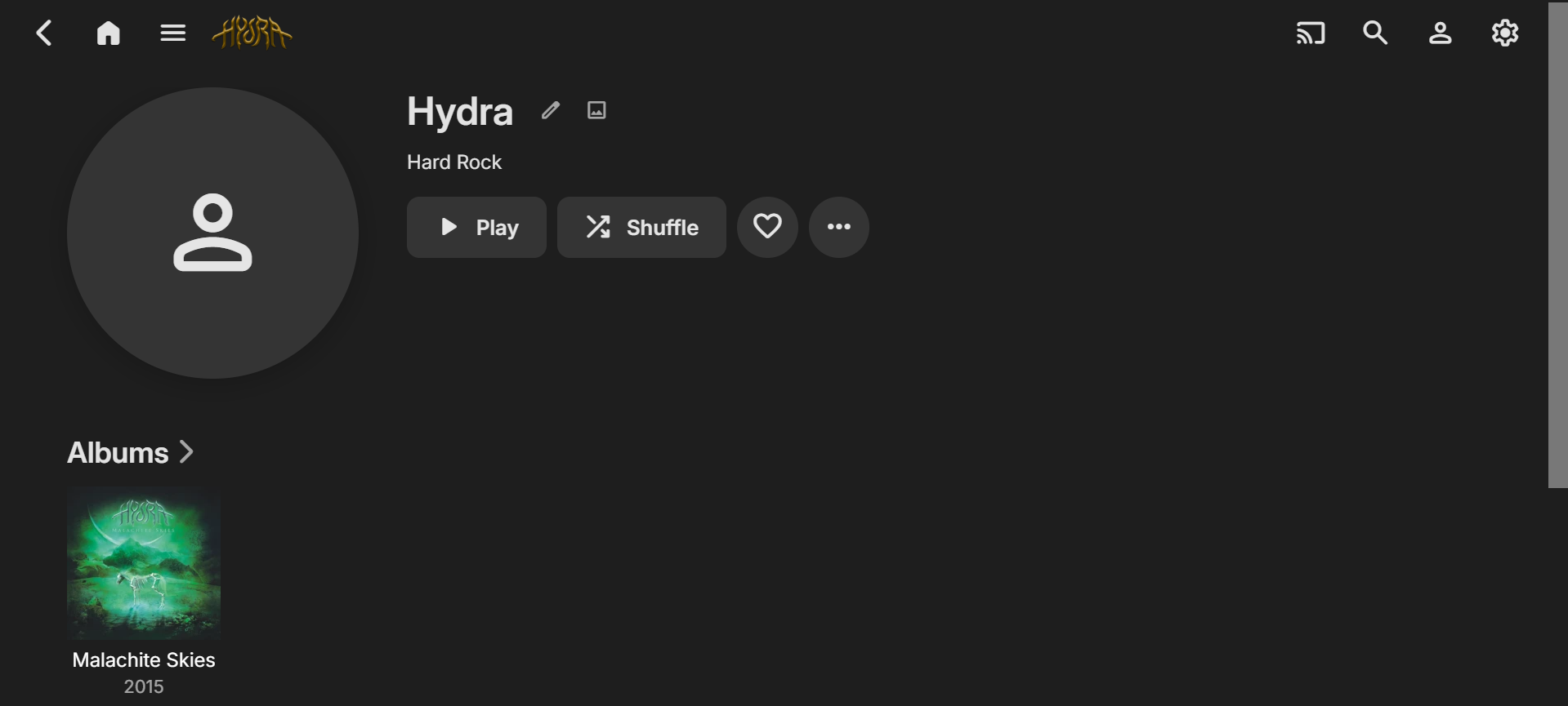

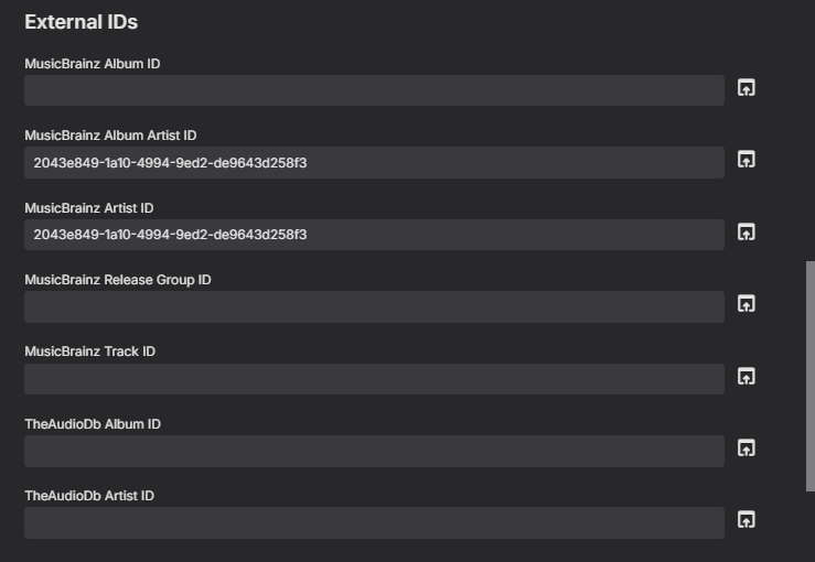

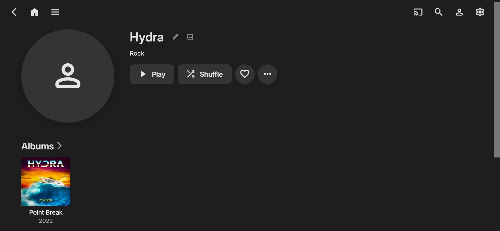

user24 330 Posted November 9, 2024 Posted November 9, 2024 (edited) Hi, I think you could be nearly there with setting up the MusicBrainz info to get the result you need... As well as setting the MusicBrainz ID for both the Artists and the Album, you might also need to check/set it for the individual Songs? I did a very quick test by downloading 1 track of 1 Album for each of your Artists and used your MusicBrainz IDs (I added the IDs in Mp3tag) and imported into Emby). In my library directory I also had separate folders for the two Hydra Artists. The initial result was the correct two separate Hydra Album Artists with 1 Album each BUT I ended up with 3 Hydra Artists! With further investigating I found that there were TWO MusicBrainz Artist IDs within Emby at the song level (The Artist one was blank causing the error I was seeing). Also, if BOTH are BLANK at a SONG level you will only get one Artist and one Album Artist, even if you have the correct info in the Emby Artist metadata. While I didn't fully configure all of the images and other info, I was then able to get the proper Album Artist and Artist separation with my test. So, perhaps check the MusicBrainz IDs on the individual tracks (if you haven't already). If you have nothing in these fields, or only one is used, then Emby may still be combining the Artists??? If you then are still having problems, please post some more details with screenshots of your metadata within Emby that might give some more clues to figuring out the issue. Cheers! Edited November 9, 2024 by user24 2
tsunami1701 6 Posted November 9, 2024 Author Posted November 9, 2024 I added artist and album artist id to song level and worked Thank you!! 1
