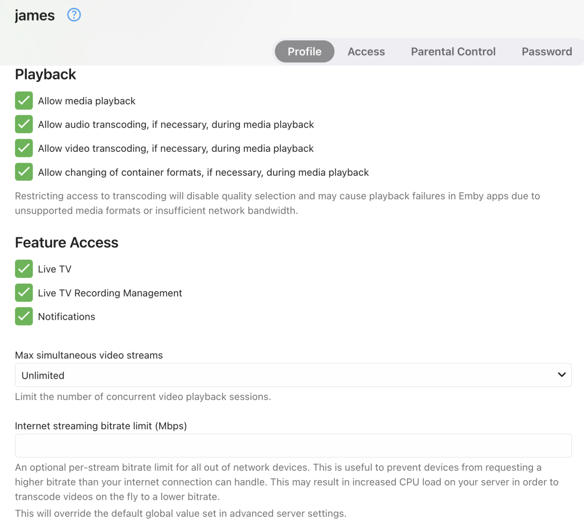

Iquaba 0 Posted November 14, 2024 Author Posted November 14, 2024 Thanks for offering to help. Here is my log file. embyserver (4).txt The lines that look relevant are: 2024-11-13 20:22:48.875 Info App: User policy for james. EnablePlaybackRemuxing: True EnableVideoPlaybackTranscoding: True EnableAudioPlaybackTranscoding: True 2024-11-13 20:22:48.875 Info App: Bitrate exceeds DirectPlay limit: media bitrate: 12758562, max bitrate: 400000 2024-11-13 20:22:48.875 Info App: Bitrate exceeds DirectStream limit: media bitrate: 12758562, max bitrate: 400000 I checked and all the transcoding permissions are allowed on my user. The user is also not limited in quality. embyserver (4).txt

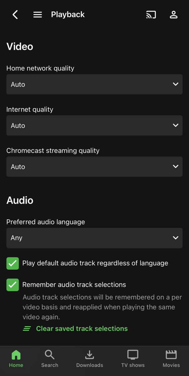

Neminem 1623 Posted November 14, 2024 Posted November 14, 2024 (edited) Try setting a higher bitrate in the client app. auto settings is a pita, and defaults to 4 mbit. So with this media file you need to set it to 13 mbit Edited November 14, 2024 by Neminem
Luke 42240 Posted November 17, 2024 Posted November 17, 2024 @Iquabahas this helped? It appears you may have set a really low quality setting in the client app.
Iquaba 0 Posted November 17, 2024 Author Posted November 17, 2024 (edited) Both the iPhone 12 (working) and the 16 (not working) have the default playback settings in the app. I discovered that when I disconnect from my home network and connect externally via Tailscale, playback starts working on the 16 No matter what playback settings I’ve tried, I still can’t seem to get some videos to playback on the 16 even though they work everywhere else Are these the settings I should be messing with? I’ve tried setting all three to 144p, 10 Mbps, and 200 Mbps Edited November 17, 2024 by Iquaba
