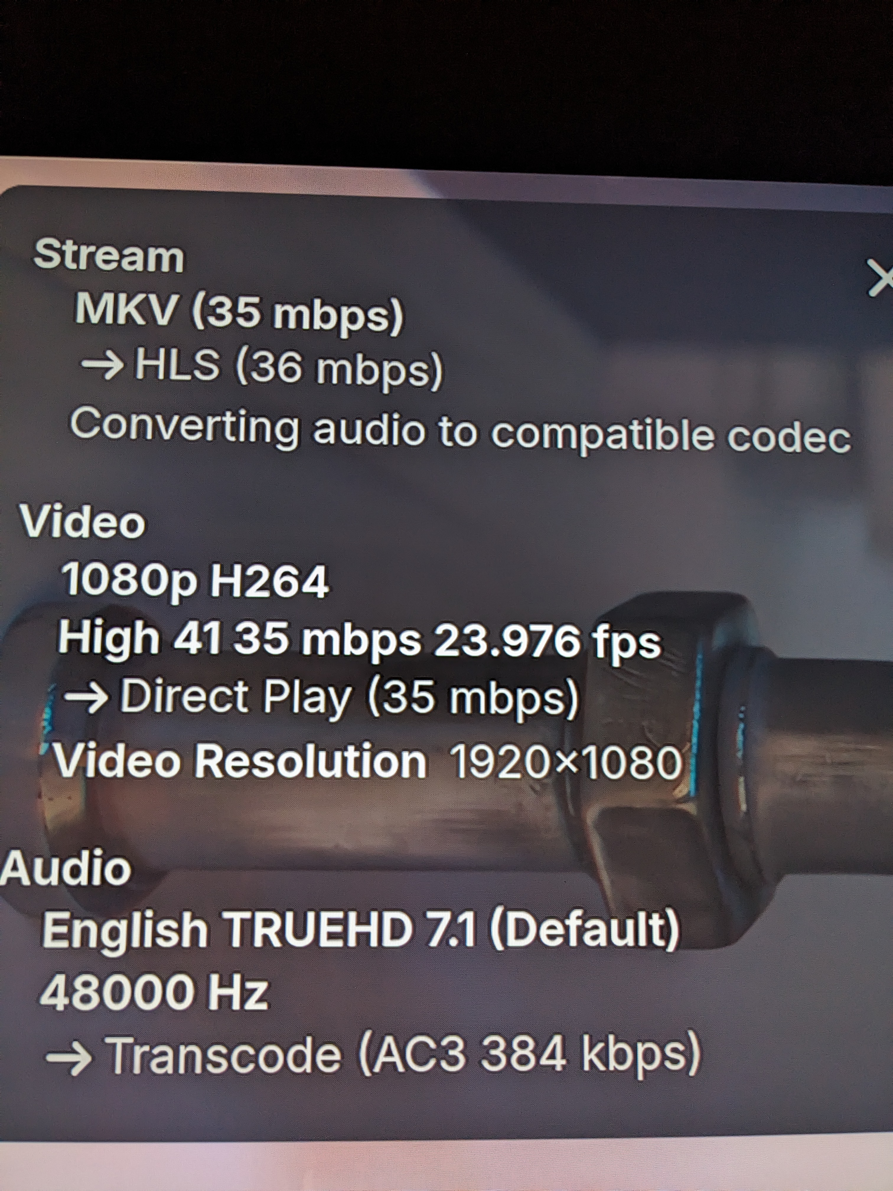

Schwongs 2 Posted December 11, 2024 Author Posted December 11, 2024 Hey Luke, I reran the movie and pulled up Stats for Nerds, the video is direct playing and the audio is transcoding. The system appears to be functioning as intended, I think my issue was entirely self-inflicted... I attached a screenshot of the stats for nerds, if you would still like a copy of ffmpeg and remux logs I can pull them when I get home but I don't want to waste anymore of your time on what appears to be user error lol. Thanks again! 2
