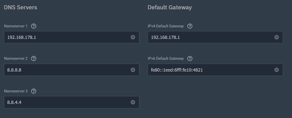

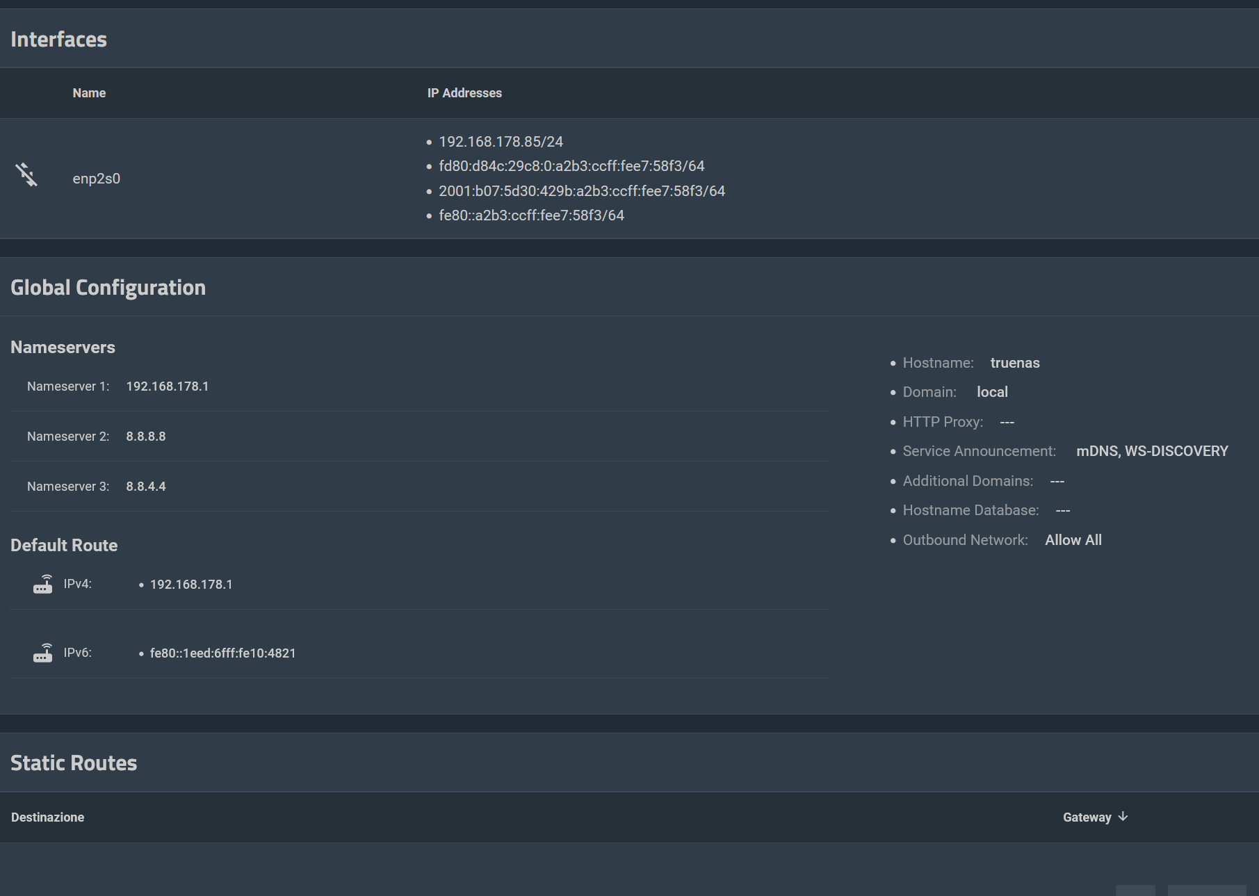

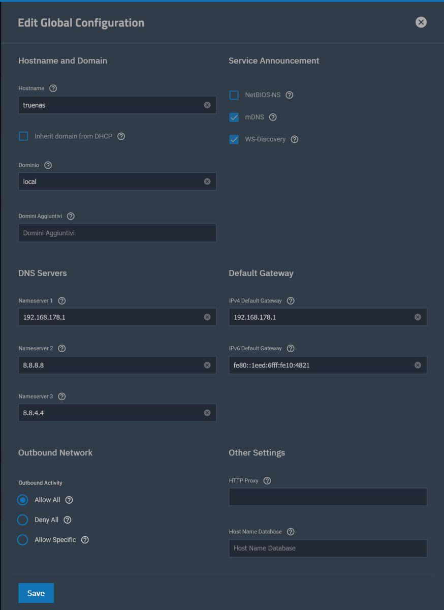

Serverhome.it 0 Posted November 7, 2024 Author Posted November 7, 2024 I tried to delete the string on ipv6 and directly restarted the NAS but nothing
Luke 42183 Posted November 7, 2024 Posted November 7, 2024 2 hours ago, Serverhome.it said: I tried to delete the string on ipv6 and directly restarted the NAS but nothing What exactly did you do? What does it look like now?
Serverhome.it 0 Posted November 8, 2024 Author Posted November 8, 2024 I deleted ipv6 as suggested, but when I restart the NAS it puts it back
Serverhome.it 0 Posted November 8, 2024 Author Posted November 8, 2024 (edited) Edited November 8, 2024 by Serverhome.it
ebr 16306 Posted November 8, 2024 Posted November 8, 2024 Hi. What he was suggesting was disabling IPv6 support on the network adapter. I also don't know that this will have any impact but I guess it is worth a shot.

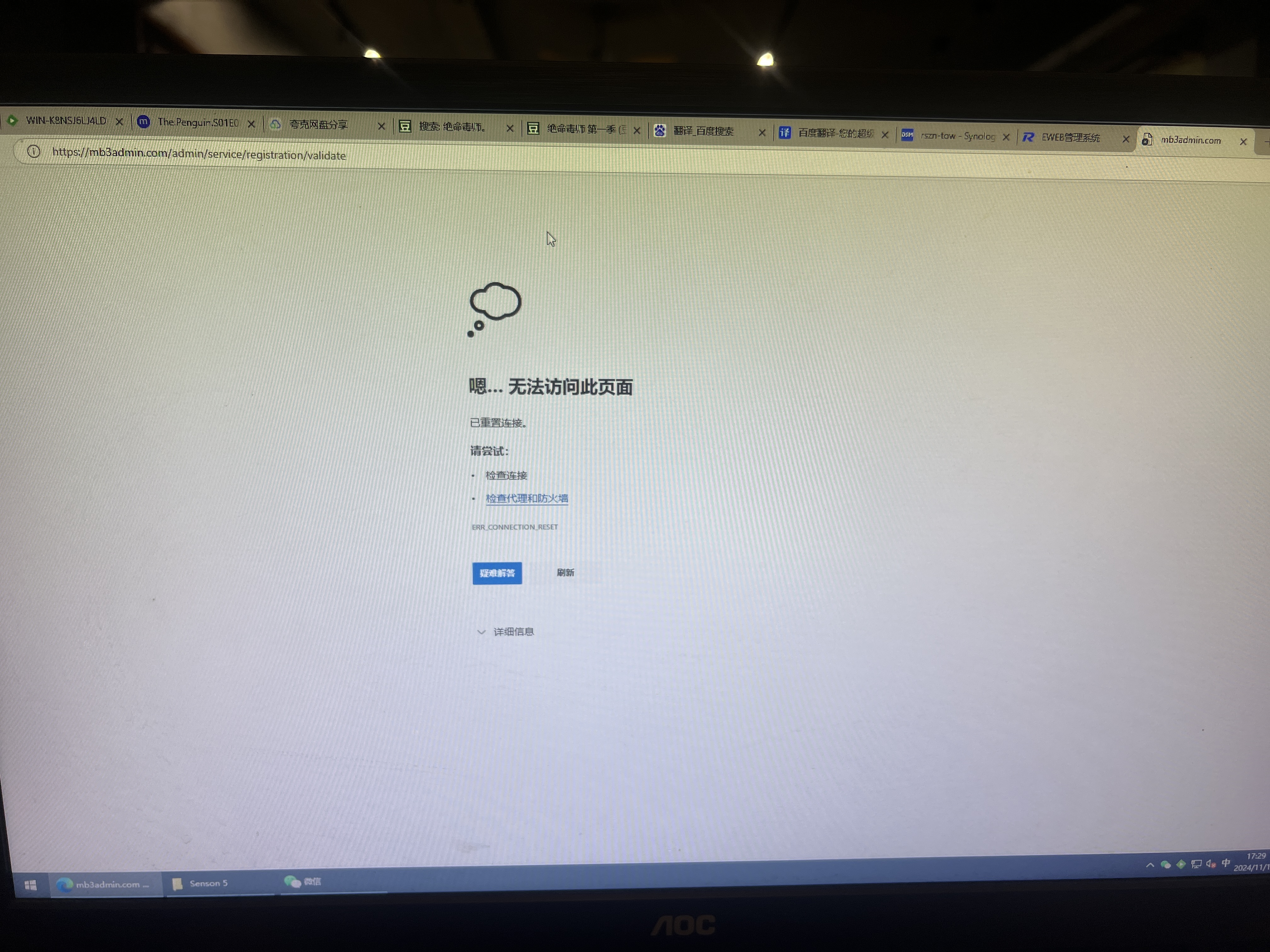

296926581 0 Posted November 10, 2024 Posted November 10, 2024 Disabled IPV6, the same problem, I use in China, could it be the firewall problem
Serverhome.it 0 Posted November 11, 2024 Author Posted November 11, 2024 I gave up, I tried them all, I'm just sorry I wasted money on the subscription
296926581 0 Posted November 11, 2024 Posted November 11, 2024 I have two lines of network operators here, one line can be authenticated, the other line can not be authenticated, I think the network operator's firewall organized the license authentication, the use of VPN authentication can be successful.

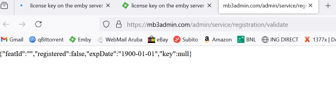

rbjtech 5335 Posted November 11, 2024 Posted November 11, 2024 @Neminemhas already given the reason earlier in the thread. https://mb3admin.com/admin/service/registration/validate By simply running the above http request in your browser with the same network/access as the emby server - does it come back with something like {"featId":"","registered":false,"expDate":"1900-01-01","key":null} or no response. If no response, then that is why it is not working and is caused by your local network/setup, emby is not at fault here.
rbjtech 5335 Posted November 11, 2024 Posted November 11, 2024 14 minutes ago, Serverhome.it said: ok - and you have done this from the trunas server ? there is no point in doing that on your own desktop browser as that is not where the access request is coming from. you may need to use a command line utility from the tru nas admin console - maybe curl or something like that. (if it has a browser, then great - I'm not familiar with the tru nas OS)
ebr 16306 Posted November 11, 2024 Posted November 11, 2024 51 minutes ago, Serverhome.it said: I can see your key has not successfully validated so something is blocking. The browser test can only tell you if something outside your network is blocking. Firewall rules are process-specific so it is likely your firewall blocking the server process.
