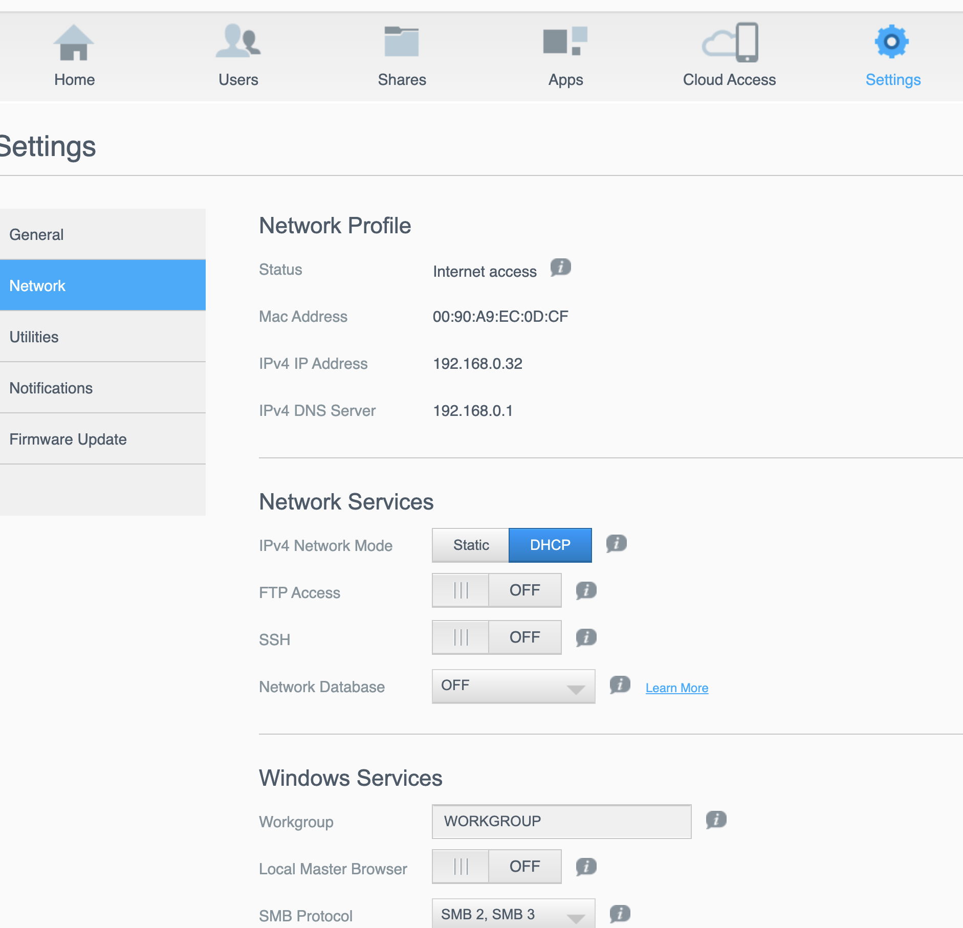

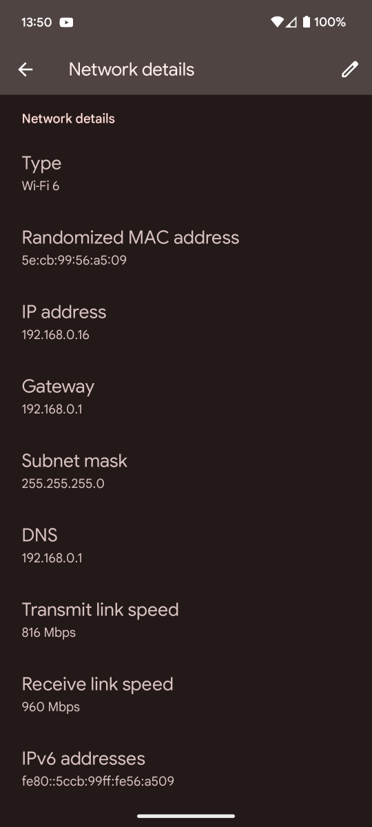

runninboy4 0 Posted November 7, 2024 Author Posted November 7, 2024 Thank you for giving me some information. Both these devices are on the same network, but the IPv4 IP address is slightly different for the mycloud drive. Here are some screenshots. I will try the manual way now.
sa2000 695 Posted November 7, 2024 Posted November 7, 2024 OK so both on the 192.168.0.x subnet On the android phone can you launch the Emby App and select "Add Server" and enter 192.168.0.32 as the host and in the port field it will be 8096 and then click connect
