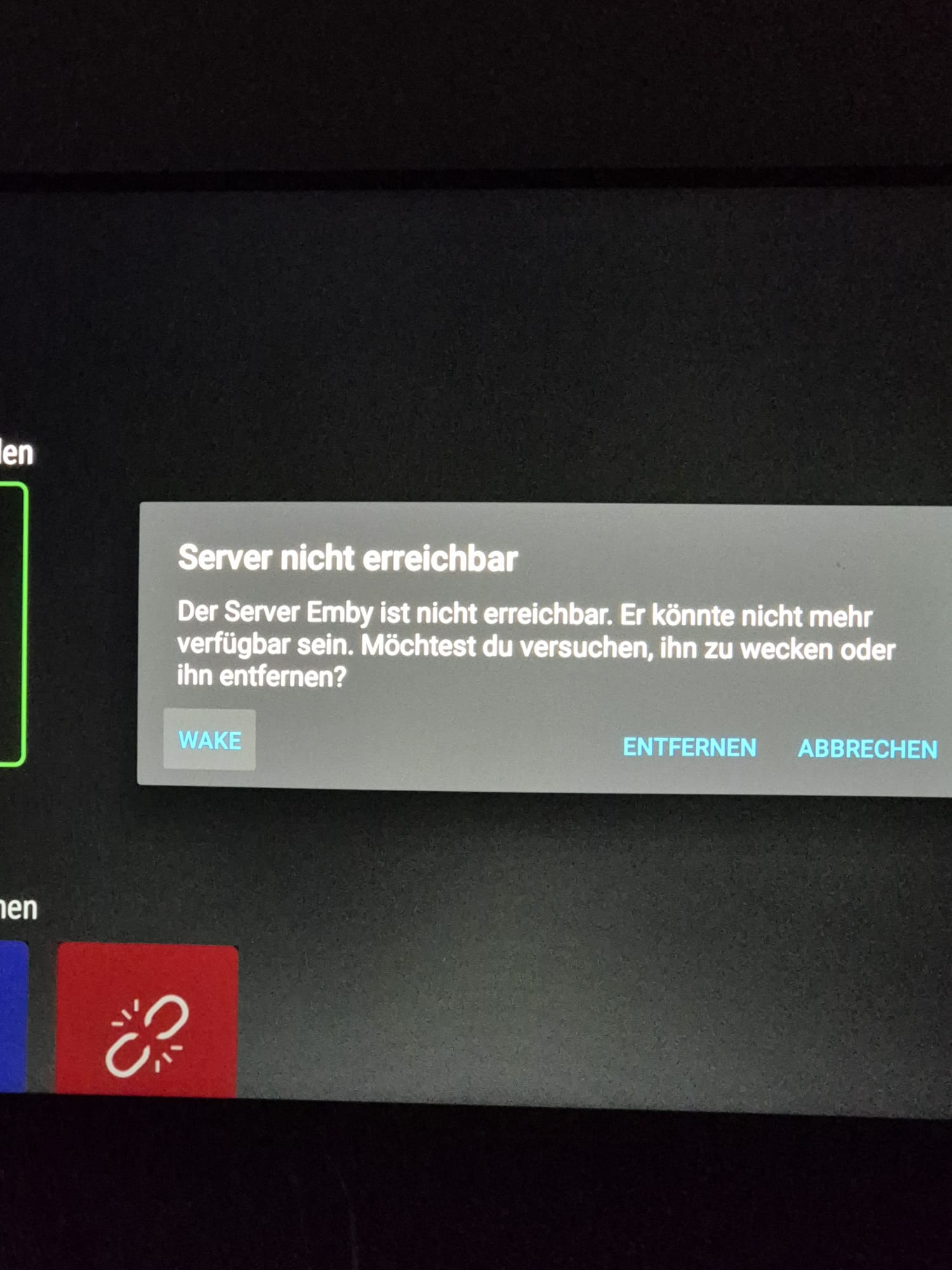

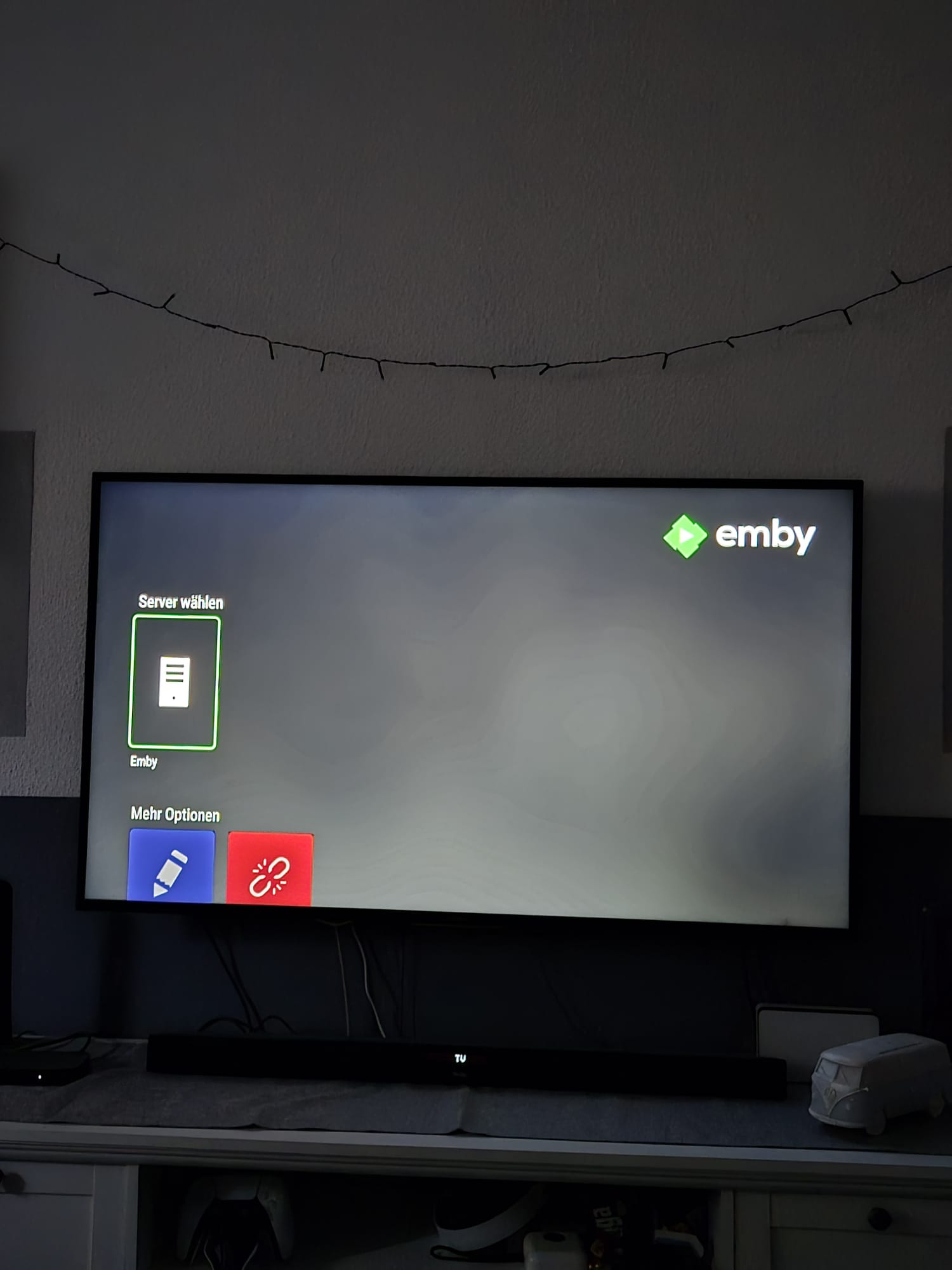

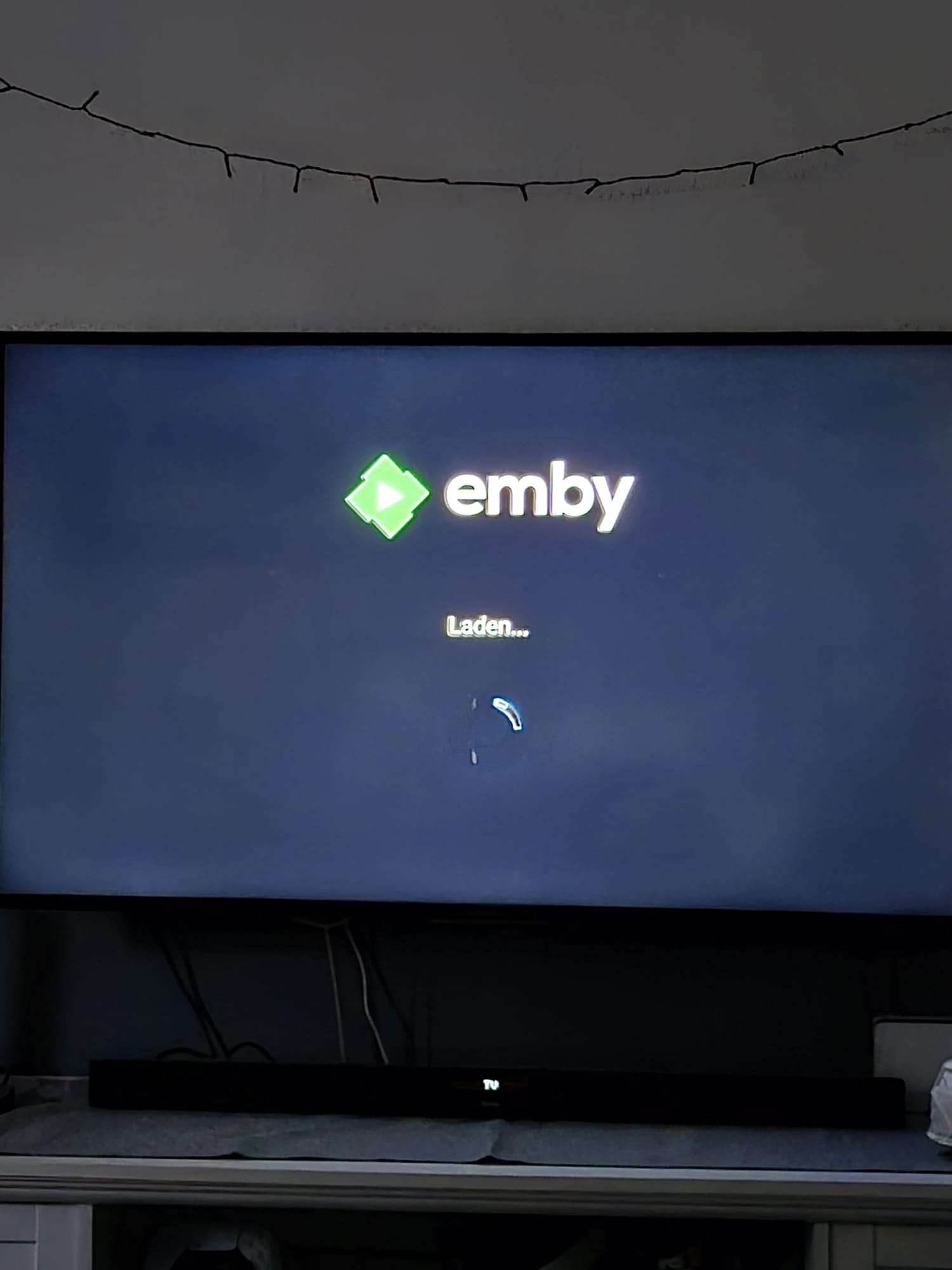

frylich 9 Posted November 5, 2024 Posted November 5, 2024 Hello dear emby team & community, One of the external users of my Emby server has a strange problem: It is possible to establish a connection to the server via LTE with a cell phone without any problems, but as soon as a connection from the same cell phone is to be established via WLAN, a connection to the server is not possible anymore. The same thing happens with other devices (notebook or firetv) on the same network. Now to my question: Can one of you please give useful tips as to what this could be? I look forward to your ideas. Thank you

frylich 9 Posted November 5, 2024 Author Posted November 5, 2024 (edited) Hello Happy the server: qnap nas the user: android, or windows, or whatever, doesnt matter everey other user has no issues maybe firewall, but which one? the user firewall? he got none, maybe the router or is it possible that the isp is blocking emby? thanks Edited November 5, 2024 by frylich

frylich 9 Posted November 6, 2024 Author Posted November 6, 2024 Hello master chief of bazinga Below are a few screenshots from the user and the server. Would the server log be useful to you as a PM?

frylich 9 Posted November 6, 2024 Author Posted November 6, 2024 (edited) the server is never asleep, thats for sure not the issue. like i wrote in the first post, this happens when one of the external users try to connect from his wlan, at the same time he can connect via lte, same device, same account, same server. it happes to all accounts or devices inside this network of his wlan. did you read my pm? yes i update the server tomorrow. Edited November 6, 2024 by frylich
frylich 9 Posted November 6, 2024 Author Posted November 6, 2024 in case this is not clear, the screenshots are taken at the same time, the server noteiced the access attempt by the user, but on the users side is seems there is no connection possible or even a server online displayed

frylich 9 Posted November 8, 2024 Author Posted November 8, 2024 (edited) Morning Luke with the old server version, the server detected the user's login attempt (see screen here in the post), and the server was displayed to the user as offline, with the new version this no longer works either. the new log is send to you as PM. Edited November 8, 2024 by frylich
