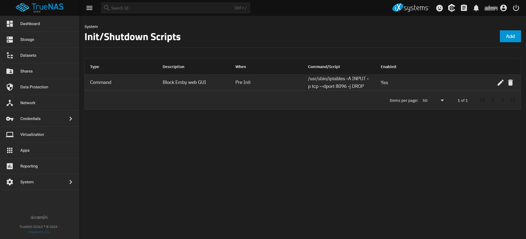

Solution AWBbox 2 Posted November 4, 2024 Author Solution Posted November 4, 2024 Okay, correction! TrueNAS Scale does use iptables and persistent rules can be added via Init Scripts, in my case: /usr/sbin/iptables -A INPUT -p tcp --dport 8096 -j DROP I'm happy with this solution 1
AWBbox 2 Posted November 11, 2024 Author Posted November 11, 2024 Quick follow up in case any readers end up copying what I did here. It appears an update to the Emby Docker image might have introduced a healthcheck with this iptables rule breaks. Traffic coming from the loopback address of TrueNAS must always be allowed, so instead use: /usr/sbin/iptables -A INPUT ! -i lo -p tcp --dport 8096 -j DROP This blocks everything to TCP/8096 except if it's from the loopback interface. 1
