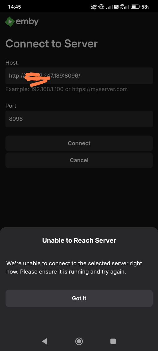

jorge99987 0 Posted November 1, 2024 Posted November 1, 2024 Good afternoon, the problem is that when I try to access emby outside the house it does not let me, I have even spoken to the operator which is Movistar/Colombia but they told me that they do not give the password to access the router and open its ports or configuration and they also do not open any type of ports since I could damage the security of the network... I would like to know if there is an alternative to connect externally without having to move ports or anything, I would have no problem even paying for remote advice but I want to solve this issue once and for all.
