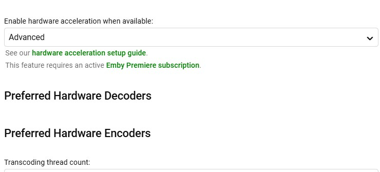

xiaolulu 4 Posted November 1, 2024 Posted November 1, 2024 My CPU is Intel N100, the PVE version I use is 8.2.2, the Linux kernel is 6.8.4-2, and the LXC is UBUNTU20.04. I have installed docker, emby, and u in lxc, and by configuring the LXC conf file, I can see card0 and renderD128 in ls -l /dev/dri in LXC and emby, but there is still no option in hardware transcoding.

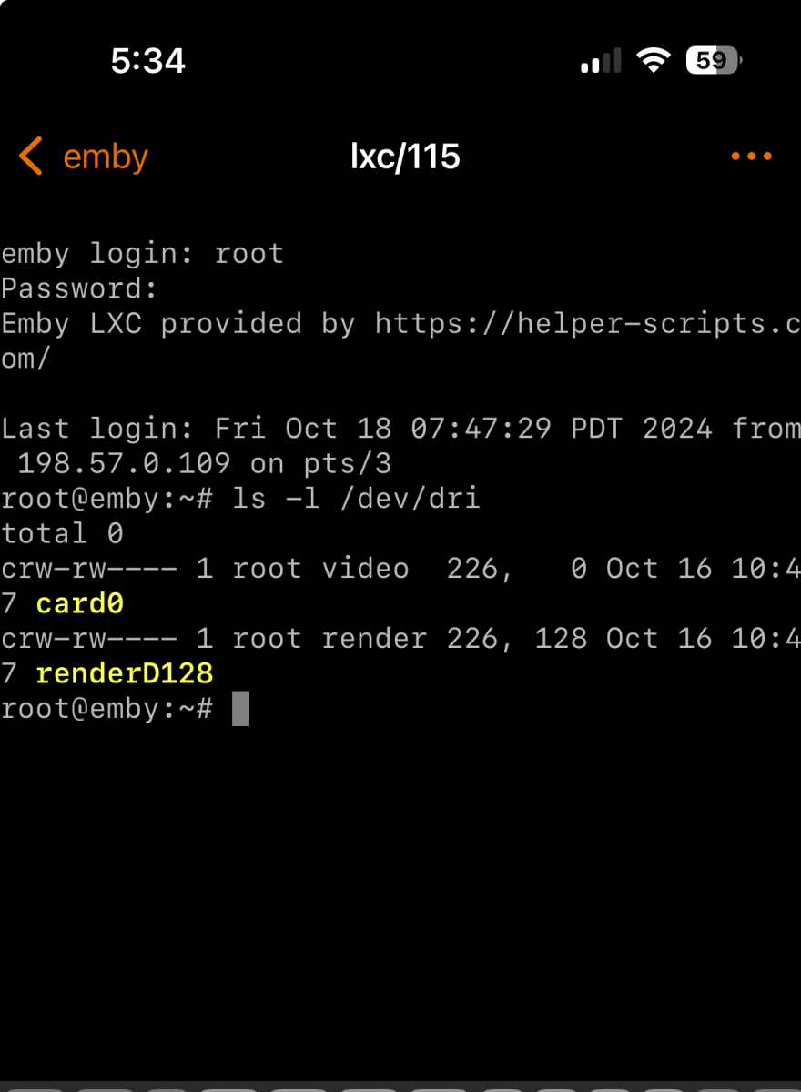

guunter 49 Posted November 2, 2024 Posted November 2, 2024 6 hours ago, xiaolulu said: The problem reappeared. I rolled back the LXC snapshot, reinstalled emby, and the transcoding option disappeared again. Is this the only lxc/vm running on your machine or did you passthrough the igpu to a vm? The script should work as long as you didn’t make any changes to the host. The script installs Emby in lxc and makes changes to the host so transcoding works. But if you made any changes to the host yourself it might mess up the igpu being able to be used by the lxc 1
xiaolulu 4 Posted November 2, 2024 Author Posted November 2, 2024 2 minutes ago, guunter said: Is this the only lxc/vm running on your machine or did you passthrough the igpu to a vm? The script should work as long as you didn’t make any changes to the host. The script installs Emby in lxc and makes changes to the host so transcoding works. But if you made any changes to the host yourself it might mess up the igpu being able to be used by the lxc Before the last success, I tried many settings on the host and LXC until it succeeded. After I rolled back the snapshot, I had forgotten which steps I had taken before.
xiaolulu 4 Posted November 2, 2024 Author Posted November 2, 2024 1 hour ago, guunter said: Is this the only lxc/vm running on your machine or did you passthrough the igpu to a vm? The script should work as long as you didn’t make any changes to the host. The script installs Emby in lxc and makes changes to the host so transcoding works. But if you made any changes to the host yourself it might mess up the igpu being able to be used by the lxc Resolved 1 1
