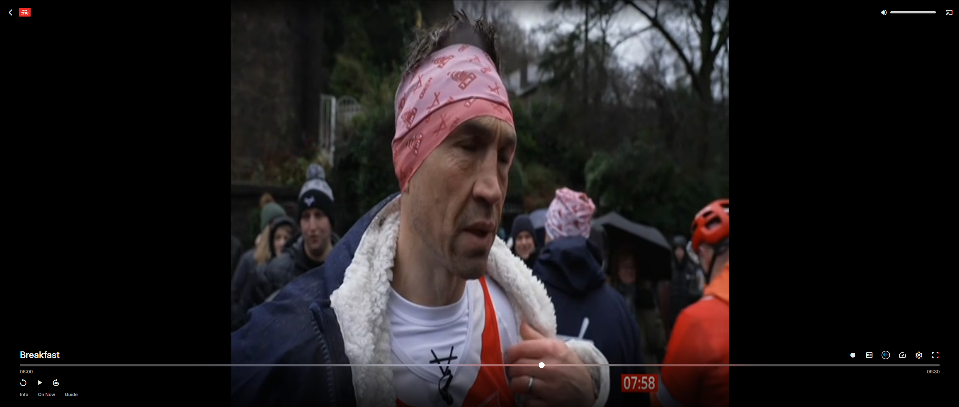

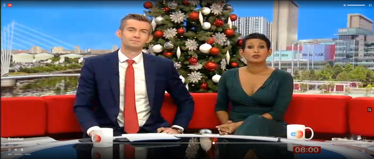

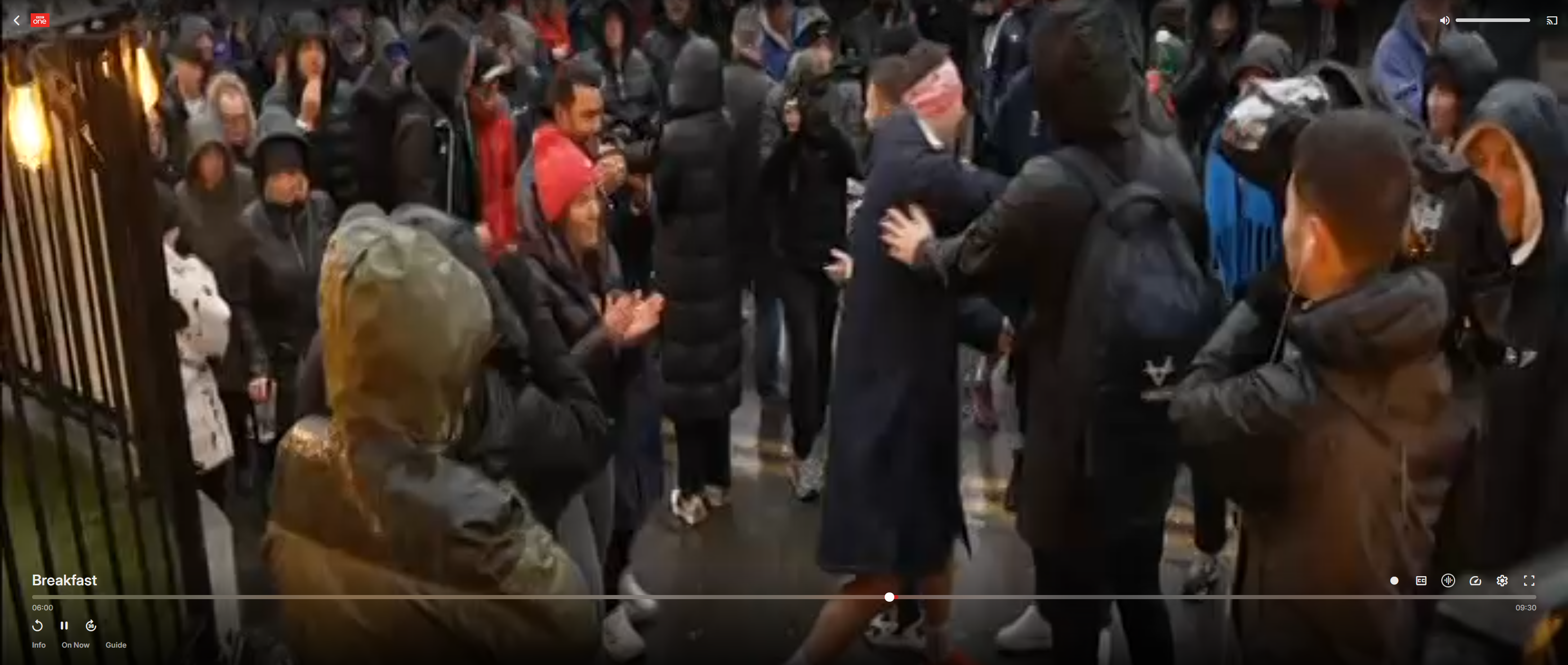

bwlonsdale 0 Posted December 21, 2024 Author Posted December 21, 2024 This is affecting live TV SD channel broadcasts in a browser (Stats say it's 578i) - screenshots from Firefox - this is BBC One as an example, aspect ratio should be 16:9 - what I see happening is the aspect ratio starts out correctly for a few seconds, then it get jumps into squished ratio, which looks like 4:3. The option is on Auto. If I try Cover or Fill, then it does change the picture, but not for the better (see caps) I am using a 34" monitor monitor (3440 x 1440), same behaviour across Firefox, Edge and Chrome. If I switch to a HD broadcast (1080i), it works fine - stays on correct aspect ratio.
Carlo 4561 Posted December 21, 2024 Posted December 21, 2024 (edited) On 12/21/2024 at 3:13 AM, bwlonsdale said: This is affecting live TV SD channel broadcasts in a browser (Stats say it's 578i but I assume that's a typo and it's 576i) - screenshots from Firefox - this is BBC One as an example, aspect ratio should be 16:9 - what I see happening is the aspect ratio starts out correctly for a few seconds, then it get jumps into squished ratio, which looks like 4:3. The option is on Auto. If I switch to a HD broadcast (1080i), it works fine - stays on correct aspect ratio. SD TV content is normally 4:3, unless authored as widescreen, so unless you are manipulating the image it should look like the above picture which is 4:3 with black bars on the sides. If you want it to use the full screen you could have your Emby client either stretch the image or zoom the image. Carlo Edited December 26, 2024 by Carlo 1

Carlo 4561 Posted December 29, 2024 Posted December 29, 2024 @Lukedo you see anything wrong here? The only thing IMHO that's wrong is the stretched videos distorting the aspect ratio. The second two pictures are not displayed with a proper aspect ratio of 16:9, as they are stretched horizontally. 16:9 content displayed on a 21:9 aspect ratio (3440x1440) ultrawide monitor will use 76.2% (16/21) of the screen width, with roughly 24% of screen as black bars on the sides. 16:9 content displayed on a 34-inch (21:9) monitor should appear as if you're watching a 26-inch (16:9) monitor. Aside from the distorted aspect ratio, the first picture of the SD content looks correct to me if the Display Aspect Ratio (DAR) was 4:3. However, if the DAR was 16:9, there should be approximately 4 inches of black bars on each side of the video. Assuming the resolution was 720x576i it could have a DAR of 4:3 or 16:9, but I've not seen Chrome or Edge get this wrong, hence my initial post saying it looks right to me (assuming 4:3 DAR).
