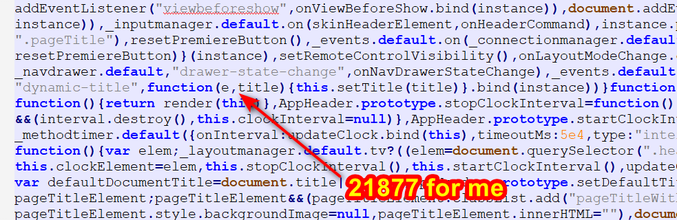

Hijack_in_Indy 0 Posted September 10, 2025 Posted September 10, 2025 On 1/9/2025 at 1:11 AM, KayDox64 said: Do you think we can get a video tutorial for how this should install? the instructions dont show what it looks like, for example my appheader.js was minified, and there was no position 21877, at least not one i could find. I'd love some addition info as well on inserting the code into the 4.8.11 appheader.js file. Position 21877 doesn't seem to line up in that version of the file with the install instructions.
Protected 87 Posted September 10, 2025 Author Posted September 10, 2025 (edited) What you're trying to do is to locate the `render` function, then insert the code at the end of this function, before the closing curly brace. Keep an eye out for how the contents are minified and whether there's a return statement at the end of the function, which might affect whether you need to end the previous line with a comma or semicolon (and code after the return statement will not run). The code: Emby.importModule("./modules/embyparty/partyheader.js").then(function(PartyHeader) { return (new PartyHeader()).show(skinHeaderElement.querySelector(".headerRight")) Is loading the party header module and then attaching it to the HTMLElement whose reference is passed to the show() function. You can pass it something else, which will affect where the party button appears, and you can also technically load it from somewhere else. Here's a more readable syntax explanation with an arrow function: Emby.importModule(PATH_TO_MODULE).then(moduleRef => moduleRef.show(REFERENCE_TO_HTML_ELEMENT)) Please note that I am not currently immediately able to update this project so I can't guarantee it's working with newer versions! Edited September 10, 2025 by Protected
Hijack_in_Indy 0 Posted September 10, 2025 Posted September 10, 2025 Thanks. I put the file contents through beautifier.io just so I could find the complete render function. Below is a more readable block of that function. function render(instance) { var Back, Home, Menu, Help; instance.element = skinHeaderElement, headerLeft = skinHeaderElement.querySelector(".headerLeft"), Menu = _globalize.default.translate("Menu"), Home = _globalize.default.translate("Home"), Back = _globalize.default.translate("Back"), Help = _globalize.default.translate("Help"), headerLeft.innerHTML = '\n <button type="button" is="paper-icon-button-light" class="headerBackButton headerButton headerSectionItem hide-mouse-idle-tv hide" tabindex="-1" title="'.concat(Back, '" aria-label="').concat(Back, '">\n <i class="md-icon autortl"></i>\n </button>\n <button type="button" is="paper-icon-button-light" class="headerHomeButton headerButton headerSectionItem hide-mouse-idle-tv hide md-icon md-icon-fill" tabindex="-1" title="').concat(Home, '" aria-label="').concat(Home, '">\n \n </button>\n <button type="button" is="paper-icon-button-light" class="headerMenuButton headerButton headerSectionItem hide md-icon" title="').concat(Menu, '" aria-label="').concat(Menu, '">\n \n </button>\n <h2 class="pageTitle headerSectionItem"> </h2>\n\n <a type="button" is="emby-linkbutton" class="paper-icon-button-light headerHelpButton dialogHeaderButton button-help headerButton headerSectionItem hide secondaryText" title="').concat(Help, '" aria-label="').concat(Help, '" target="_blank" href="#">\n <i class="md-icon autortl-arabic"></i>\n </a>\n '), Back = _globalize.default.translate("ManageEmbyServer"), Home = _globalize.default.translate("Settings"), Menu = _globalize.default.translate("Search"), Help = _globalize.default.translate("PlayOnAnotherDevice"), skinHeaderElement.querySelector(".headerRight").innerHTML = '\n <div class="headerSelectedPlayer headerSectionItem hide">\n\n </div>\n <button type="button" is="paper-icon-button-light" class="headerCastButton headerButton hide headerSectionItem md-icon hide" title="'.concat(Help, '" aria-label="').concat(Help, '">\n \n </button>\n <button type="button" is="paper-icon-button-light" class="headerSearchButton headerButton hide headerSectionItem md-icon hide" title="').concat(Menu, '" aria-label="').concat(Menu, '">\n \n </button>\n <button type="button" is="paper-icon-button-light" class="headerUserButton headerButton headerSectionItem hide" title="').concat(Home, '" aria-label="').concat(Home, '">\n <i class="md-icon largeIcon"></i>\n </button>\n <button type="button" is="paper-icon-button-light" class="headerSettingsButton headerButton headerSectionItem md-icon hide" title="').concat(Back, '" aria-label="').concat(Back, '">\n \n </button>\n <div class="headerClock headerSectionItem hide"></div>\n '), function(instance) { var parent = instance.element; headerBackButton = parent.querySelector(".headerBackButton"), headerHomeButton = parent.querySelector(".headerHomeButton"), headerMenuButton = parent.querySelector(".headerMenuButton"), headerCastButton = parent.querySelector(".headerCastButton"), headerHelpButton = parent.querySelector(".headerHelpButton"), headerSearchButton = parent.querySelector(".headerSearchButton"), selectedPlayerText = parent.querySelector(".headerSelectedPlayer"), headerRight = parent.querySelector(".headerRight"), headerBackButton.addEventListener("click", onBackClick), headerHomeButton.addEventListener("click", onHomeClick), headerSearchButton.addEventListener("click", onSearchClick), headerCastButton.addEventListener("click", onCastButtonClick), parent.querySelector(".headerUserButton").addEventListener("click", onUserButtonClick), parent.querySelector(".headerSettingsButton").addEventListener("click", onSettingsButtonClick), headerMenuButton.addEventListener("click", onHeaderMenuButtonClick), boundLayoutModeChangeFn = onLayoutModeChange.bind(instance), _events.default.on(_layoutmanager.default, "modechange", boundLayoutModeChangeFn), _events.default.on(_playbackmanager.default, "playerchange", updateCastIcon), _events.default.on(_playbackmanager.default, "playqueuestart", onNewPlayQueueStart), _events.default.on(_connectionmanager.default, "localusersignedin", onLocalUserSignedIn), _events.default.on(_connectionmanager.default, "localusersignedout", onLocalUserSignedOut), _events.default.on(_api.default, "UserUpdated", onUserUpdated), document.addEventListener("viewbeforeshow", onViewBeforeShow.bind(instance)), document.addEventListener("viewshow", onViewShow.bind(instance)), _inputmanager.default.on(skinHeaderElement, onHeaderCommand), instance.pageTitleElement = parent.querySelector(".pageTitle"), resetPremiereButton(), _events.default.on(_connectionmanager.default, "resetregistrationinfo", resetPremiereButton) }(instance), setRemoteControlVisibility(), onLayoutModeChange.call(instance), _events.default.on(_navdrawer.default, "drawer-state-change", onNavDrawerStateChange), _events.default.on(_navdrawercontent.default, "dynamic-title", function(e, title) { this.setTitle(title) }.bind(instance)) } Just tack on insert code to make the function read like this? function render(instance) { var Back, Home, Menu, Help; instance.element = skinHeaderElement, headerLeft = skinHeaderElement.querySelector(".headerLeft"), Menu = _globalize.default.translate("Menu"), Home = _globalize.default.translate("Home"), Back = _globalize.default.translate("Back"), Help = _globalize.default.translate("Help"), headerLeft.innerHTML = '\n <button type="button" is="paper-icon-button-light" class="headerBackButton headerButton headerSectionItem hide-mouse-idle-tv hide" tabindex="-1" title="'.concat(Back, '" aria-label="').concat(Back, '">\n <i class="md-icon autortl"></i>\n </button>\n <button type="button" is="paper-icon-button-light" class="headerHomeButton headerButton headerSectionItem hide-mouse-idle-tv hide md-icon md-icon-fill" tabindex="-1" title="').concat(Home, '" aria-label="').concat(Home, '">\n \n </button>\n <button type="button" is="paper-icon-button-light" class="headerMenuButton headerButton headerSectionItem hide md-icon" title="').concat(Menu, '" aria-label="').concat(Menu, '">\n \n </button>\n <h2 class="pageTitle headerSectionItem"> </h2>\n\n <a type="button" is="emby-linkbutton" class="paper-icon-button-light headerHelpButton dialogHeaderButton button-help headerButton headerSectionItem hide secondaryText" title="').concat(Help, '" aria-label="').concat(Help, '" target="_blank" href="#">\n <i class="md-icon autortl-arabic"></i>\n </a>\n '), Back = _globalize.default.translate("ManageEmbyServer"), Home = _globalize.default.translate("Settings"), Menu = _globalize.default.translate("Search"), Help = _globalize.default.translate("PlayOnAnotherDevice"), skinHeaderElement.querySelector(".headerRight").innerHTML = '\n <div class="headerSelectedPlayer headerSectionItem hide">\n\n </div>\n <button type="button" is="paper-icon-button-light" class="headerCastButton headerButton hide headerSectionItem md-icon hide" title="'.concat(Help, '" aria-label="').concat(Help, '">\n \n </button>\n <button type="button" is="paper-icon-button-light" class="headerSearchButton headerButton hide headerSectionItem md-icon hide" title="').concat(Menu, '" aria-label="').concat(Menu, '">\n \n </button>\n <button type="button" is="paper-icon-button-light" class="headerUserButton headerButton headerSectionItem hide" title="').concat(Home, '" aria-label="').concat(Home, '">\n <i class="md-icon largeIcon"></i>\n </button>\n <button type="button" is="paper-icon-button-light" class="headerSettingsButton headerButton headerSectionItem md-icon hide" title="').concat(Back, '" aria-label="').concat(Back, '">\n \n </button>\n <div class="headerClock headerSectionItem hide"></div>\n '), function(instance) { var parent = instance.element; headerBackButton = parent.querySelector(".headerBackButton"), headerHomeButton = parent.querySelector(".headerHomeButton"), headerMenuButton = parent.querySelector(".headerMenuButton"), headerCastButton = parent.querySelector(".headerCastButton"), headerHelpButton = parent.querySelector(".headerHelpButton"), headerSearchButton = parent.querySelector(".headerSearchButton"), selectedPlayerText = parent.querySelector(".headerSelectedPlayer"), headerRight = parent.querySelector(".headerRight"), headerBackButton.addEventListener("click", onBackClick), headerHomeButton.addEventListener("click", onHomeClick), headerSearchButton.addEventListener("click", onSearchClick), headerCastButton.addEventListener("click", onCastButtonClick), parent.querySelector(".headerUserButton").addEventListener("click", onUserButtonClick), parent.querySelector(".headerSettingsButton").addEventListener("click", onSettingsButtonClick), headerMenuButton.addEventListener("click", onHeaderMenuButtonClick), boundLayoutModeChangeFn = onLayoutModeChange.bind(instance), _events.default.on(_layoutmanager.default, "modechange", boundLayoutModeChangeFn), _events.default.on(_playbackmanager.default, "playerchange", updateCastIcon), _events.default.on(_playbackmanager.default, "playqueuestart", onNewPlayQueueStart), _events.default.on(_connectionmanager.default, "localusersignedin", onLocalUserSignedIn), _events.default.on(_connectionmanager.default, "localusersignedout", onLocalUserSignedOut), _events.default.on(_api.default, "UserUpdated", onUserUpdated), document.addEventListener("viewbeforeshow", onViewBeforeShow.bind(instance)), document.addEventListener("viewshow", onViewShow.bind(instance)), _inputmanager.default.on(skinHeaderElement, onHeaderCommand), instance.pageTitleElement = parent.querySelector(".pageTitle"), resetPremiereButton(), _events.default.on(_connectionmanager.default, "resetregistrationinfo", resetPremiereButton) }(instance), setRemoteControlVisibility(), onLayoutModeChange.call(instance), _events.default.on(_navdrawer.default, "drawer-state-change", onNavDrawerStateChange), _events.default.on(_navdrawercontent.default, "dynamic-title", function(e, title) { this.setTitle(title) }.bind(instance)) , Emby.importModule("./modules/embyparty/partyheader.js").then(function(PartyHeader) { return (new PartyHeader()).show(skinHeaderElement.querySelector(".headerRight")); });} Thanks for monitoring this plugin thread even if you're not actively developing any more. I hope the plugin does still work. I'll let you know once I get it all set up right.
