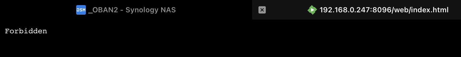

GreyT 4 Posted October 28, 2024 Posted October 28, 2024 After a few hickups the usefulness of Emby is clear. Then I experienced that a wideo interview ( saved as .mp4) I had somehow landed on my mac, stopped after short playback. It plays well on the mac using quicktime, I looked into emby settings, and have likely misunderstood something, because now l get this message on the #creen: so how do I proceed GreyT
Happy2Play 9811 Posted October 28, 2024 Posted October 28, 2024 What did you change on Emby Network page? But may have to shutdown Emby and edit your system.xml or even delete it and step through setup wizard again.
GreyT 4 Posted October 28, 2024 Author Posted October 28, 2024 I dont remember changin anything special, it was working perfect. The only thing was that a video interview saved from youtube as .mp4 only would playsay one minute then pause/freeze. I know I looked into the Synology settings for any option to improve the situation...and it is my hunch I did something, but know of no way to "undo" that! in the end I un-installed emby from the synology NAS and the when I wanted to start from fresh, installed it again. The error messsage persisted. I am at a loss here, since the action is on the NAS, not on my Mac.... I can still access all the videofiles on the NAS in the normal find and play way, but the elegance of Emby is truely missed. ANY help will be appreciated. GreyT

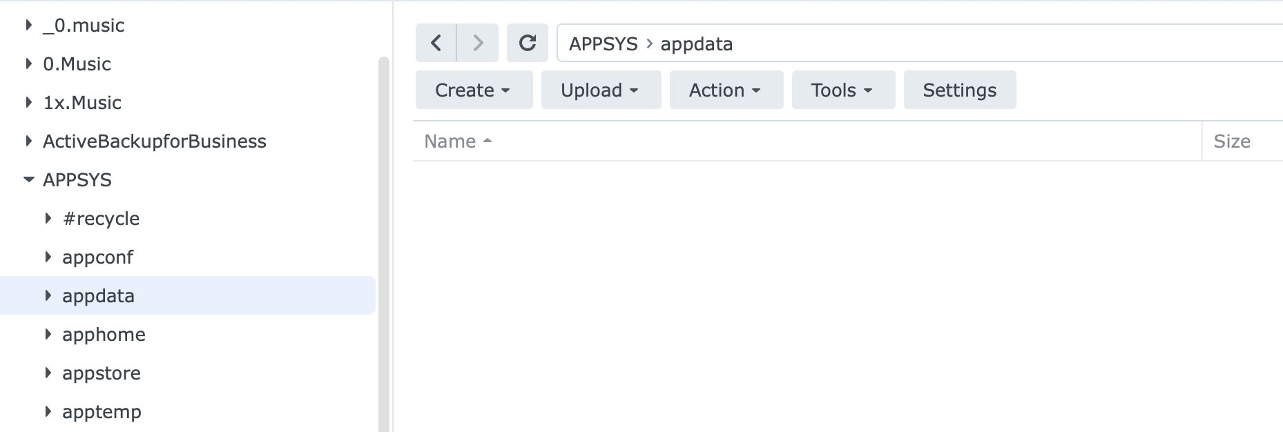

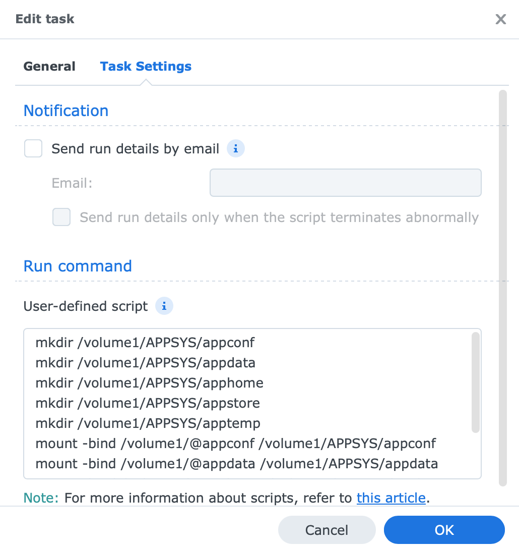

Carlo 4561 Posted November 6, 2024 Posted November 6, 2024 Sorry, Windows rebooted after an update. It will normally open the same tabs in a browser you had open. It didn't, so I had to track it back down. Make sure Emby Server isn't running. Open Control Panel Create a new drive share called APPSYS (all capps) Open Task Scheduler Create a Triggered Task...User-defined script to run at Boot-up Name: Mount App Folders User: root Event: Boot-up Enabled Click OK In the user-defined script box enter this Quote mkdir /volume1/APPSYS/appconf mkdir /volume1/APPSYS/appdata mkdir /volume1/APPSYS/apphome mkdir /volume1/APPSYS/appstore mkdir /volume1/APPSYS/apptemp mount --bind /volume1/@appconf /volume1/APPSYS/appconf mount --bind /volume1/@appdata /volume1/APPSYS/appdata mount --bind /volume1/@apphome /volume1/APPSYS/apphome mount --bind /volume1/@appstore /volume1/APPSYS/appstore mount --bind /volume1/@apptemp /volume1/APPSYS/apptemp Save it Create another user-defined script same as above with these changes. Name: Unmount App Folders user-defined script box enter this Quote umount /volume1/APPSYS/appconf umount /volume1/APPSYS/appdata umount /volume1/APPSYS/apphome umount /volume1/APPSYS/appstore umount /volume1/APPSYS/apptemp Were going to use both of these so we created the tasks enabled. We really don't want this to happen at boot-up so after using them you can disable the tasks. Manually run the task Mount App Folders Open the APPSYS share in File Station and you should now see 5 subdirectories: appconf, appdata, apphome, appstore, apptemp Open each of those 5 folders one by one. Delete any folder starting with "Emby" You may only find an Emby folder in the appdata folder. appdata is likely the only one that matters for Emby but it's nice to have access to these system After you finished deleting any Emby Folders go back to Task Scheduler and run Unmount App Folders job. Now disable both Mount App Folders and Unmount App Folders Reinstall Emby Server Task Scheduler is pretty simple to use. If you like check out this Youtube video which covers it pretty well in general. ttps://www.youtube.com/watch?v=7vXDUFbNd50

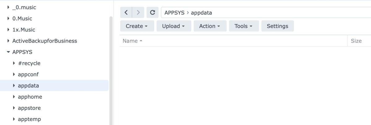

GreyT 4 Posted November 7, 2024 Author Posted November 7, 2024 OK, so I entered this new area today... and after typing the lines you showed, I ran the first script, several times, but all came out with all 5 folders were empty. I even rebooted NAS just in case... with and without the checkmark in place (only for the first Triggered task. So what did I miss? Maybe somthing you know by routine, but I do not! You mention Emby should not be running! And later then mention that it should be re-installed! ... Is "not running" code for uninstalled GreyT
GreyT 4 Posted November 7, 2024 Author Posted November 7, 2024 Realise that my screenshots came out way to dominat in size. Next time I'll resize them before posting GreyT
Carlo 4561 Posted November 7, 2024 Posted November 7, 2024 Run the Mount job. Then go through this list of permissions. Some pages will have a drop down list box to select users or groups. Make sure to do both. In control panel, users menu. Make sure your username is part of the Administrator Group. In the group settings click the permission tab and make sure the admin group has access to APPSYS Make sure you have clicked the read/write boxes for the user or group. Click on your username to open user settings. Go to permissions and enable the box for read/write for APPSYS. Save changes to users/groups. Control Panel/Shared Folders. Highlight/single click APPSYS Click edit button up top. Disable Restrict access to administrators only Click permissions tab and give read/write access to your users and admin groups. groups (dropdown) Check advanced permissions to make sure nothing is enabled on this page. Save this button. Open File Station select APPSYS Check to see if any folders are present now If not one more than to try. RIGHT CLICK the mouse on APPSYS in the left column Select Properties Advanced Permissions all blank Go to Permissions tab. Be careful on this page Select administrator, then click edit button Make sure all the boxes are checked for reads & writes but DO NOT enable Change permissions or Take Ownership options (top 2) Select Done Click the Create Button Select your username in the drop down. Type is Allow Apply to: All Skip the top 2 options (Change permissions & Take Ownership) Enable all Read & Write options Click Done to save See if folders show up now
GreyT 4 Posted November 8, 2024 Author Posted November 8, 2024 Strange... but the folders on APPSYS are still empty. I'll let this issue rest for now, and after the weekend deside what I prefer to do. Thanks for your detailed 'prescription' GreyT
Carlo 4561 Posted November 10, 2024 Posted November 10, 2024 Yes, very strange. It would have been easier to just SSH in and ran a couple commands.

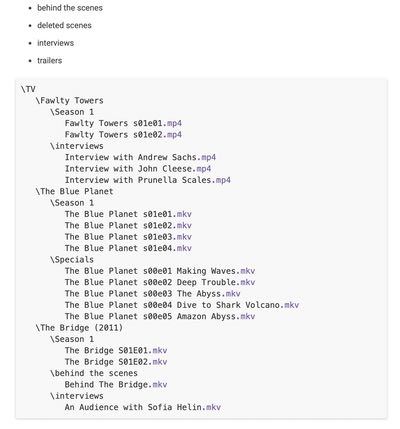

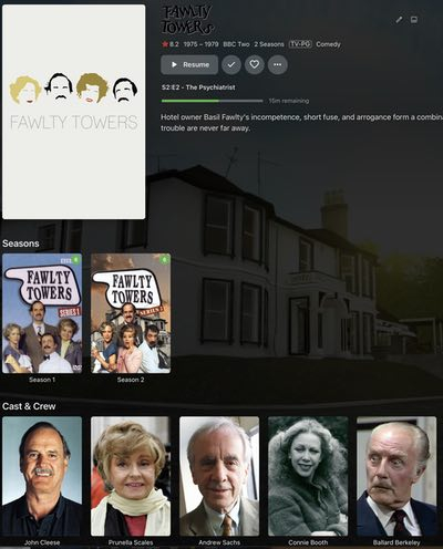

GreyT 4 Posted November 12, 2024 Author Posted November 12, 2024 Well, among my videos there are also Fawlty Towers, ripped long ago from 2 BlueRay disks , and these came up after my speedy entrance into the Emby Universe like this: so After some different "good ideas" I finally did RTM: And... TADAAaa... it shows like this Well this sure calls for a Carlsberg And in line with this I am giving "Cheers" a similar treatment... takes some shuffling the files around into season folders but it works and that part is great, for my inner Nerd GreyT The PS: ... The Dashboard does not really call for my visual attention with its 'bleak face', it deserves a more colorful and inspiring design so users will be a bit more drawn to the fix of pitfalls (likely before they fall in, as I did several times)
Carlo 4561 Posted November 13, 2024 Posted November 13, 2024 You're doing good! With a couple changes you can get some really nice looking screens.
