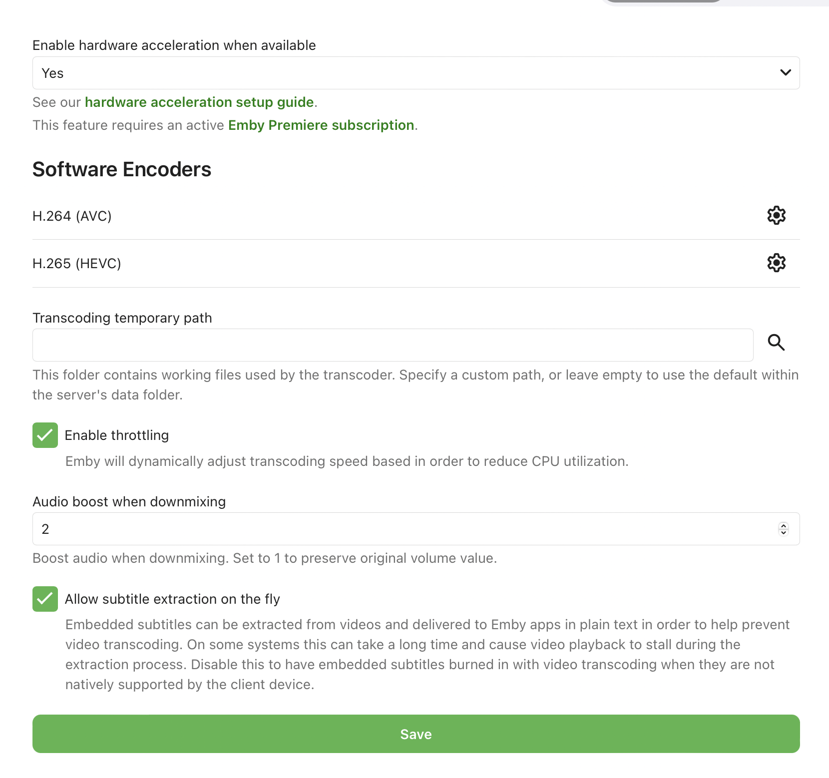

benacovi 1 Posted October 28, 2024 Author Posted October 28, 2024 2 hours ago, guunter said: In the Emby server settings where it says transcoding. You click advanced and you should see some options for codecs. Do you even have a gpu installed or what cpu are you using? I found the setting, here's a pic. I don't have Emby Premiere though. I'm running a Supermicro X10SL7-F with an i3-4170 and no GPU. I am more than willing to upgrade the CPU and/or install a GPU if you think that will help.
guunter 49 Posted October 28, 2024 Posted October 28, 2024 A gpu will 100% help with transcoding 4k with subtitles. The video will be transcoded by the gpu and subtitles by the CPU. You’ll need premiere though to take advantage

benacovi 1 Posted October 29, 2024 Author Posted October 29, 2024 2 hours ago, yocker said: You need to tell the Emby Server to use the card. https://emby.media/support/articles/Transcoding.html I do have it enabled, see attached pic.
guunter 49 Posted October 29, 2024 Posted October 29, 2024 1 hour ago, benacovi said: I do have it enabled, see attached pic. Did you add the nvidia variables to the docker config settings? If you click on that yes and do advanced it’ll show you more options if it sees the gpu
