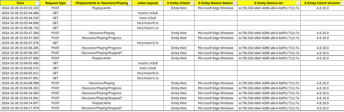

sa2000 695 Posted October 29, 2024 Posted October 29, 2024 (edited) Interesting - this is very similar to what I saw on Emby Web in Google Chrome in this forum topic here Emby Web reading first few HLS segments and then deciding to abort In your log - this sequence was repeated over and over where the Emby Web app stops the stream after reading the first 2 or 3 HLS segments and the corresponding Server WMC log lines for the first playback above (at 15:03:33) 2024/10/26 15:03:39.703 Finished request OpenLiveStream in 6.03s 2024/10/26 15:03:39.710 AddonVersion> client: 'Emby^' has addon/plugin version: , OS: windows 6.1.7601.0 2024/10/26 15:03:39.736 VideoFileStream> video stream created for: N:\Recorded TV\TempSWMC\LiveTV_Emby^^0_Digital Cable_7_2024_10_26_15_03_33.ts 2024/10/26 15:03:39.783 VideoFileStream> first read occurred 2024/10/26 15:03:40.706 Parse> Warning, Number of attempts at getting new wtv data was large: 538 (threshold: 500) 2024/10/26 15:03:41.868 Parse> Warning, Number of attempts at getting new wtv data was large: 559 (threshold: 500) 2024/10/26 15:03:56.369 Received client request: MediaBrowser^@@0|::1|CloseLiveStream 2024/10/26 15:03:56.370 CloseStream> -----------------start------------------------ Could you try other emby client apps and see if it is the same ? eg iOS / Android apps. and also if possible Emby Web on Firefox Emby Web 4.8.10 was running in "Microsoft Edge";v="109", "Chromium";v="109", (There should also be ffmpeg logs to go with the embyserver log for these streaming attempts) Edited October 29, 2024 by sa2000

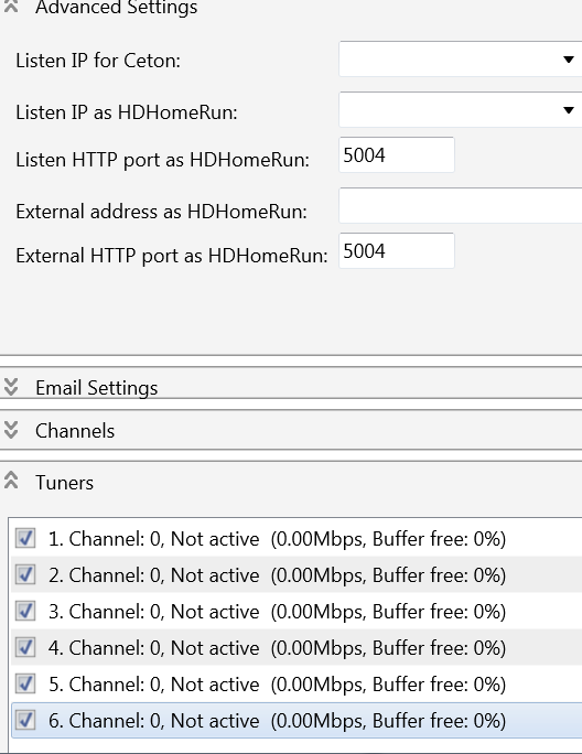

JRGGREY 0 Posted October 29, 2024 Author Posted October 29, 2024 Emveepee, Understood I was going to see of I could get version 4 to work independently and be able to watch remotely. I will look at Ceton Proxy tonight. I have tried the tests for the lineup and video VLC stream but both fail. The ip address on Ceton proxy matches what is on the ceton tuner. Does the 5004 ceton proxy port number have to match ceton tuners or emby? Thanks
JRGGREY 0 Posted October 29, 2024 Author Posted October 29, 2024 Sa2000, First thank you very much for looking at the logs and making sense of them! I will try it on other apps as you suggested. I have used it on my fire tv emby app and have the same experience. I will also try on my phone. I will also look into getting the ffmpeg logs. Thank you!
emveepee 133 Posted October 29, 2024 Posted October 29, 2024 5 hours ago, JRGGREY said: Emveepee, Understood I was going to see of I could get version 4 to work independently and be able to watch remotely. I will look at Ceton Proxy tonight. I have tried the tests for the lineup and video VLC stream but both fail. The ip address on Ceton proxy matches what is on the ceton tuner. Does the 5004 ceton proxy port number have to match ceton tuners or emby? Thanks Remote streaming is better and more security in the current version of NextPVR but I don't understand the second sentence but if it about v4 I won't try. The 5004 port is the HDHR emulation nothing to do with Ceton or Emby.
JRGGREY 0 Posted October 29, 2024 Author Posted October 29, 2024 Ok I got Ceton Proxy test to show a lineup of channels and also show a channel on VLC media player. Next, I removed Server WMC from Emby live TV. I next, I went to add tv source and chose HDHomerun. It did not detect the device, so I put the Ceton Tuner Ip address in the box. It saved. But I do not get any channels. Do I need to change advanced setting on Ceton Proxy? It has the Emby guide data which worked great before. I do have a schedule direct account if necessary. Any help would be much appreciated. I also restarted Emby server after the changes. embyserver (2).txt ffmpeg-remux-f0e5d312-6638-4800-8613-969021c54472_1.txt
emveepee 133 Posted October 30, 2024 Posted October 30, 2024 There are two ports the web server port (80) and the streaming port (5004). It looks like 80 isn't listening plus it looks like the documentation on Ceton Proxy is wrong, it shows 5004 for linenup.xml Martin
