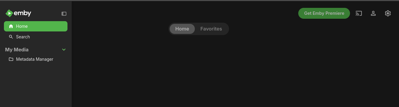

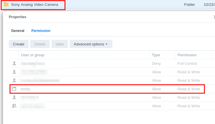

dandangerous 1 Posted October 25, 2024 Posted October 25, 2024 New user here, installed Emby on my DS720+, I believe I have followed the instructions completely, but cannot get my media to display. What's weird is I can see the videos in the library thumbnail. And the logs show the files are being read: 2024-10-25 01:26:18.051 Info QuickSingleImageExtractor: ProcessRun 'quick-extract-image' Execute: /var/packages/EmbyServer/target/bin/ffmpeg -skip_list 101 -f mp4 -threads 1 -i file:"/volume1/video/Sony Analog Video Camera/2007-05-01 Tape 8 05.07.mp4" -an -sn -update 1 -vf "thumbnail=24" -vsync 0 -f image2 "/var/packages/EmbyServer/var/cache/temp/6fe81519-e083-4a06-af62-2de31d3c0e1b.jpg" 2024-10-25 01:26:18.536 Info QuickSingleImageExtractor: ProcessRun 'quick-extract-image' Process exited with code 0 - Succeeded When I go to Home, I get nothing. I've confirmed the permissions are correct according to the various articles with Emby set as a Read/Write System Internal User for the main Share (video, in this case) and confirmed that permission carried through to the sub folders. Things I've tried: Videos in the main folder (and added a new library pointing directly to that /volume1/video folder) with no luck Different types of files: older MP4s (H.264), newer MP4s (H.265), MPG, JPG, etc. All in their own folder, deleting and remapping the library each time. (all with a very small number of files) Library type as Mixed Content instead of Home Video & Photo Restarting the NAS Deleting Emby, restarting NAS, Reinstalling Emby, restarting NAS (note that the settings and cache and everything were retained, not sure how to easily do a complete removal except SSH in and delete the folders?) Removing folder permissions, saving, then reassigning folder permissions and saving Confirmed ports are open on the Synology firewall (8096, 8920) and mapped on my router Tried accessing from a different browser: Firefox, Chrome, Firefox Private, all extensions off etc, also a different computer, and from my phone on the local network through the Emby App I'm on a DS720+ with the latest DSM 7.2.2-72806 and Emby 4.8.10.0-724081000. Note that I started on 4.8.8.0 and then manually upgraded by stopping the server, uninstalling, then manually loading the updated package through the Synology Package Center. I deleted all my Libraries, cycled the log file, turned on debug, then added a library back in, which is attached. It looks like the files are accessible and being read and recognized with thumbnails being created. I'm at a loss, any ideas why these would not be showing up on my Home screen (and I've clicked through all the My Media links, etc.).? embyserver.txt

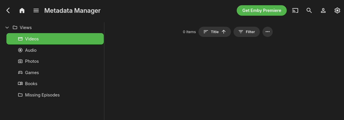

Carlo 4563 Posted October 26, 2024 Posted October 26, 2024 (edited) Hi, If you go into the Media Manager menu, does it show your media here? Edited October 26, 2024 by Carlo
dandangerous 1 Posted October 26, 2024 Author Posted October 26, 2024 Is this the Media Manager menu? Getting nothing there or with any of the links under Metadata Manager. Let me know if I'm looking in the wrong places.

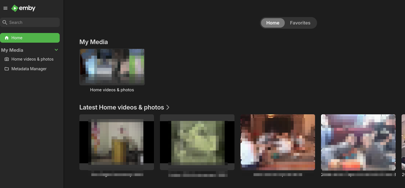

Solution dandangerous 1 Posted November 1, 2024 Author Solution Posted November 1, 2024 Okay - solved my own problem here. I did a complete uninstall of Emby. For anyone else needing this: In DSM 7.2.2 Go to Package Center, stop Emby Uninstall Emby Go to Control Panel > Shared Folders and remove Emby permissions for the folders you assigned under System Internal Users Go to Users & Groups, enable Admin (which Synology recommends you keep disabled unless needed), assign a new password (because I always forget it...) Go to Terminal & SNMP, enable SSH on port 22 Go to Security > Firewall > Edit rules and enable Encrypted Terminal Service on port 22 Then in your preferred SSH program (I used Terminal) Remote in using your device IP ssh admin@XXX.XXX.X.XXX Find the Emby directory cd /volume1/@appdata View the directory ls You should see EmbyServer in the list Elevate your permissions and delete this directory sudo rm -r EmbyServer View the folder list again and validate EmbyServer has been deleted ls Logout from SSH logout Back In DSM 7.2.2 Restart by clicking the user icon in the upper right Needed? Not sure, but a restart is always a good way for clearing those lingering things in memory, so why not. After restarting, undo the SSH Go to Users & Groups, disable Admin Go to Terminal & SNMP, disable SSH Go to Security > Firewall > Edit rules and uncheck Encrypted Terminal Service Reinstall Emby I used "Manual Install" to upload the latest from Emby (currently 4.8.10) Follow the regular Synology install guide, including adding Emby Read/Write permissions for the folders you want to use under System Internal Users, setup a user, add your folders to Emby interface, etc. Success! My media is now showing up! Hooray! 1
