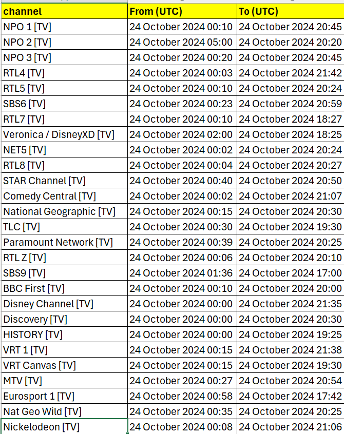

sa2000 703 Posted October 25, 2024 Posted October 25, 2024 8 hours ago, muppets4 said: Emby picks up on it and shows the channel logos correctly. The EPG data is not being used. And I don't know why. Anyone? I used your xmltv file and changed date for the schedules from 20241024 to 20241025 and in the setup/channels view, I edited one channel to map it to a channel in the xmltv guide and the guide view does show the program - this is a schedule entry for "MTV (TV)" channel ID You could enable debug logging in logs server settings and restart the server and then double check that the DVR channels are mapped to xmltv guide channels and then refresh the guide and when it finishes, open Live TV page and then Guide view and see if it shows schedules - if not, download the logs and upload here with the xmltv file that was in use There are some errors in the log and I do not know if they have any relevance - but you could remove the TuneIn plugin which the errors relate to 2024-10-25 01:11:09.517 Error App: Error loading types from assembly *** Error Report *** Version: 4.8.10.0 Command line: C:\Users\jgcro\AppData\Roaming\Emby-Server\system\EmbyServer.dll -noautorunwebapp Operating system: Microsoft Windows 10.0.22621 Framework: .NET 6.0.33 OS/Process: x64/x64 Runtime: C:/Users/jgcro/AppData/Roaming/Emby-Server/system/System.Private.CoreLib.dll Processor count: 8 Data path: C:\Users\jgcro\AppData\Roaming\Emby-Server\programdata Application path: C:\Users\jgcro\AppData\Roaming\Emby-Server\system System.Reflection.ReflectionTypeLoadException: System.Reflection.ReflectionTypeLoadException: Unable to load one or more of the requested types. Method 'GetChannelItemMediaInfo' in type 'MediaBrowser.Plugins.TuneIn.TuneInChannel' from assembly 'MediaBrowser.Plugins.TuneIn, Version=1.0.6098.30150, Culture=neutral, PublicKeyToken=null' does not have an implementation. Could not load type 'MediaBrowser.Controller.Channels.ChannelMediaInfo' from assembly 'MediaBrowser.Controller, Version=4.8.10.0, Culture=neutral, PublicKeyToken=null'. at System.Reflection.RuntimeModule.GetTypes(RuntimeModule module) at System.Reflection.Assembly.GetTypes() at Emby.Server.Implementations.ApplicationHost.GetTypes(Tuple`2 assemblyInfo) System.TypeLoadException: Method 'GetChannelItemMediaInfo' in type 'MediaBrowser.Plugins.TuneIn.TuneInChannel' from assembly 'MediaBrowser.Plugins.TuneIn, Version=1.0.6098.30150, Culture=neutral, PublicKeyToken=null' does not have an implementation. System.TypeLoadException: Could not load type 'MediaBrowser.Controller.Channels.ChannelMediaInfo' from assembly 'MediaBrowser.Controller, Version=4.8.10.0, Culture=neutral, PublicKeyToken=null'. Source: System.Private.CoreLib TargetSite: System.RuntimeType[] GetTypes(System.Reflection.RuntimeModule) 2024-10-25 01:11:09.517 Error App: LoaderException: Method 'GetChannelItemMediaInfo' in type 'MediaBrowser.Plugins.TuneIn.TuneInChannel' from assembly 'MediaBrowser.Plugins.TuneIn, Version=1.0.6098.30150, Culture=neutral, PublicKeyToken=null' does not have an implementation. 2024-10-25 01:11:09.517 Error App: LoaderException: Could not load type 'MediaBrowser.Controller.Channels.ChannelMediaInfo' from assembly 'MediaBrowser.Controller, Version=4.8.10.0, Culture=neutral, PublicKeyToken=null'. and 2024-10-25 01:11:09.902 Error App: Error creating MediaBrowser.Plugins.TuneIn.Plugin *** Error Report *** Version: 4.8.10.0 Command line: C:\Users\jgcro\AppData\Roaming\Emby-Server\system\EmbyServer.dll -noautorunwebapp Operating system: Microsoft Windows 10.0.22621 Framework: .NET 6.0.33 OS/Process: x64/x64 Runtime: C:/Users/jgcro/AppData/Roaming/Emby-Server/system/System.Private.CoreLib.dll Processor count: 8 Data path: C:\Users\jgcro\AppData\Roaming\Emby-Server\programdata Application path: C:\Users\jgcro\AppData\Roaming\Emby-Server\system SimpleInjector.ActivationException: SimpleInjector.ActivationException: No registration for type Plugin could be found and an implicit registration could not be made. Value cannot be null. (Parameter 'path2') ---> System.ArgumentNullException: Value cannot be null. (Parameter 'path2') at System.IO.Path.Combine(String path1, String path2) at MediaBrowser.Common.Plugins.BasePlugin`1.get_ConfigurationFilePath() at MediaBrowser.Common.Plugins.BasePlugin`1.LoadConfiguration() at MediaBrowser.Common.Plugins.BasePlugin`1.get_Configuration() at MediaBrowser.Plugins.TuneIn.Plugin..ctor(IApplicationPaths applicationPaths, IXmlSerializer xmlSerializer) at lambda_method61(Closure ) at SimpleInjector.InstanceProducer.BuildAndReplaceInstanceCreatorAndCreateFirstInstance() at SimpleInjector.InstanceProducer.GetInstance() --- End of inner exception stack trace --- at SimpleInjector.InstanceProducer.GetInstance() at SimpleInjector.Container.GetInstanceForRootType(Type serviceType) at SimpleInjector.Container.GetInstance(Type serviceType) at Emby.Server.Implementations.ApplicationHost.CreateInstanceSafe(Tuple`2 typeInfo) Source: SimpleInjector TargetSite: System.Object GetInstance() InnerException: System.ArgumentNullException: Value cannot be null. (Parameter 'path2') Source: System.Private.CoreLib TargetSite: System.String Combine(System.String, System.String) at System.IO.Path.Combine(String path1, String path2) at MediaBrowser.Common.Plugins.BasePlugin`1.get_ConfigurationFilePath() at MediaBrowser.Common.Plugins.BasePlugin`1.LoadConfiguration() at MediaBrowser.Common.Plugins.BasePlugin`1.get_Configuration() at MediaBrowser.Plugins.TuneIn.Plugin..ctor(IApplicationPaths applicationPaths, IXmlSerializer xmlSerializer) at lambda_method61(Closure ) at SimpleInjector.InstanceProducer.BuildAndReplaceInstanceCreatorAndCreateFirstInstance() at SimpleInjector.InstanceProducer.GetInstance()

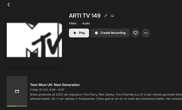

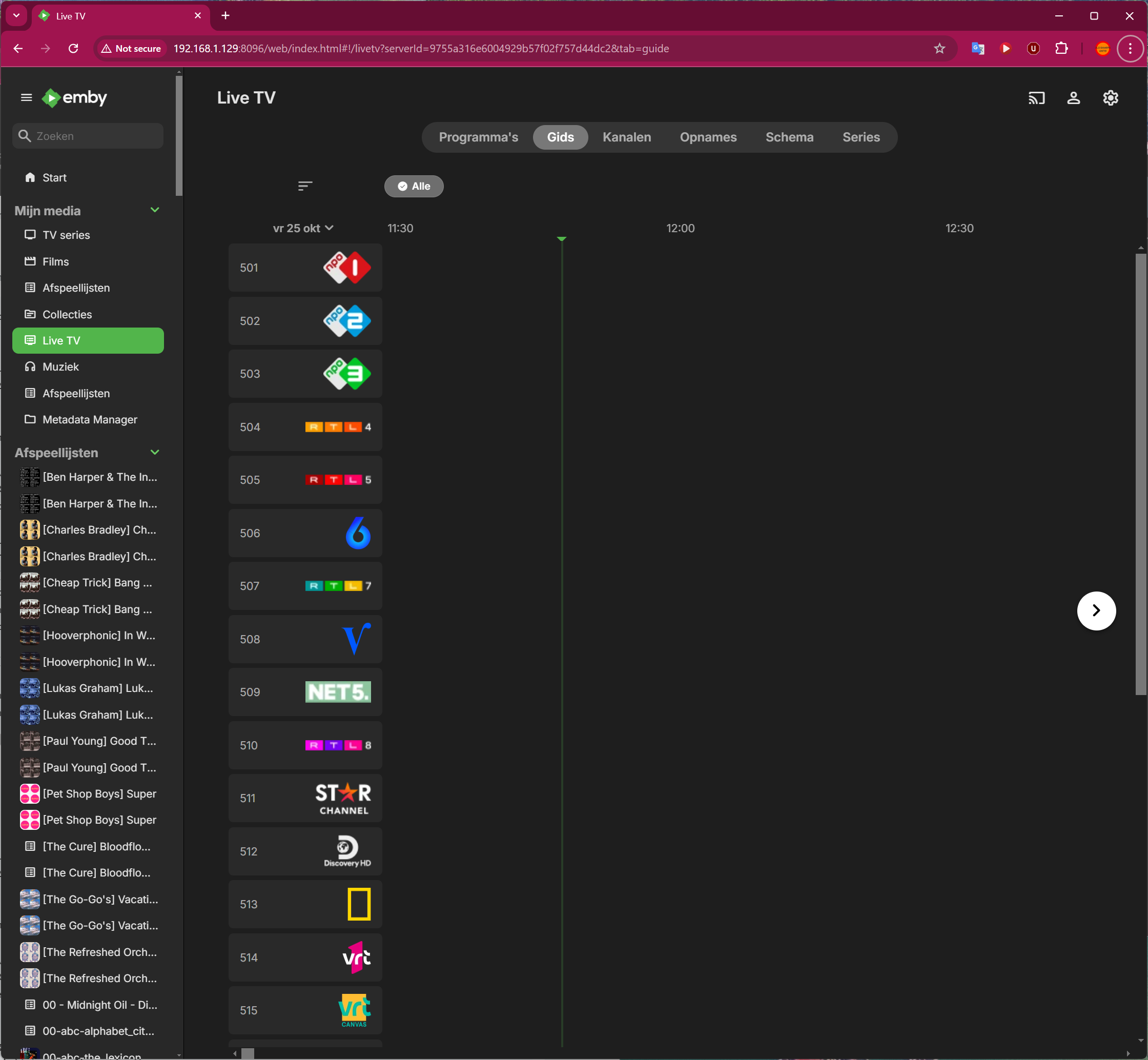

muppets4 24 Posted October 25, 2024 Author Posted October 25, 2024 7 hours ago, Luke said: Hi there, why do you think the epg data is not being used? because of this:

sa2000 703 Posted October 25, 2024 Posted October 25, 2024 17 minutes ago, muppets4 said: because of this: That screenshot is for 25th October guide. The XMLTV file you attached had only schedules for the following

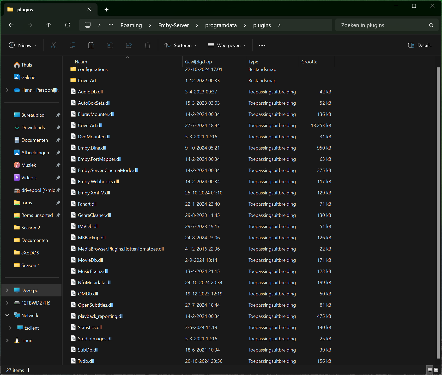

sa2000 703 Posted October 25, 2024 Posted October 25, 2024 15 minutes ago, muppets4 said: This is strange. I have no TuneIn plugin installed. Never used it in relation with Emby too. Interesting Can you see if this exists C:\Users\jgcro\AppData\Roaming\Emby-Server\programdata\plugins\MediaBrowser.Plugins.TuneIn.dll Log Extract: 2024-10-25 01:11:09.488 Info App: Loading MediaBrowser.Plugins.TuneIn, Version=1.0.6098.30150, Culture=neutral, PublicKeyToken=null from C:\Users\jgcro\AppData\Roaming\Emby-Server\programdata\plugins\MediaBrowser.Plugins.TuneIn.dll
muppets4 24 Posted October 25, 2024 Author Posted October 25, 2024 20 minutes ago, sa2000 said: Interesting Can you see if this exists C:\Users\jgcro\AppData\Roaming\Emby-Server\programdata\plugins\MediaBrowser.Plugins.TuneIn.dll Log Extract: 2024-10-25 01:11:09.488 Info App: Loading MediaBrowser.Plugins.TuneIn, Version=1.0.6098.30150, Culture=neutral, PublicKeyToken=null from C:\Users\jgcro\AppData\Roaming\Emby-Server\programdata\plugins\MediaBrowser.Plugins.TuneIn.dll No, doesn't exist. There is one Mediabrowser plugin for RottenTomatoes.
muppets4 24 Posted October 25, 2024 Author Posted October 25, 2024 26 minutes ago, sa2000 said: That screenshot is for 25th October guide. The XMLTV file you attached had only schedules for the following Strange. But I think I have it sorted out. I now used the configmaker assistant for Webgrabplus and used the XML config file that came out of that. And set it to 7 days of data. And now it looks like it is working, although that was the case with the one channel I tried. It's getting the rest of the data as we speak. For a noob Webgrabplus has a steep learning curve. I have used it before, but it's set and forget with these things for me. Only when I start to use new hardware I have to look into it again. Thanks for the great support I am receiving here for many years now for very little money. 1

sa2000 703 Posted October 25, 2024 Posted October 25, 2024 25 minutes ago, muppets4 said: No, doesn't exist. There is one Mediabrowser plugin for RottenTomatoes. Interesting - will see if @Lukeknows why this happens 2024-10-25 01:11:09.902 Error App: Error creating MediaBrowser.Plugins.TuneIn.Plugin *** Error Report *** Version: 4.8.10.0 Command line: C:\Users\jgcro\AppData\Roaming\Emby-Server\system\EmbyServer.dll -noautorunwebapp Operating system: Microsoft Windows 10.0.22621 Framework: .NET 6.0.33 OS/Process: x64/x64 Runtime: C:/Users/jgcro/AppData/Roaming/Emby-Server/system/System.Private.CoreLib.dll Processor count: 8 Data path: C:\Users\jgcro\AppData\Roaming\Emby-Server\programdata Application path: C:\Users\jgcro\AppData\Roaming\Emby-Server\system SimpleInjector.ActivationException: SimpleInjector.ActivationException: No registration for type Plugin could be found and an implicit registration could not be made. Value cannot be null. (Parameter 'path2') ---> System.ArgumentNullException: Value cannot be null. (Parameter 'path2') at System.IO.Path.Combine(String path1, String path2) at MediaBrowser.Common.Plugins.BasePlugin`1.get_ConfigurationFilePath() at MediaBrowser.Common.Plugins.BasePlugin`1.LoadConfiguration() at MediaBrowser.Common.Plugins.BasePlugin`1.get_Configuration() at MediaBrowser.Plugins.TuneIn.Plugin..ctor(IApplicationPaths applicationPaths, IXmlSerializer xmlSerializer) at lambda_method61(Closure ) at SimpleInjector.InstanceProducer.BuildAndReplaceInstanceCreatorAndCreateFirstInstance() at SimpleInjector.InstanceProducer.GetInstance() --- End of inner exception stack trace --- at SimpleInjector.InstanceProducer.GetInstance() at SimpleInjector.Container.GetInstanceForRootType(Type serviceType) at SimpleInjector.Container.GetInstance(Type serviceType) at Emby.Server.Implementations.ApplicationHost.CreateInstanceSafe(Tuple`2 typeInfo) Source: SimpleInjector TargetSite: System.Object GetInstance() InnerException: System.ArgumentNullException: Value cannot be null. (Parameter 'path2') Source: System.Private.CoreLib TargetSite: System.String Combine(System.String, System.String) at System.IO.Path.Combine(String path1, String path2) at MediaBrowser.Common.Plugins.BasePlugin`1.get_ConfigurationFilePath() at MediaBrowser.Common.Plugins.BasePlugin`1.LoadConfiguration() at MediaBrowser.Common.Plugins.BasePlugin`1.get_Configuration() at MediaBrowser.Plugins.TuneIn.Plugin..ctor(IApplicationPaths applicationPaths, IXmlSerializer xmlSerializer) at lambda_method61(Closure ) at SimpleInjector.InstanceProducer.BuildAndReplaceInstanceCreatorAndCreateFirstInstance() at SimpleInjector.InstanceProducer.GetInstance() It was actually seen before a few years ago and mentioned in this forum topic
Luke 42287 Posted October 25, 2024 Posted October 25, 2024 Maybe it's a good time to clean out all dll files from C:\Users\jgcro\AppData\Roaming\Emby-Server\programdata\plugins 1

muppets4 24 Posted November 2, 2024 Author Posted November 2, 2024 On 10/25/2024 at 3:51 PM, Luke said: Maybe it's a good time to clean out all dll files from C:\Users\jgcro\AppData\Roaming\Emby-Server\programdata\plugins Are you sure? I've just looked at it, and there are a lot of files. Some even from october this year. EPG works great now.
sa2000 703 Posted November 2, 2024 Posted November 2, 2024 5 hours ago, muppets4 said: Are you sure? I've just looked at it, and there are a lot of files. Some even from october this year. If you start afresh with an empty programdata\plugins then the next launch would install the default ones there and you would need to add the ones you have added yourself. It allows you to reset the plugins installation and clear out any corrupt configurations / anomalies Have you been making changes to the installed set since your log file of the 25th October? It mentions for examples these 3 plugins which do not show in your file list screenshot TVHeadEnd.dll MediaBrowser.Plugins.TuneIn.dll Emby.M3UTuner.dll TVHeadEnd.dll MediaBrowser.Plugins.TuneIn.dll Emby.M3UTuner.dll which were referenced here 2024-10-25 01:11:09.155 Info App: File C:\Users\jgcro\AppData\Roaming\Emby-Server\programdata\plugins\Emby.M3UTuner.dll has version 1.0.31.0 2024-10-25 01:11:09.155 Info App: File C:\Users\jgcro\AppData\Roaming\Emby-Server\system\plugins\Emby.M3UTuner.dll has version 1.0.31.0 2024-10-25 01:11:09.488 Info App: Loading Emby.M3UTuner, Version=1.0.31.0, Culture=neutral, PublicKeyToken=null from C:\Users\jgcro\AppData\Roaming\Emby-Server\programdata\plugins\Emby.M3UTuner.dll Also i see in your screenshot a 2016 dll MediaBrowser.Plugins.RottenTomatoes.dll which does not get mentioned in the log. So would be good idea to start afresh with plugins and then add the ones you need eg The log showed these additionally installed plugins AutoBoxSets.dll CoverArt.dll GenreCleaner.dll IMVDb.dll MediaBrowser.Plugins.TuneIn.dll playback_reporting.dll Statistics.dll SubDb.dll TVHeadEnd.dll
