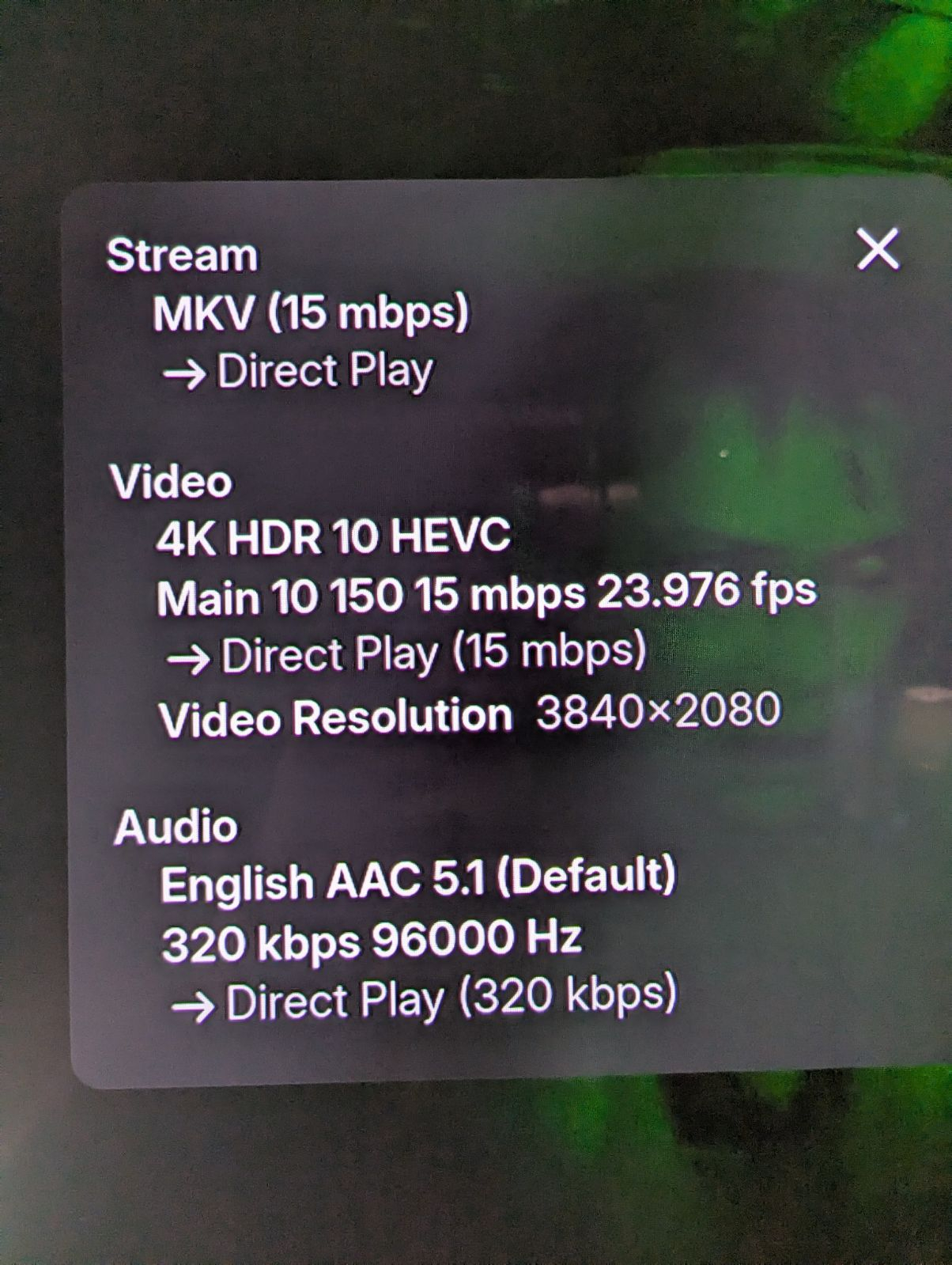

sgobat 4 Posted October 23, 2024 Posted October 23, 2024 I've been a long time user of Emby with multiple devices including older Samsung TVs. I just upgraded to a 2024 S90D with the latest Tizen OS, and install Emby and connected to my library. I use Unmanic to transcode all audio to AAC, but nothing seems to work with the TV at all. The output sound just crackles and pops. All other media apps on the TV work fine and play sound. All other devices worked as well. I would think AAC would be a supported audio format?

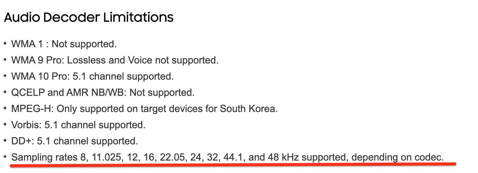

Solution SamES 1084 Posted October 23, 2024 Solution Posted October 23, 2024 Are all your tests with 96,000 Hz samples? Can you try some 48,000 Hz samples? https://developer.samsung.com/smarttv/develop/specifications/media-specifications/2024-tv-video-specifications.html#24TV_PREMIUM4-(UHD)
sgobat 4 Posted October 23, 2024 Author Posted October 23, 2024 I tried with and without soundbar, and also playing directly on TV via USB files with no luck; however, I tested with my Nvidia Shield and playback works with Emby via that, so definitely a Samsung video player issue? The few AAC playbacks I spot-checked did all have 96kHz playback. Let me see if I can find any with lower sampling rates (or is that something I can adjust in Emby or TV settings?)
SamES 1084 Posted October 23, 2024 Posted October 23, 2024 3 minutes ago, sgobat said: The few AAC playbacks I spot-checked did all have 96kHz playback. Let me see if I can find any with lower sampling rates (or is that something I can adjust in Emby or TV settings?) You will need to find a sample with 48kHz, or if you are converting files yourself, just convert to 48kHz.
sgobat 4 Posted October 24, 2024 Author Posted October 24, 2024 I've converted the files that weren't working before using ffmpeg to 48Khz AAC, and both worked! It seems the new Samsung TVs don't support >48Khz as you pointed out. Now I have some encoding to do... 1
SamES 1084 Posted October 25, 2024 Posted October 25, 2024 21 hours ago, sgobat said: I've converted the files that weren't working before using ffmpeg to 48Khz AAC, and both worked! It seems the new Samsung TVs don't support >48Khz as you pointed out. Now I have some encoding to do... Thanks for confirming. I believe 48kHz is the limit for all Samsung models (new and old)

SamES 1084 Posted March 18, 2025 Posted March 18, 2025 (edited) 13 hours ago, Luke said: Yes. Are we sure this is the reason? I expect so. According to the Samsung Video Specifications model matrix, 96kHz audio is not supported. Edited March 18, 2025 by SamES 1
