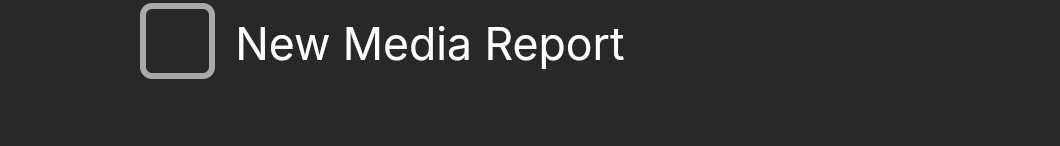

darkassassin07 674 Posted October 23, 2024 Posted October 23, 2024 If you install the 'playback reporting' plugin from the catalog; you get a new notification option 'New Media Report' that lists all newly added media since the last time the notification was triggered. You can then set the schedule via 'scheduled tasks' to daily, or whatever you'd like.
Teredactle 39 Posted October 23, 2024 Author Posted October 23, 2024 Thanks for this, I saw this workaround the other day, but for whatever reason I didn't think this would work. Giving it a go to see if it works. 1

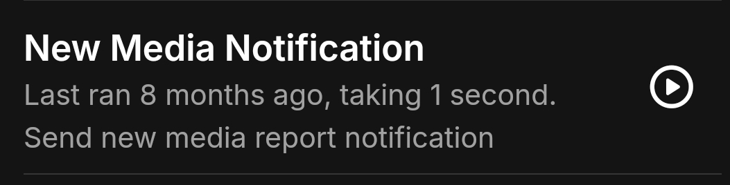

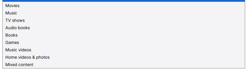

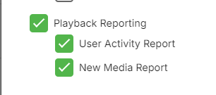

Teredactle 39 Posted October 24, 2024 Author Posted October 24, 2024 Ok so this workaround is not working - what I'm seeing is that this is actually not working. Notifications and emails ARE working as the tests are sent out; but there is a twofold problem here. 1.This setting below does NOT seem to target any media (photo/videos) in the libraries that are "Home videos & photos", which is really the only libraries I want added media notifications sent out for. When I look at the log files, I see that it looks at those libraries, but it shows nothing listed under them for new media, even though added tons of new media (and all that new media shows up on the home screen on the "Latest" feed). Not only that, but if I have "Library" "New Media Added", enabled, I do get an email notification for the new media added from those Home videos & photos libraries. 2.The other problem that I'm seeing, is that I get no notification at all as a New Media Report, even though I see that the log file shows that there is new media (below) So this is unclear to me. If I manually run the scheduled task again, it still shows the above as an added item in the log file. Does it not "reset" the findings; so the above line should not appear again in the log file when I rerun the scheduled task again, minutes later (or anytime later). I don't really know how this works, so maybe it's my misunderstanding, but I assume that when you run the "Playback Reporting - New Media Notification" task, it will check for new medias added from the last time it ran. So the log lines should all show no entries for new media. I just manually ran it again, and it's still showing the same entry, check out the time stamp. @Lukecould you please confirm either way, to me it looks like this isn't working correctly. Thanks!
Luke 42243 Posted October 24, 2024 Posted October 24, 2024 1 hour ago, Teredactle said: Ok so this workaround is not working - what I'm seeing is that this is actually not working. Notifications and emails ARE working as the tests are sent out; but there is a twofold problem here. 1.This setting below does NOT seem to target any media (photo/videos) in the libraries that are "Home videos & photos", which is really the only libraries I want added media notifications sent out for. When I look at the log files, I see that it looks at those libraries, but it shows nothing listed under them for new media, even though added tons of new media (and all that new media shows up on the home screen on the "Latest" feed). Not only that, but if I have "Library" "New Media Added", enabled, I do get an email notification for the new media added from those Home videos & photos libraries. 2.The other problem that I'm seeing, is that I get no notification at all as a New Media Report, even though I see that the log file shows that there is new media (below) So this is unclear to me. If I manually run the scheduled task again, it still shows the above as an added item in the log file. Does it not "reset" the findings; so the above line should not appear again in the log file when I rerun the scheduled task again, minutes later (or anytime later). I don't really know how this works, so maybe it's my misunderstanding, but I assume that when you run the "Playback Reporting - New Media Notification" task, it will check for new medias added from the last time it ran. So the log lines should all show no entries for new media. I just manually ran it again, and it's still showing the same entry, check out the time stamp. @Lukecould you please confirm either way, to me it looks like this isn't working correctly. Thanks! That's from a plugin. You will need to consult with the plugin developer.
Teredactle 39 Posted October 24, 2024 Author Posted October 24, 2024 3 hours ago, Teredactle said: Ok so this workaround is not working - what I'm seeing is that this is actually not working. Notifications and emails ARE working as the tests are sent out; but there is a twofold problem here. 1.This setting below does NOT seem to target any media (photo/videos) in the libraries that are "Home videos & photos", which is really the only libraries I want added media notifications sent out for. When I look at the log files, I see that it looks at those libraries, but it shows nothing listed under them for new media, even though added tons of new media (and all that new media shows up on the home screen on the "Latest" feed). Not only that, but if I have "Library" "New Media Added", enabled, I do get an email notification for the new media added from those Home videos & photos libraries. 2.The other problem that I'm seeing, is that I get no notification at all as a New Media Report, even though I see that the log file shows that there is new media (below) So this is unclear to me. If I manually run the scheduled task again, it still shows the above as an added item in the log file. Does it not "reset" the findings; so the above line should not appear again in the log file when I rerun the scheduled task again, minutes later (or anytime later). I don't really know how this works, so maybe it's my misunderstanding, but I assume that when you run the "Playback Reporting - New Media Notification" task, it will check for new medias added from the last time it ran. So the log lines should all show no entries for new media. I just manually ran it again, and it's still showing the same entry, check out the time stamp. @Lukecould you please confirm either way, to me it looks like this isn't working correctly. Thanks! @TeamB, Luke has suggested that you may be able to chime in on the above workings of the notifications combined with this plugin - I hope you don't mind me tagging you. If it's better, I can crosspost into the plugin thread. Thank you!
TeamB 2440 Posted October 24, 2024 Posted October 24, 2024 1. it only includes movies, tv show episodes and music https://github.com/faush01/playback_reporting/blob/9bfc4680983e99eed964bc6f4bca58cc8c829b72/playback_reporting/Tasks/TaskNotifictionMediaReport.cs#L123 2. it should include movies and tv show episodes that were added since the last time it was run https://github.com/faush01/playback_reporting/blob/9bfc4680983e99eed964bc6f4bca58cc8c829b72/playback_reporting/Tasks/TaskNotifictionMediaReport.cs#L144 you are seeing the log lines because they are output before the time cutoff check 1
