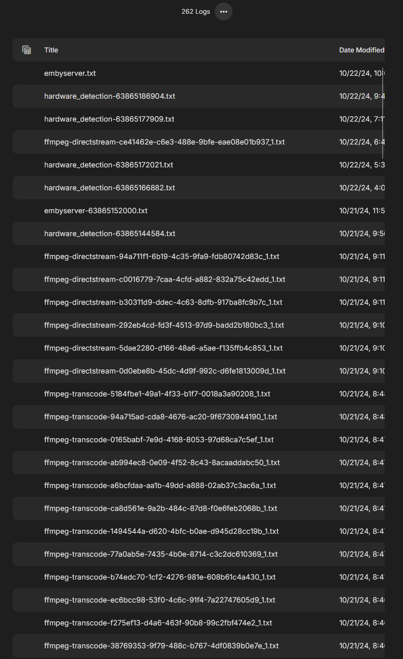

CheshireKitten 1 Posted October 22, 2024 Posted October 22, 2024 Hello, I have been using Emby for not too long but at least a month or two. I am having frequent pausing, stuttering, and outright not working in situations where the only solution is normally to restart everything or wait for hours if I am lucky. It happens on all devices. It's also as if the auto does not work or detect anything well as it says it always directly plays unless I set my internet speed in settings but not in the gear when playing a video as it does not work for me. I have no idea what may be happening and see no pattern... it happens even when playing things on my home network when trying to direct play. I'm unsure what logs you want as there are many.
Luke 42183 Posted October 22, 2024 Posted October 22, 2024 Quote I'm unsure what logs you want as there are many. Hi, please attach the ones that were written to during the time frame in which the problem was experienced. Thanks.
CheshireKitten 1 Posted October 26, 2024 Author Posted October 26, 2024 (edited) it seems something has changed like an update or something as it has been better lately, but today it happened again and other than hoping it works I'm unsure what to do even though the files are on a local machine or being watched on the same machine the files are on. embyserver.txt ffmpeg-directstream-84ff84c9-884d-494b-90c2-28c99399956b_1.txt ffmpeg-directstream-bcb9cd79-622d-4c58-b9c6-5beeff3f8f19_1.txt ffmpeg-transcode-33feb051-9597-4f6f-9ee7-bcd214041c51_1.txt ffmpeg-transcode-46b646bf-3775-40e7-8a4f-bbe650b78294_1.txt ffmpeg-transcode-249a1847-9bf4-4b66-963a-b2694a0dcd6e_1.txt ffmpeg-transcode-842c781a-e5c2-4e93-8a73-aeb776752ddd_1.txt ffmpeg-transcode-962100e9-9be2-4758-b3a0-1dc3d92815e6_1.txt ffmpeg-transcode-b78b0762-bfa3-4064-bf61-aba5bbce52f1_1.txt ffmpeg-transcode-c7aaf074-0f42-40ad-bd2d-271b80692307_1.txt ffmpeg-transcode-d3677ae4-1815-4d04-b29e-88a278f7611c_1.txt ffmpeg-transcode-dad36651-cd35-4584-bba0-b238de3c490b_1.txt ffmpeg-transcode-e93915fd-f242-4c08-a3bb-ef3e59454190_1.txt Edited October 26, 2024 by CheshireKitten forgot files
