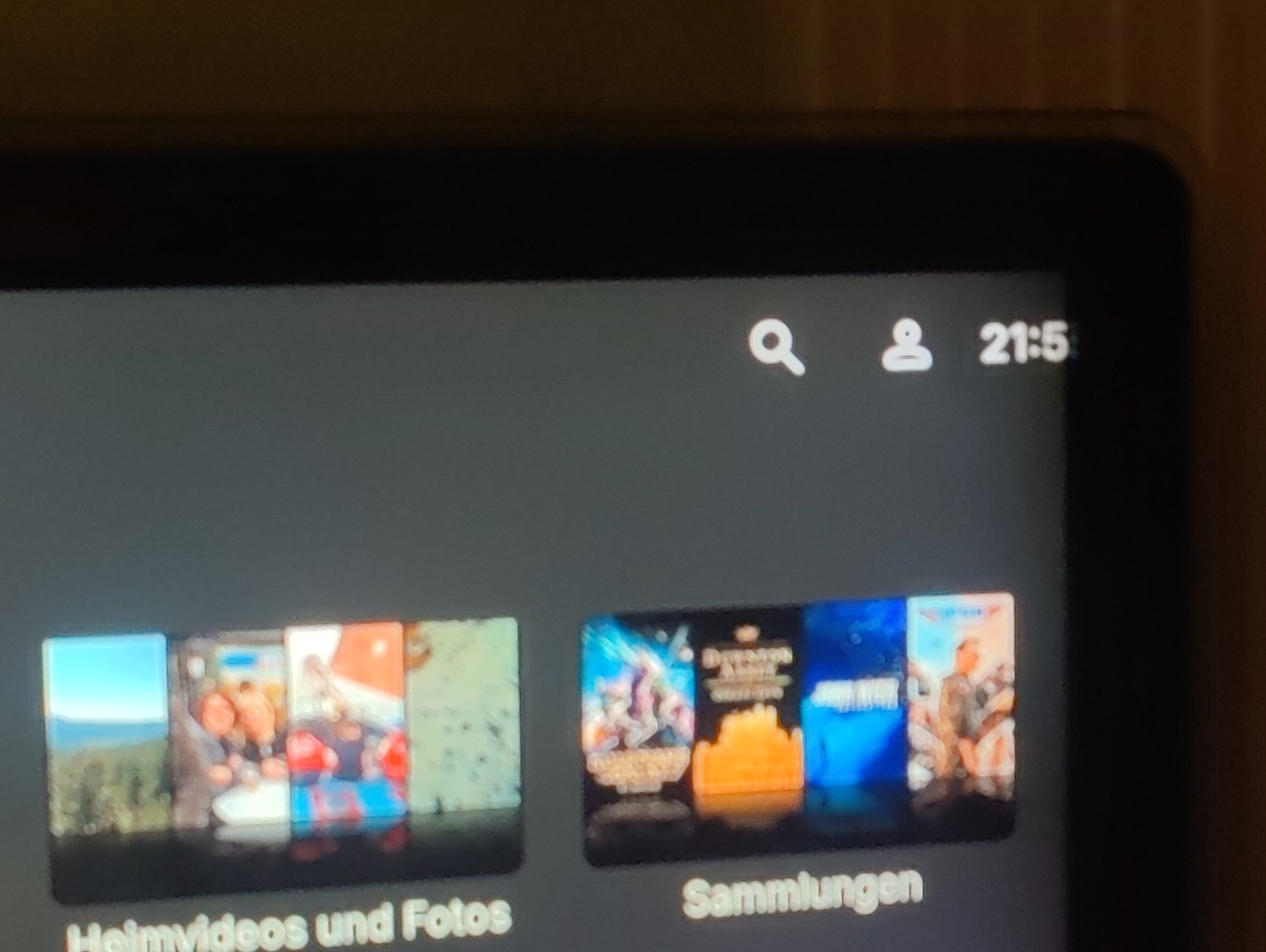

Doppellhelix 17 Posted October 22, 2024 Author Posted October 22, 2024 Oh. I didn't know there were two Emby apps. Yes, everything works perfectly with the official app. Only the picture would have to be moved a little to the left. The clock at the top right is only half visible. Can I scale the image in the app somewhere? Thanks for your help
Luke 42243 Posted October 22, 2024 Posted October 22, 2024 7 minutes ago, Doppellhelix said: Oh. I didn't know there were two Emby apps. Yes, everything works perfectly with the official app. Only the picture would have to be moved a little to the left. The clock at the top right is only half visible. Can I scale the image in the app somewhere? Thanks for your help HI, can you show a screenshot example? Thanks.
Doppellhelix 17 Posted October 22, 2024 Author Posted October 22, 2024 (edited) I've tested with two different TVs. At both of them is the Screen a little bit more to the right side. Edited October 22, 2024 by Doppellhelix

rbjtech 5344 Posted October 23, 2024 Posted October 23, 2024 Maybe a TV setup overscan issue ? @Doppellhelix In the TV settings, see if there is an overscan option and turn it on/off as the picture essentially does not fit on the physical screen - it will correct all displays, not just emby.

Doppellhelix 17 Posted October 25, 2024 Author Posted October 25, 2024 Hello. I have managed it with the TV settings. Thanks for your help. Greetings Helix
