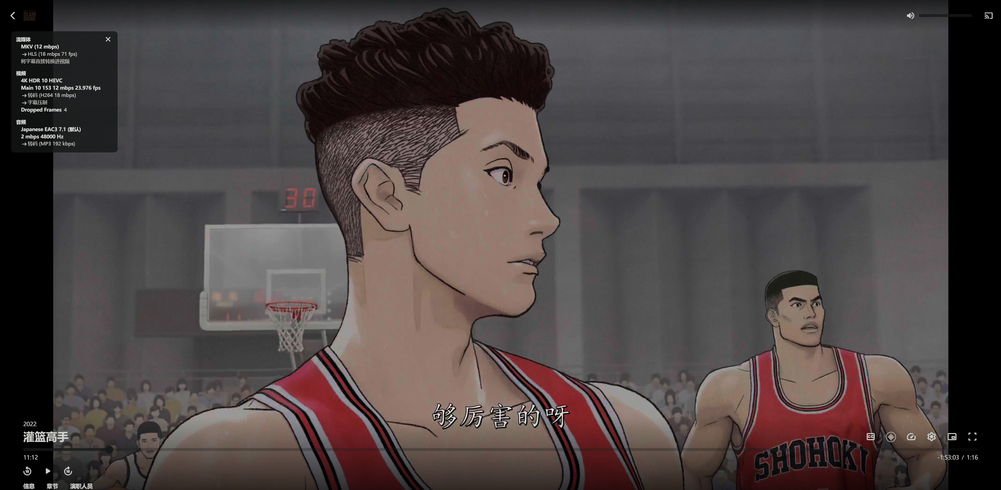

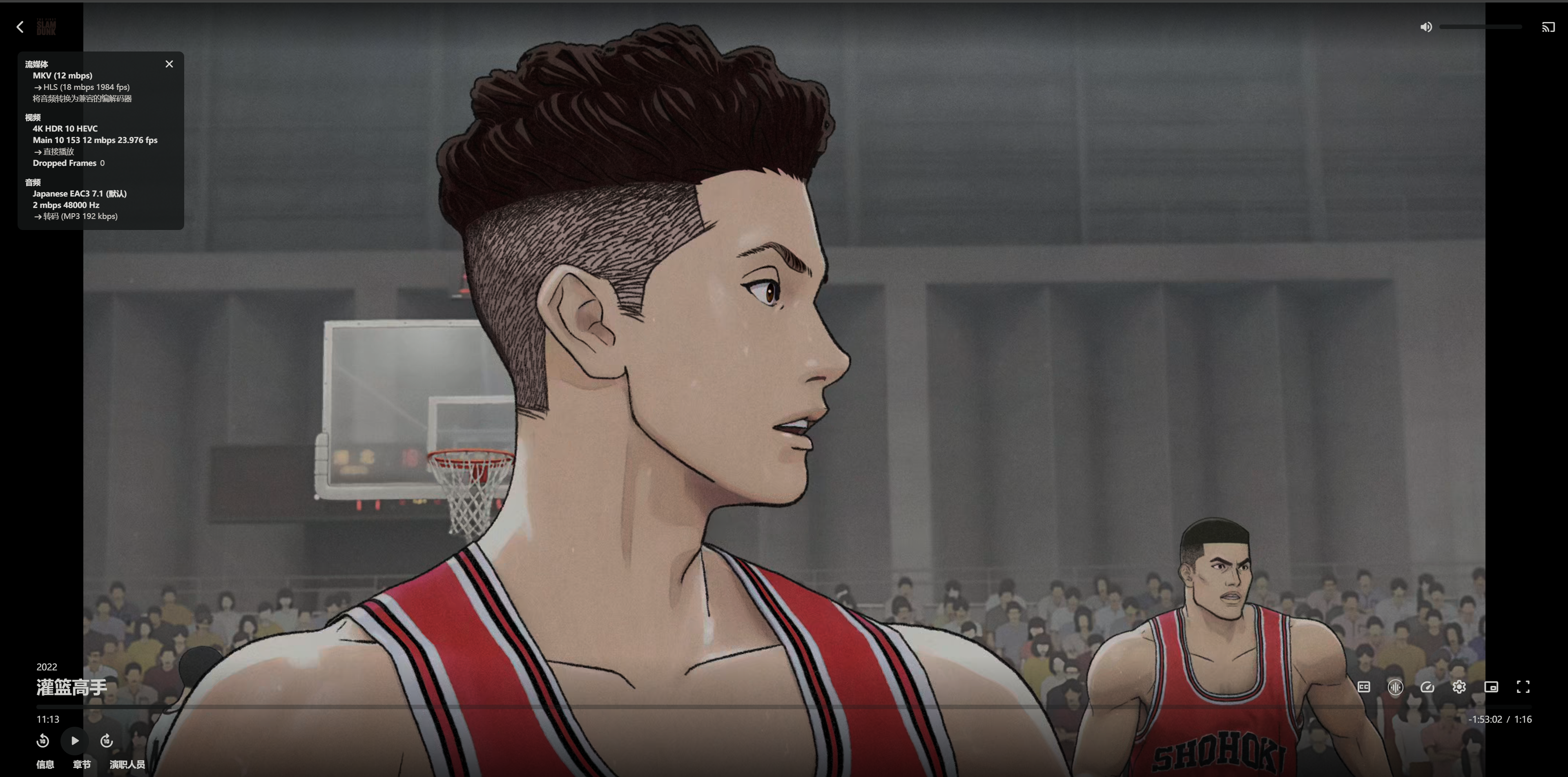

hooray00 1 Posted October 22, 2024 Posted October 22, 2024 Why does the video quality decrease when subtitles are enabled? What are some possible solutions?

Solution pwhodges 2132 Posted October 22, 2024 Solution Posted October 22, 2024 If the subtitles are graphical (PGS or VobSub) and the client can't play them, they will be burnt in at the server, which requires transcoding, and consequent loss of quality. If you are able to get hold of SRT subtitles, these can normally be played by the client, avoiding this issue. Paul 3
hooray00 1 Posted October 23, 2024 Author Posted October 23, 2024 21 hours ago, Luke said: @hooray00what format subtitles? PGSSUB @Luke
hooray00 1 Posted October 23, 2024 Author Posted October 23, 2024 20 hours ago, pwhodges said: If the subtitles are graphical (PGS or VobSub) and the client can't play them, they will be burnt in at the server, which requires transcoding, and consequent loss of quality. If you are able to get hold of SRT subtitles, these can normally be played by the client, avoiding this issue. Paul Thank you for your answer 1
