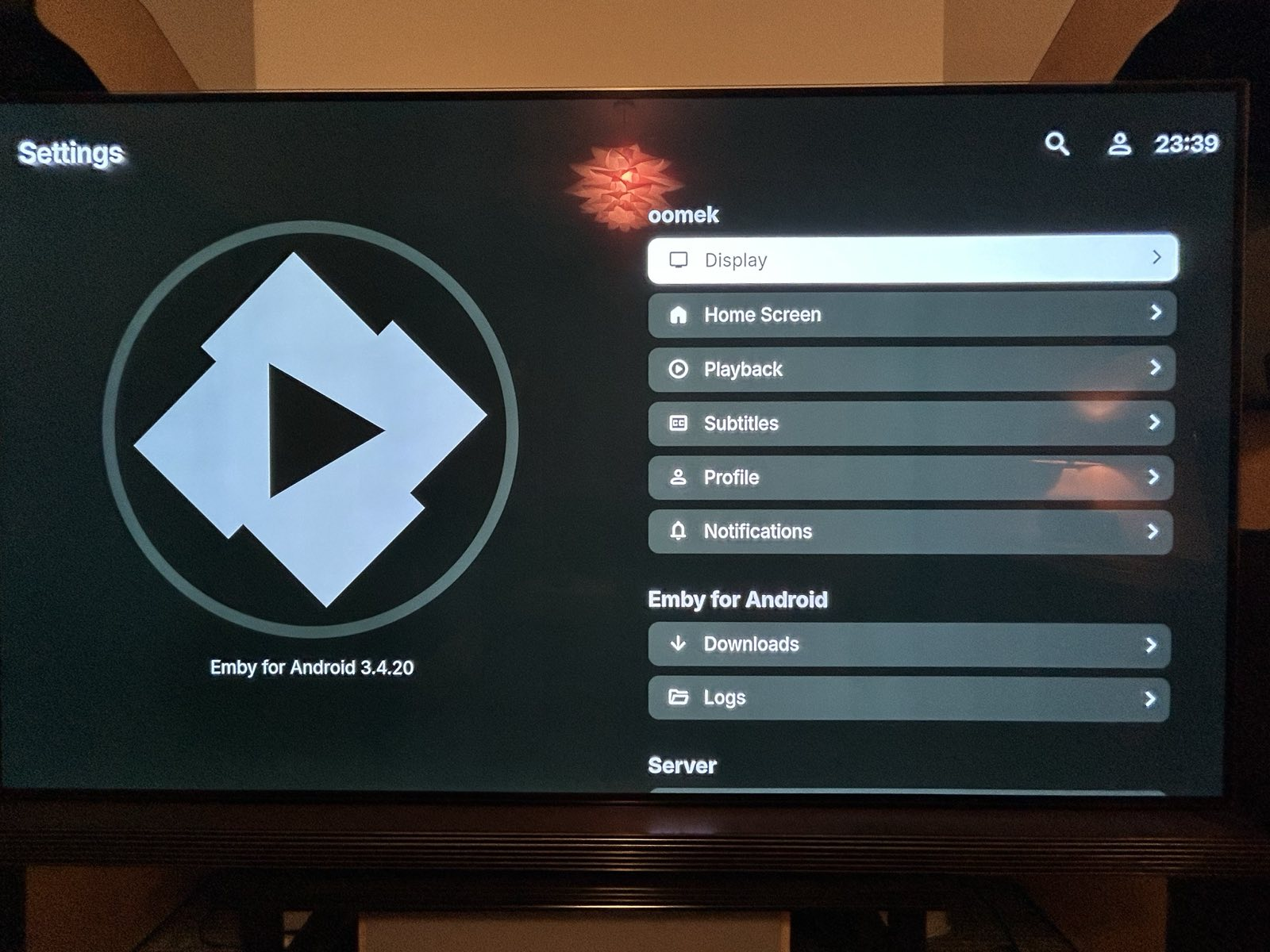

Oomek 3 Posted October 22, 2024 Author Posted October 22, 2024 (edited) 13 hours ago, Luke said: @Oomek Hi there, let's look at an example. Please attach the information requested in how to report a media playback issue. Thanks! @Luke Would you please explain how to enable debug mode in Android TV app. The instructions from the link are not clear. This stutter is unbearable. Edited October 22, 2024 by Oomek

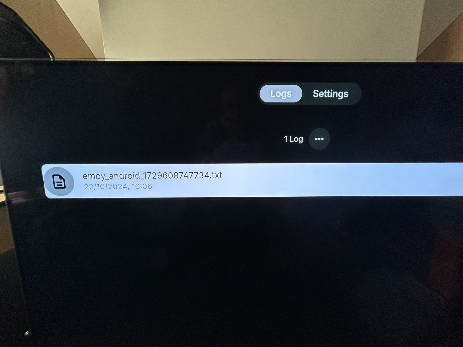

Oomek 3 Posted October 22, 2024 Author Posted October 22, 2024 I've managed to find this debug option and I've generated a log, but I still do not see the Send Log button. How do I send it? Quote Now there will be a new tile on your home page settings row (or menu option on the user menu at the top) labelled "Send Log".

ebr 16335 Posted October 23, 2024 Posted October 23, 2024 Hi. The instructions you are following for sending the log are for a different app. You can just attach the log here.
Oomek 3 Posted October 23, 2024 Author Posted October 23, 2024 Thanks for the reply. I'd like to share it, but how do I get it out of Chromecast? The share button isn't working.
