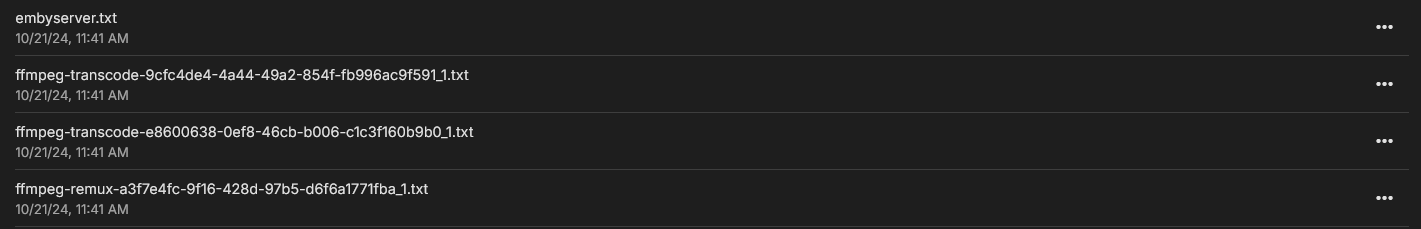

solidsnakex37 55 Posted October 21, 2024 Posted October 21, 2024 I am trying to figure out why, when playing a certain movie on a web browser (FireFox/Chrome) I get the error No compatible streams are currently available. Please try again later or contact your system administrator for details. This also happens when playing it on Chromecast, but the movie has no issue direct playing via Nvidia Shield or Emby Theater. The logging seems like it's having an issue remuxing the file, it first attempts to do an ffmpeg-remux, then it tried 2 transcodes and then returns the error. Another odd observation, is that if I jump to a chapter, it will play the movie. But when playing from the beginning, I have the issue. I zipped up another set of logs when jumping to Chapter 2 which plays the movie file, for comparison. I can't figure out what the issue is on this one, appreciate the help hardware_detection-63865104068.txt ffmpeg-remux-a3f7e4fc-9f16-428d-97b5-d6f6a1771fba_1.txt ffmpeg-transcode-e8600638-0ef8-46cb-b006-c1c3f160b9b0_1.txt ffmpeg-transcode-9cfc4de4-4a44-49a2-854f-fb996ac9f591_1.txt embyserver.txt Jump to Chapter 2 (working).zip
