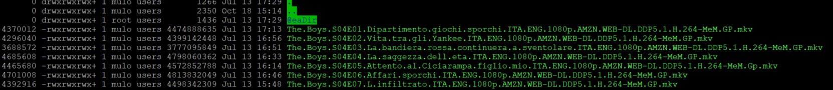

mmoz77 0 Posted October 22, 2024 Author Posted October 22, 2024 Ok, I found a work around to delete @eaDir in a cron job, now my directory listing is the following, but Emby still says that directory is not empty... and it's right, but is full of file that it should be able to delete... like it does on the usb connected drive

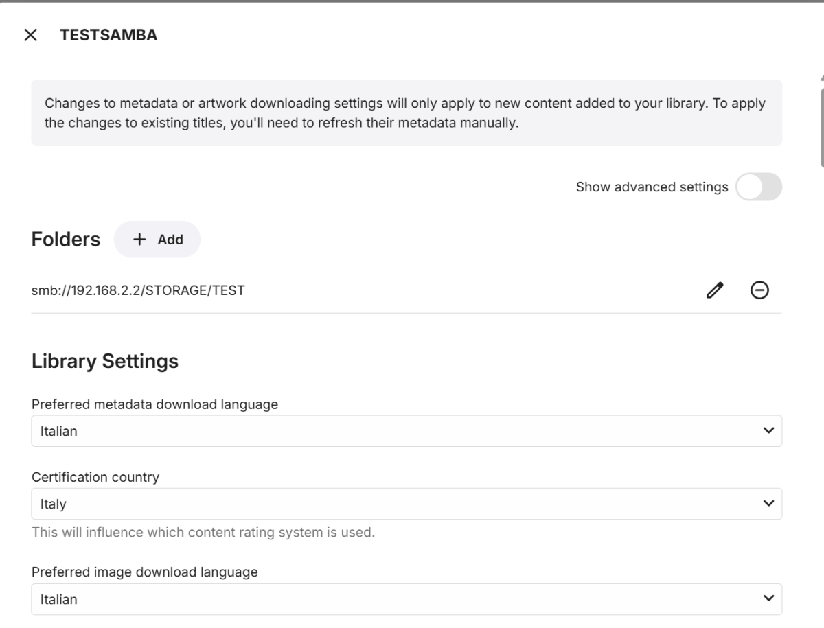

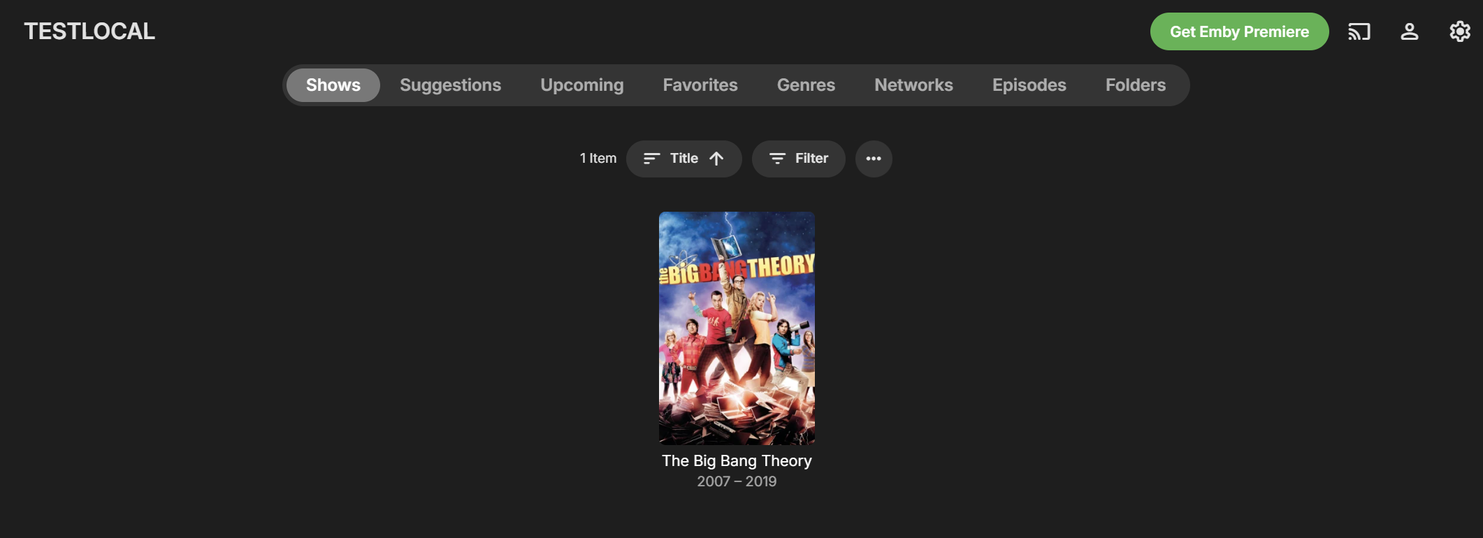

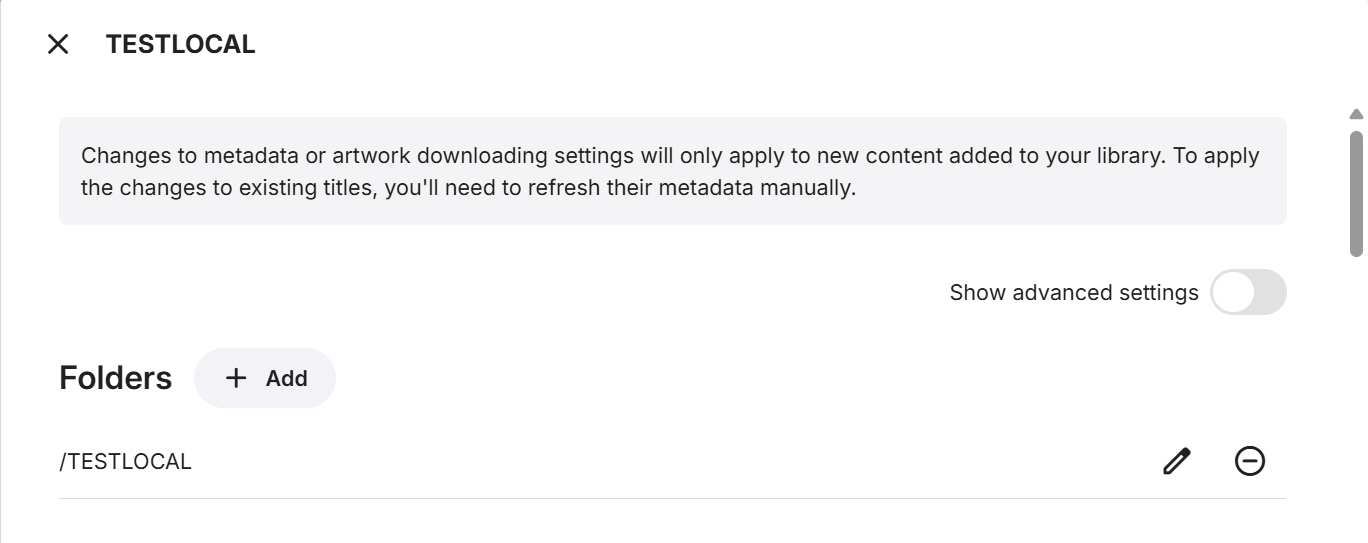

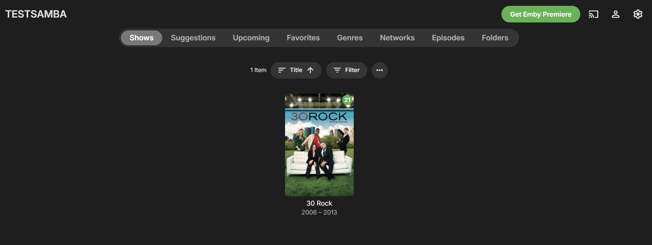

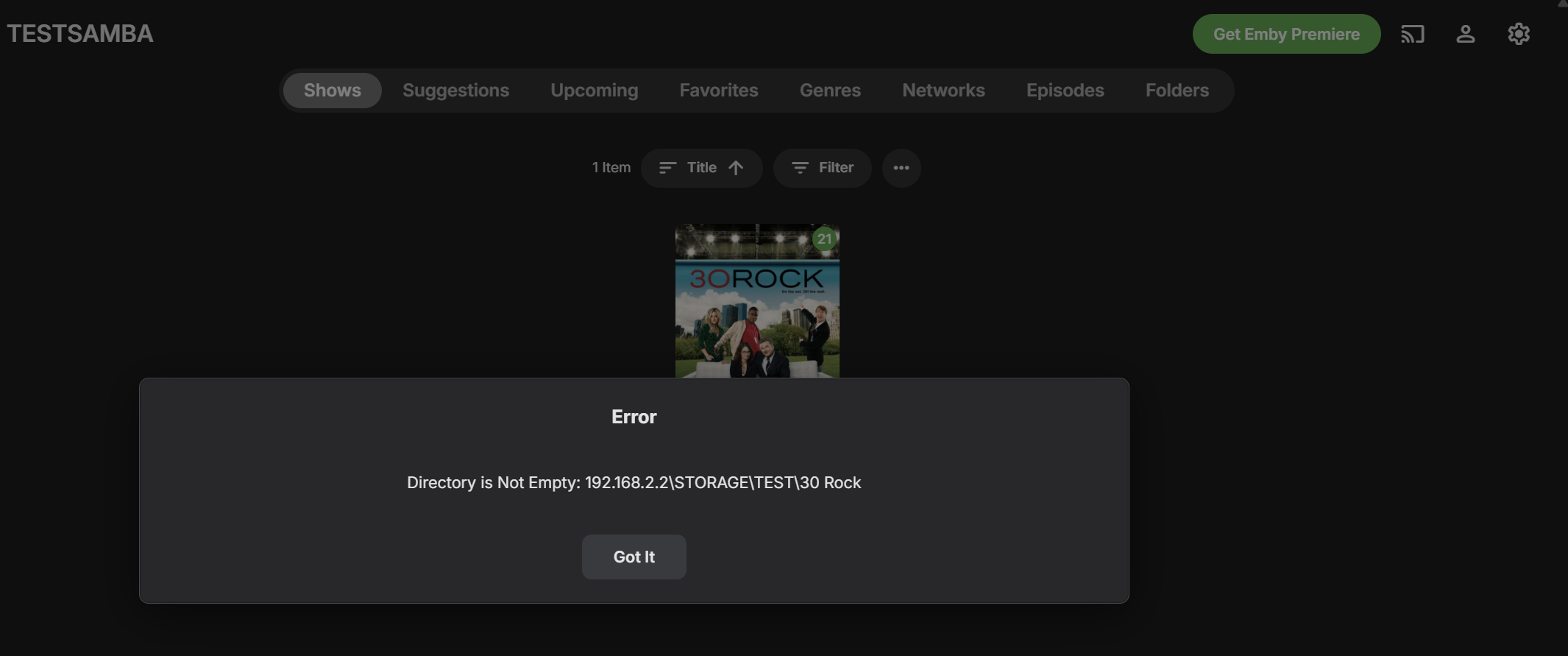

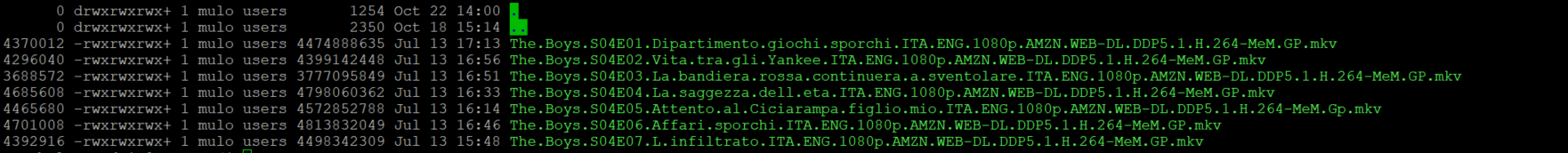

mmoz77 0 Posted October 24, 2024 Author Posted October 24, 2024 (edited) I should made what you asked. definition of test samba library definition of test local library how emby sees my testsamba lib and how sees testlocal Content of TESTLOCAL after the deletion of the show (I'm inside the docker image running) Content of TESTSAMBA after the unsuccessful deletion of the show (I'm on the NAS, mulo is the user that Emby use to connect via samba) The deletion error embyserver (1).txt Edited October 24, 2024 by mmoz77 wrong screenshot
sa2000 697 Posted October 24, 2024 Posted October 24, 2024 7 hours ago, mmoz77 said: I should made what you asked. Thanks for doing the test. So the issue is only for smb paths where we are not removing the child media items before removing the parent I will pass it to the development team. I cannot say at this stage if this is an smb restriction.
sa2000 697 Posted November 22, 2024 Posted November 22, 2024 @mmoz77FYI This has been fixed in the new Emby Server beta released today - 4.9.0.32. I don't know when that will make it into the public release.
