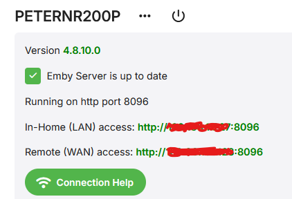

ZuluKing91 0 Posted October 20, 2024 Posted October 20, 2024 (edited) My ports are setup in Win 11 Firewall to let through 8096 and 8620. I'm still struggling to get the SSL certificates in order. Got one via Nginx Proxy Manager, got dns domain via duckdns and can make SSL certficates. I don't know how to make sure its working with Emby so for now, I've just 8096 port to work with. No clue why I cant connect to my server on the mobile android app Emby. If i just follow the steps in fill the above information in the LAN setup wont work. If i use my data and connect throught the WAN, it does work. But for obvious reasons I would like to use my wifi aswell as I also got an ATV where i want to setup the LAN server for my Emby app. Some more information: I've setup my router to allow ipv6, setup port forwarding for Emby Server with my-ip-adress port 80, my-ip-adress port 81, my-ip-adress port 443 I've setup a static ip adres which is the same as in my port fowards. (ipconfig tells me this is the case) Could someone tell me what exactly im doing wrong here? Edited October 20, 2024 by pmcsmolders@gmail.com
Luke 42242 Posted October 20, 2024 Posted October 20, 2024 Hi there, what exactly happens when you try to connect within your LAN?
ZuluKing91 0 Posted October 20, 2024 Author Posted October 20, 2024 Silly of me to forget the error message. Can't reach the server. At this time it's not possible to reach this server. Check if the server is active and try again.
Luke 42242 Posted October 22, 2024 Posted October 22, 2024 On 10/20/2024 at 1:58 PM, ZuluKing91 said: Silly of me to forget the error message. Can't reach the server. At this time it's not possible to reach this server. Check if the server is active and try again. Did you customize any settings in the Network section of Emby server settings?

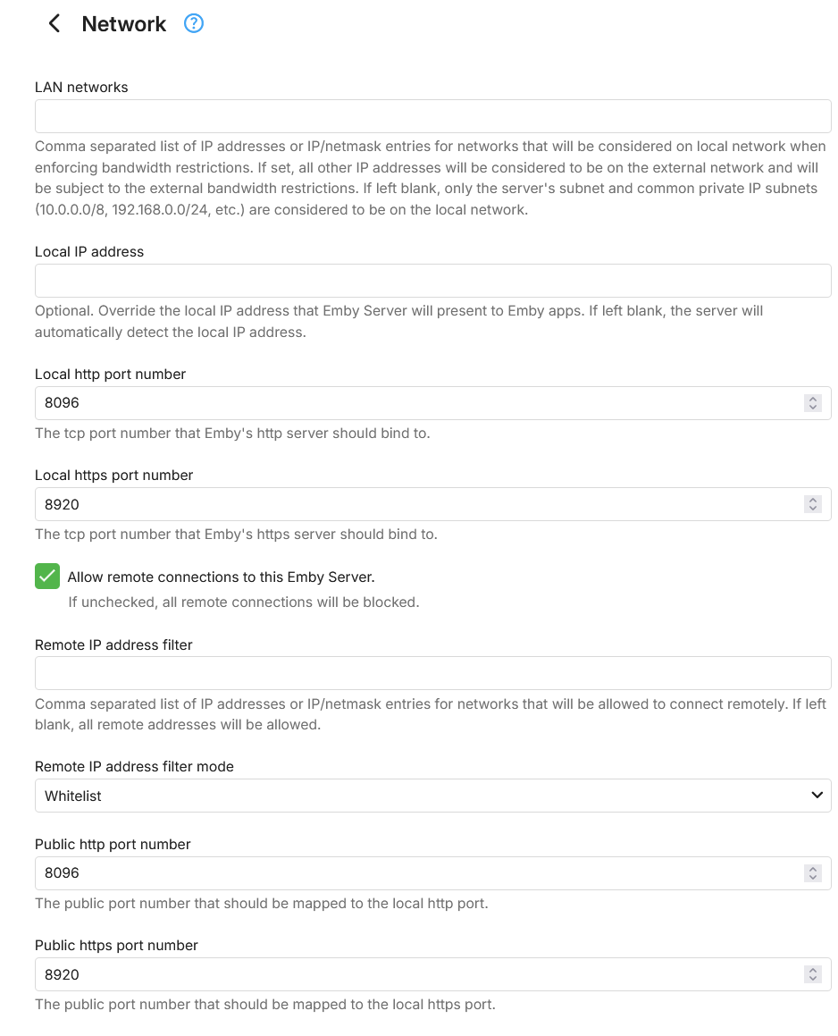

ZuluKing91 0 Posted October 22, 2024 Author Posted October 22, 2024 Tried quite a few things, this is my network settings page
Luke 42242 Posted October 23, 2024 Posted October 23, 2024 OK do you know the correct lan ip address of your server machine?

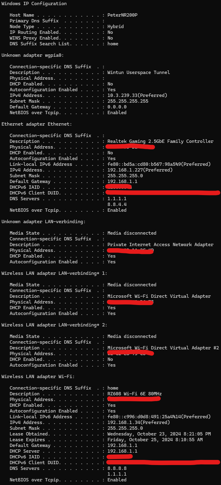

pwhodges 2033 Posted October 23, 2024 Posted October 23, 2024 Are you sure that the wifi is using the same subnet as the wired network? They can be different to allow for controlling guest connectionss, for instance. If the subnet is different, you can add it to the local subnet list in Emby; you may also need to ensure that the router is passing the connection through from the wifi to the main local net (the reason for it to be different, if it is, is precisely to to prevent this, so it may be easiest to turn off any guest routing altogether). Paul

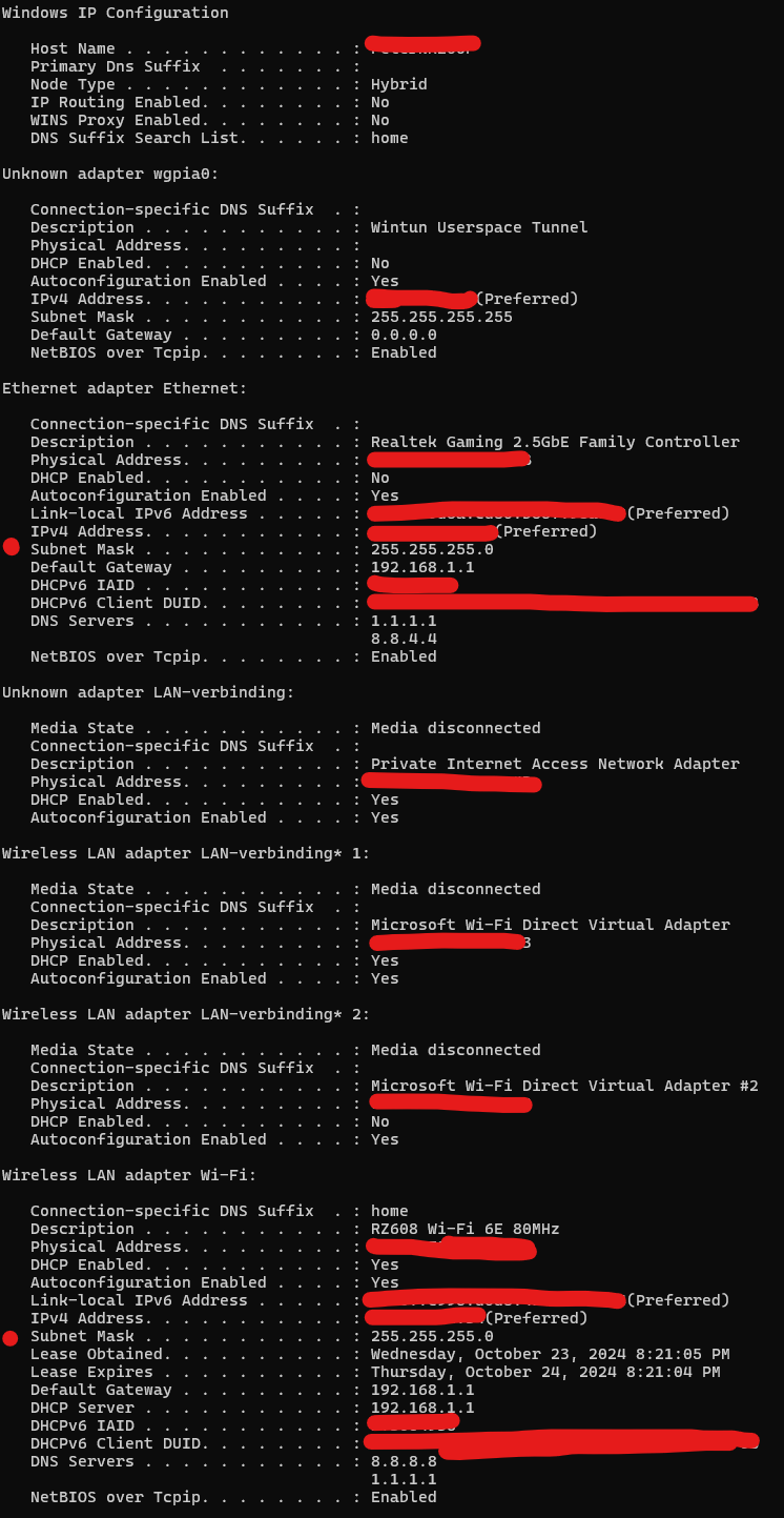

ZuluKing91 0 Posted October 23, 2024 Author Posted October 23, 2024 Ah interesting @pwhodgesI'll try and find if it matters if i'm on the same subnet. I do have a guest wifi setup for security reasons. Just ran my pc with ethernet + vpn + wifi guest to see ipconfig /all. I'm a networking noob so maybe you can see something I'm doing wrong.
pwhodges 2033 Posted October 23, 2024 Posted October 23, 2024 By covering up the actual IP addresses (which, being internal, are not a security risk) you have removed the exact information required to make any further comment on this! Paul

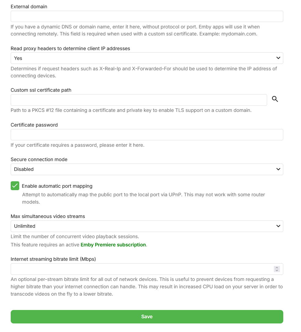

Carlo 4561 Posted November 13, 2024 Posted November 13, 2024 On 10/20/2024 at 11:33 AM, ZuluKing91 said: My ports are setup in Win 11 Firewall to let through 8096 and 8620. Was that a type on the 8620? Emby normally used 8096 and 8920. Check windows firewall to make sure those two ports are open for both private and public networks. On 10/20/2024 at 11:33 AM, ZuluKing91 said: I've setup my router to allow ipv6, setup port forwarding for Emby Server with my-ip-adress port 80, my-ip-adress port 81, my-ip-adress port 443 I've setup a static ip adres which is the same as in my port fowards. (ipconfig tells me this is the case) The above are three separate port forwards you have setup? What are you doing with ports 80, 81 and 443? Where are your ports for 8096 and 8920? You can for example allow: all inbound port 80 traffic - > server IP port 8096 all inbound port 443 traffic - > server IP port 8920 But then you need to change the public port numbers in the network menu settings You didn't tell us anything about the nginx setup which determine how many items in the network settings menu need to be configured. For example, you'll have your router forward ports to what nginx is setup to listen on. You'll need to have either Emby or nginx configured to handle your domain and certificates. Typically, you'll have nginx sending traffic to Emby over 8096 port unencrypted and have Emby setup to use reverse proxy mode with options to look for actual client IP address in the packet headers. Emby's public ports will then be set to the ports forwarded on your router. Emby's public port assignments aren't what Emby listens on but how the packets are marked to allow the port forwarding and nginx forwarding trickery to take place. Carlo
