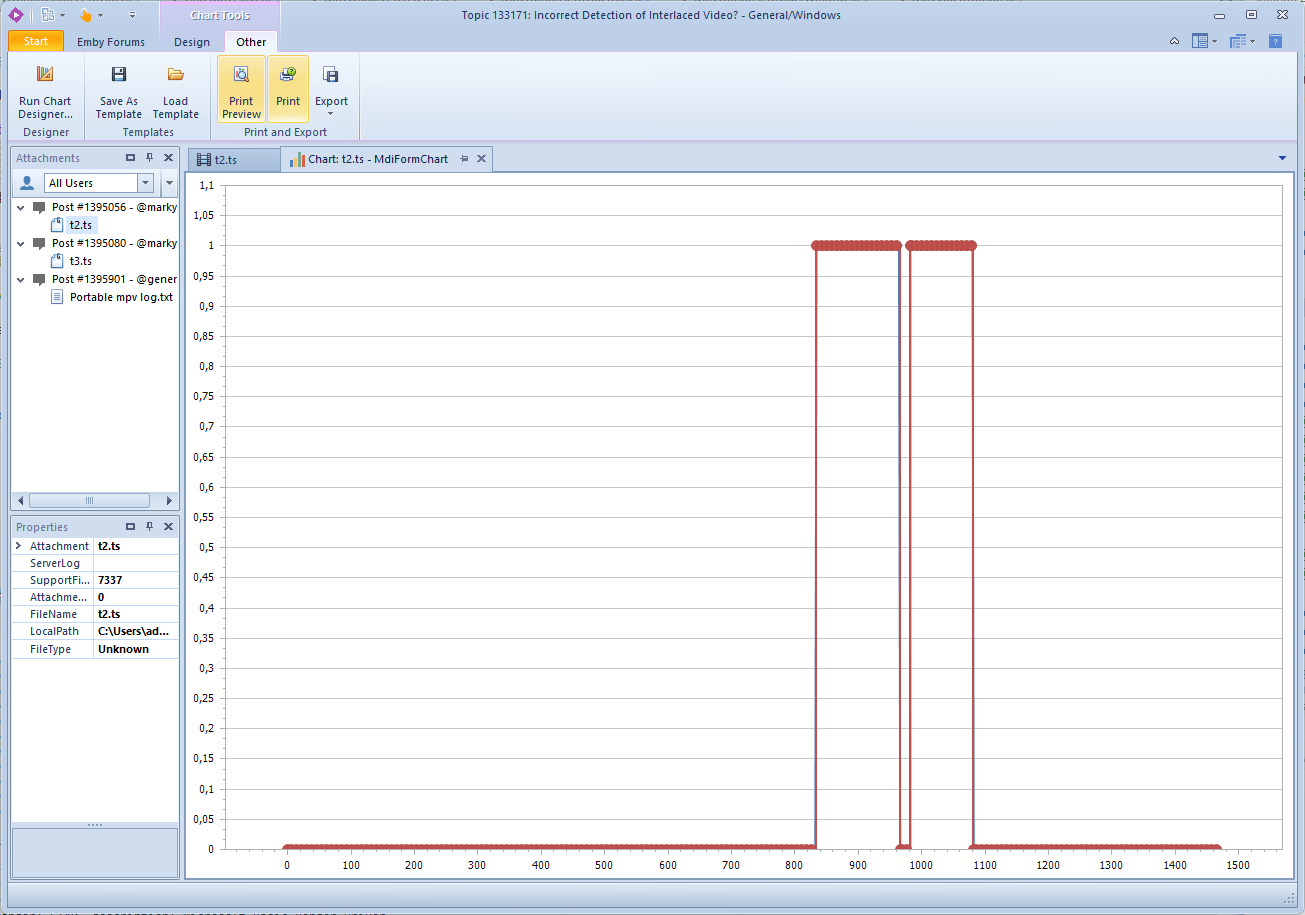

softworkz 5135 Posted October 23, 2024 Posted October 23, 2024 You are right. In the video above, I had probed just 500 frames. But when I probe all ~1500 frames, there are in fact two periods with interlaced frames:
Guest Posted October 23, 2024 Posted October 23, 2024 5 minutes ago, softworkz said: You are right. In the video above, I had probed just 500 frames. But when I probe all ~1500 frames, there are in fact two periods with interlaced frames: And if that were a live stream, deinterlacing wouldn't be active either
