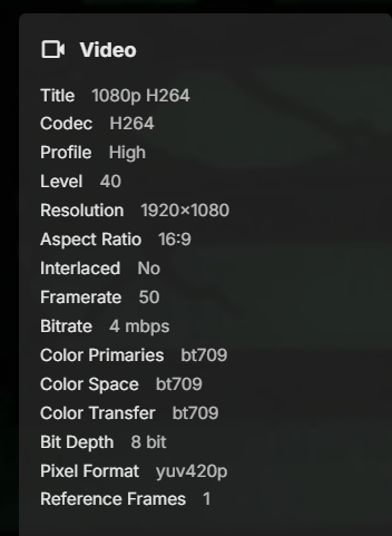

markyp 38 Posted October 20, 2024 Posted October 20, 2024 The included sample is from a recorded video from Live TV in the UK... here are the details of the original video reported by Emby Server: note the framerate... @softworkz t2.ts
visproduction 338 Posted October 20, 2024 Posted October 20, 2024 TV frame rates in the UK are 25 fps. Since it is 1080P 16:9 there should be no interlace. The example video plays back correctly as sequential but compressed frames, not interlaced.

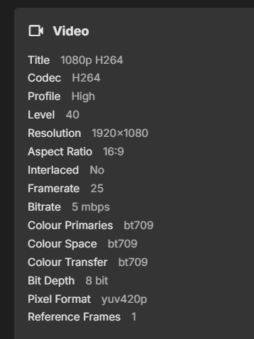

markyp 38 Posted October 20, 2024 Author Posted October 20, 2024 this might be a better example - taken from the actual game! t3.ts

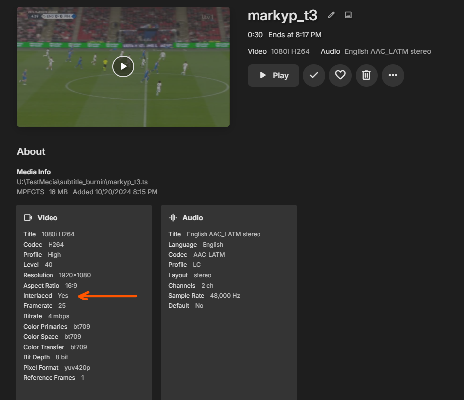

softworkz 5135 Posted October 20, 2024 Posted October 20, 2024 @markyp- Thanks for posting the files. The first one, t2.ts is not interlaced. And when I add t3.ts to Emby it is correctly identified as interlaced: Do you see a different result?

markyp 38 Posted October 21, 2024 Author Posted October 21, 2024 (edited) T2 and T3 are samples taken from the same recording! Emby Server identifies the original recorded file as not interlaced as seen in the 1st post... but T3 is not! Edited October 21, 2024 by markyp
softworkz 5135 Posted October 21, 2024 Posted October 21, 2024 (edited) From which source was that recording made? 39 minutes ago, markyp said: T2 and T3 are samples taken from the same recording! And what exactly do you mean by that? Samples from the same .ts file? How did it happen that one part is interlaced and the other not? And also - what do you expect Emby to do? A single file can only be marked as interlaced or as not interlaced Edited October 21, 2024 by softworkz

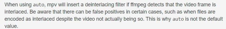

softworkz 5135 Posted October 21, 2024 Posted October 21, 2024 49 minutes ago, generiq said: I've always maintained that the video player should be responsible for choosing to deinterlace. MPV docs are mentioning false-positives at the frame level as the reason why "auto" is not the default for the --deinterlace option. That's why I'm currently enabling this only when Emby has probed a file as being interlaced. Probably it needs to be extended to always insert it when it comes from a .ts file.

Guest Posted October 21, 2024 Posted October 21, 2024 14 minutes ago, softworkz said: MPV docs are mentioning false-positives at the frame level as the reason why "auto" is not the default for the --deinterlace option. That's why I'm currently enabling this only when Emby has probed a file as being interlaced. Probably it needs to be extended to always insert it when it comes from a .ts file. But it operates on a frame by frame basis. So if it gets some frames incorrectly identified, the overall result is good. And in this case, if they were watching the live stream and began with progressive commercials, the actual show wouldn't be deinterlaced. This is much worse than some frames not being correctly identified and deinterlaced/not deinterlaced. My mpv deinterlacing config has never failed to provide a deinterlaced output. I'll take dynamic deinterlacing over static every time.
softworkz 5135 Posted October 21, 2024 Posted October 21, 2024 4 minutes ago, generiq said: But it operates on a frame by frame basis. So if it gets some frames incorrectly identified I don't think it's about "some frames". In that case, they could have made "auto" the default setting. The way I understand it, is that in "some cases" all frames are marked incorrectly.
Guest Posted October 21, 2024 Posted October 21, 2024 4 minutes ago, softworkz said: The way I understand it, is that in "some cases" all frames are marked incorrectly. As it is in this case.

Guest Posted October 22, 2024 Posted October 22, 2024 6 hours ago, softworkz said: MPV docs are mentioning false-positives at the frame level as the reason why "auto" is not the default for the --deinterlace option. That's why I'm currently enabling this only when Emby has probed a file as being interlaced. Probably it needs to be extended to always insert it when it comes from a .ts file. So, the manual says this: The example being incorrect encoding. I believe we can rule that out, as you have established how the server does this....correctly, yes? And if a file were incorrectly encoded, the server would also incorrectly detect interlacing. So the next question is, do you trust ffmpeg to detect interlacing, correctly? That caution was written a long time ago, and I would think you and your comrades have made improvements since then? Next question. This is the property I use to detect interlacing. video-frame-info/interlaced I assume this is using ffmpeg? I've used it for a long time in my mpv.conf, and it has not failed me. So, apparently this all hinges on ffmpeg detection, for the server and mpv.
