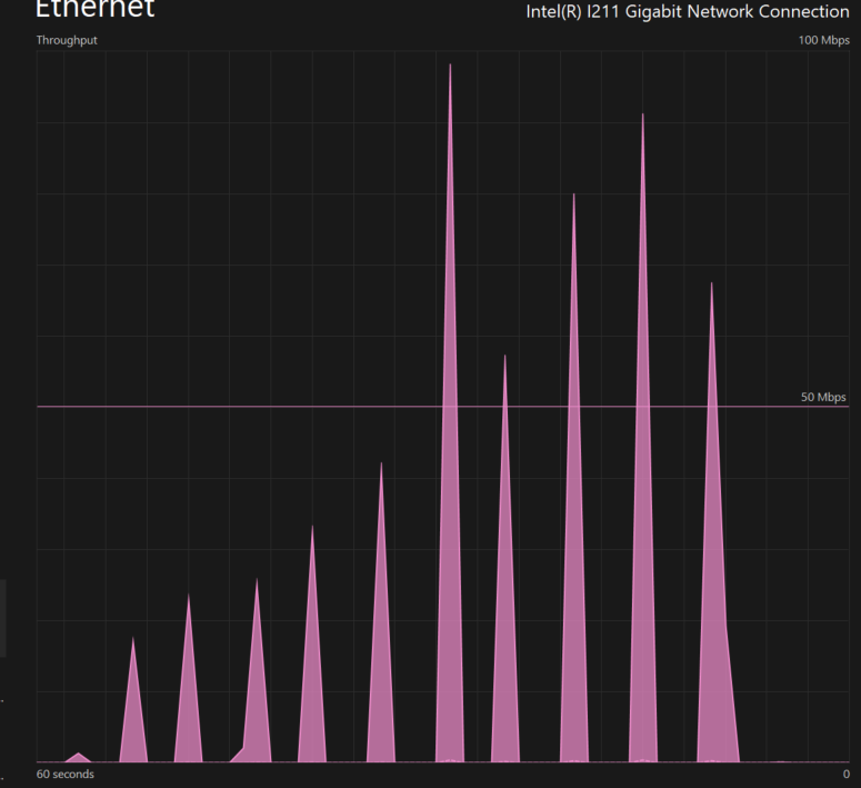

Jerren 19 Posted October 19, 2024 Posted October 19, 2024 Hey, i recently aquired a 4k monitor and wanted to check the differences ( coming from a 1080p monitor) but when i try 4k it will play the first few seconds, stutter for a couple seconds and then it just repeats itself. If i pause the video and let it "buffer" so to speak then it can play a bit longer but the stuttering will happen again depending on how long i wait to resume playing the video. Added the latest server log, transcode file and a screenshot of my network activity as i was noticing the stutter. Tried with 7.1 audio and ac3 5.1 but didn't matter. Got a ryzen 7 2700x and RTX 4070 in my pc and i use emby in a browser. Tried Firefox and Chrome but both had the same issue. Hope someone can help out. embyserver.txt ffmpeg-transcode-a23d7054-5e07-40d1-906f-27064f11ae0a_1.txt
Lessaj 486 Posted October 20, 2024 Posted October 20, 2024 Your software encoder is too slow, only roughly 0.66 speed. Do you have premier which allows for hardware acceleration? You could also try playing with Emby Theater instead of your web browser.

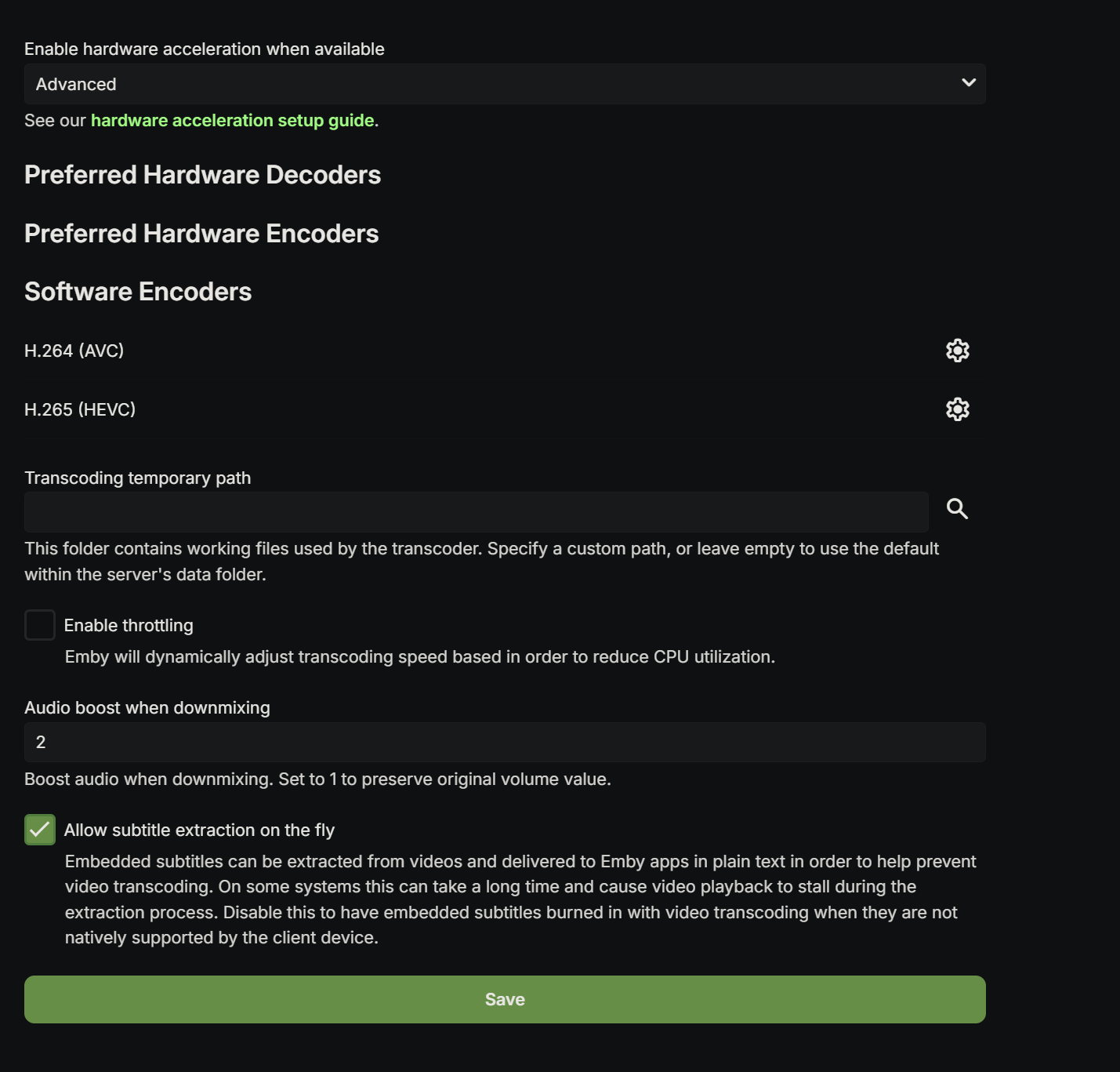

Happy2Play 9814 Posted October 20, 2024 Posted October 20, 2024 (edited) You got lucky this time as the same video did not throw a directplayerror and was able to copy video and convert audio. But need to protentially troubleshoot your Hardware as it does not appear to be showing any available hardware for HWA. @JerrenCan you show a screenshot of Transcoding-Enable hardware acceleration when available set to Advanced. As I don't see the RTX 4070 in server or Hardware-Detect log. Edited October 20, 2024 by Happy2Play
Jerren 19 Posted October 20, 2024 Author Posted October 20, 2024 (edited) Ah ok. Well my NAS doesn't have a 4070, my pc does. My NAS has an i7-4770K and no gpu since if i recall correctly GPU passthrough wasn't a thing for Emby on Truenas Core. Also why does it need to transcode? It's a 4k file playing to a 4k monitor so it should be directplay right? Or am i missing something? I did look into going towards Truenas Scale once but since it supposedly didn't have a performance impact i postponed it. Here's the Screenshot @Happy2Play Edited October 20, 2024 by Jerren

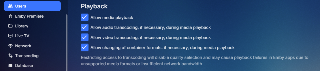

Jerren 19 Posted October 24, 2024 Author Posted October 24, 2024 Oh no i guess i mis explained? The audio isn't an issue. Atleast i don't think it's an issue, directplay works when i turn of the allow transcode video option. I just don't really want to turn that off as i don't need a 1080p stream to my phone if i want to watch family guy while waiting somewhere. Can't really find anything related to firefox or chrome either when it comes to 4k file playing. It probably doesn't matter in comparison but for example playing a 4k vid on youtube and checking that stats for nerds option, buffer health is between 6 and 11 seconds +- and no stutter. Not sure what else i can try.

Happy2Play 9814 Posted October 25, 2024 Posted October 25, 2024 In the end you can disable allow video transcoding to maybe bypass whatever the browser player is chocking on but may run into other playback issues per the note for the settings. And 4K via old hardware will be challenging as it will not handle transcoding very well if at all. But may want to look at a different client then a Browser also or even different browser as mentioned above.

Jerren 19 Posted November 1, 2024 Author Posted November 1, 2024 I do still have the issue when using Chrome or Firefox. When i disallow the transcoding it does directplay as it should but i want to keep the transcoding functionality. That post was in relation to turning off transcoding on my user. I'm not sure why emby does not get the info it needs to do directplay automatically. At first i thought it might be because i use firefox in multiple windows and across multiple screens, so it got some info confused. But when i tried Chrome which i used on the 4k monitor only and only have the 1 window off, Emby still doesn't do it correctly. Also kinda interesting is that sometimes after trying at the start, it would play that first file in directplay for a couple attemts before going back to trying to transcode it. For the moment i've installed Emby Theater as a workaround for 4k content but i would prefer being able to use the webgui as i've been doing on my pc for ages now.
